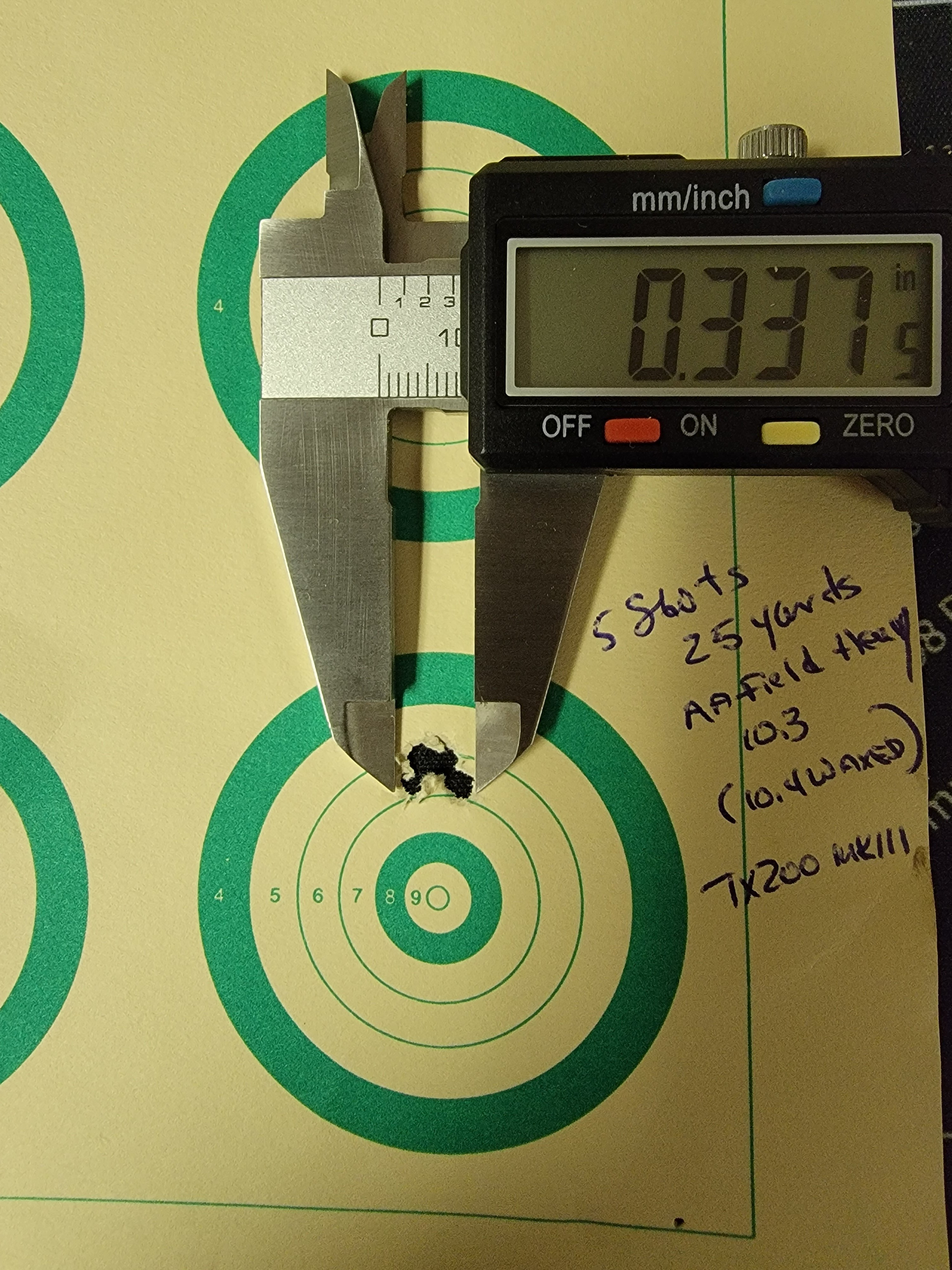

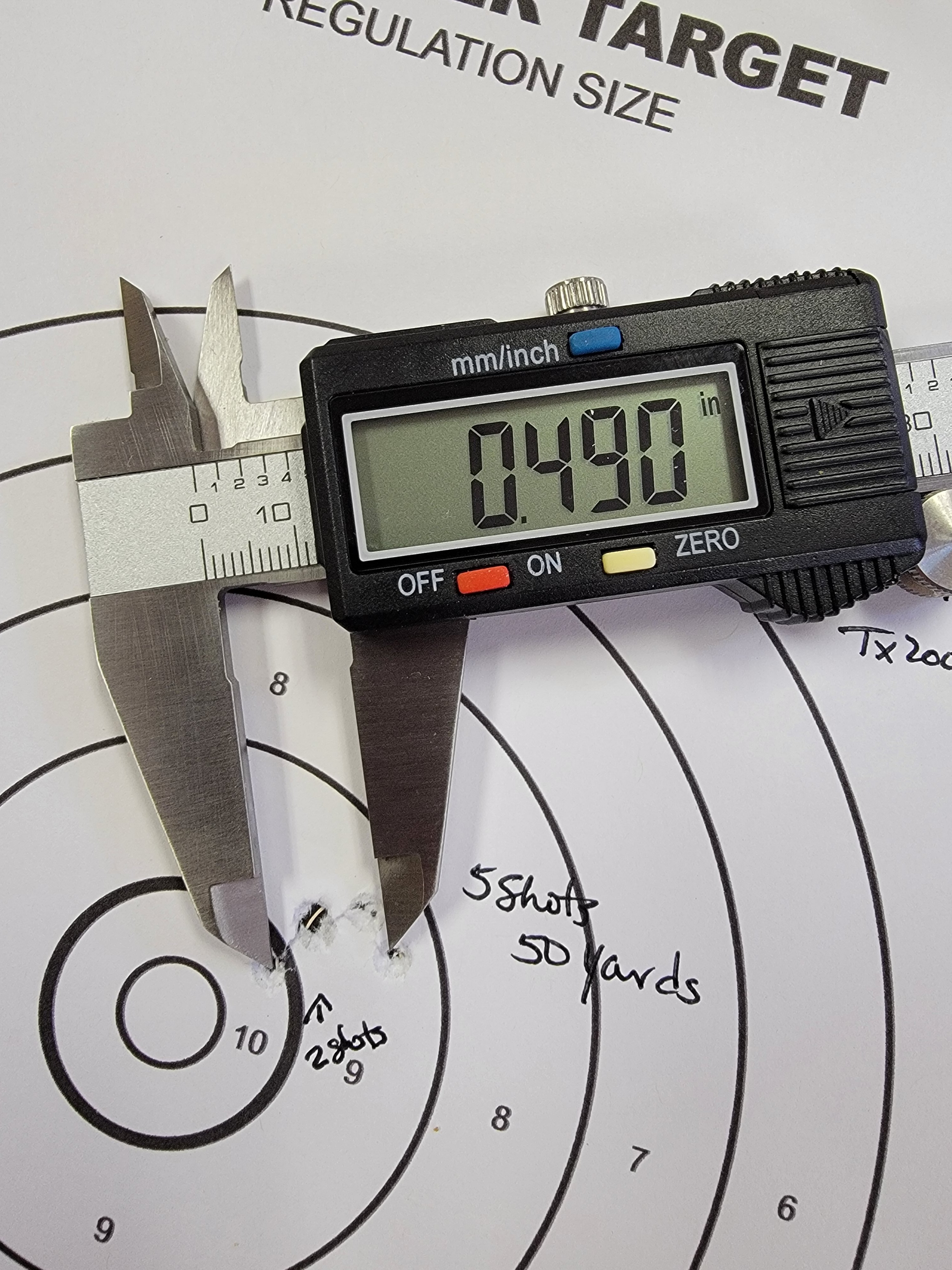

I use Beeswax furniture polish in my TX200 MKIII. I do not know if it is psychological or not but it seems to reduce variation and it tightens things up from about 15 yards out. At 10 meters I don't see a difference.
