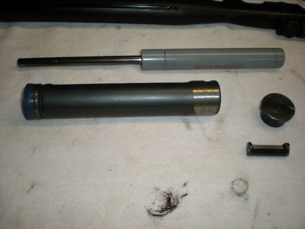

I just got into air rifles less than two years ago. I had no experience or anyone to guide me so I was flying blind. When my Mach1 arrived not knowing any better I dry fired it about 50 times to get a feel for the trigger since it was winter and I had no indoor range yet. After over 20,000 shots I took it apart recently to replace the piston seal which I figured was probably shot by now. I will probably never buy another Gamo, not because of quality but simply because they will not sell parts. But as you can see the inner parts have held up well. Also the new models allow barrels to be removed easily and I was amazed at how tight the barrel pivot and cocking parts still are.
