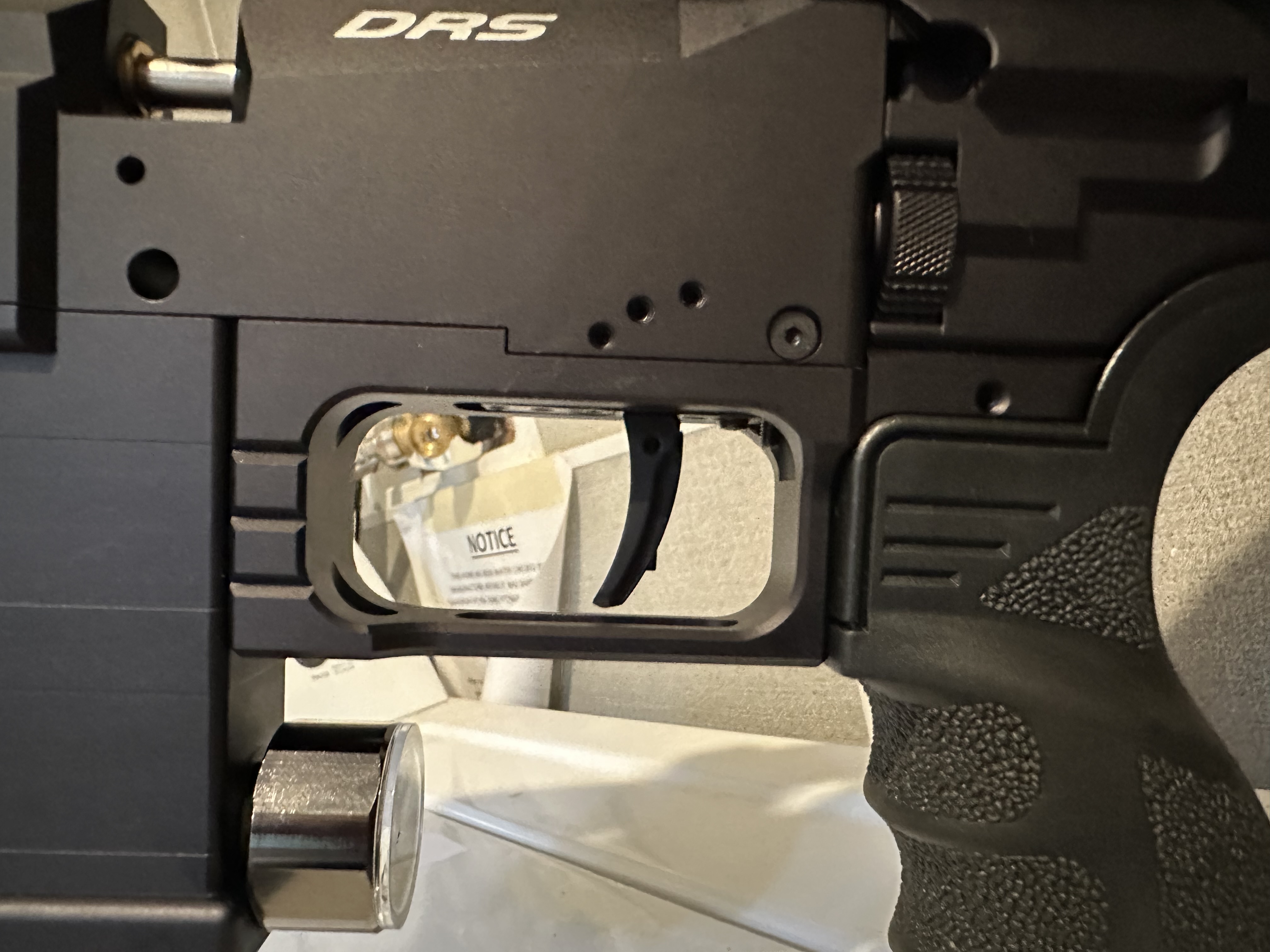

I bought a Nate Chronograph to check my tune on my .25 DRS Tactical. The chronograph had sensor issues so I messed up my tune. I received the replacement chronograph and tried to tune my ar but t couldn’t get above 630fps with regulator screw screwed out as far out as possible and hammer spring to max. I degassed and bottomed out regulator screw plus one full turn. The fps increased when the regulator screw was turned in and reached 925fps bottomed out with max hammer spring. The regulator adjustment is opposite of what I would expect, am I looking at a bad oring on the regulator valve?
