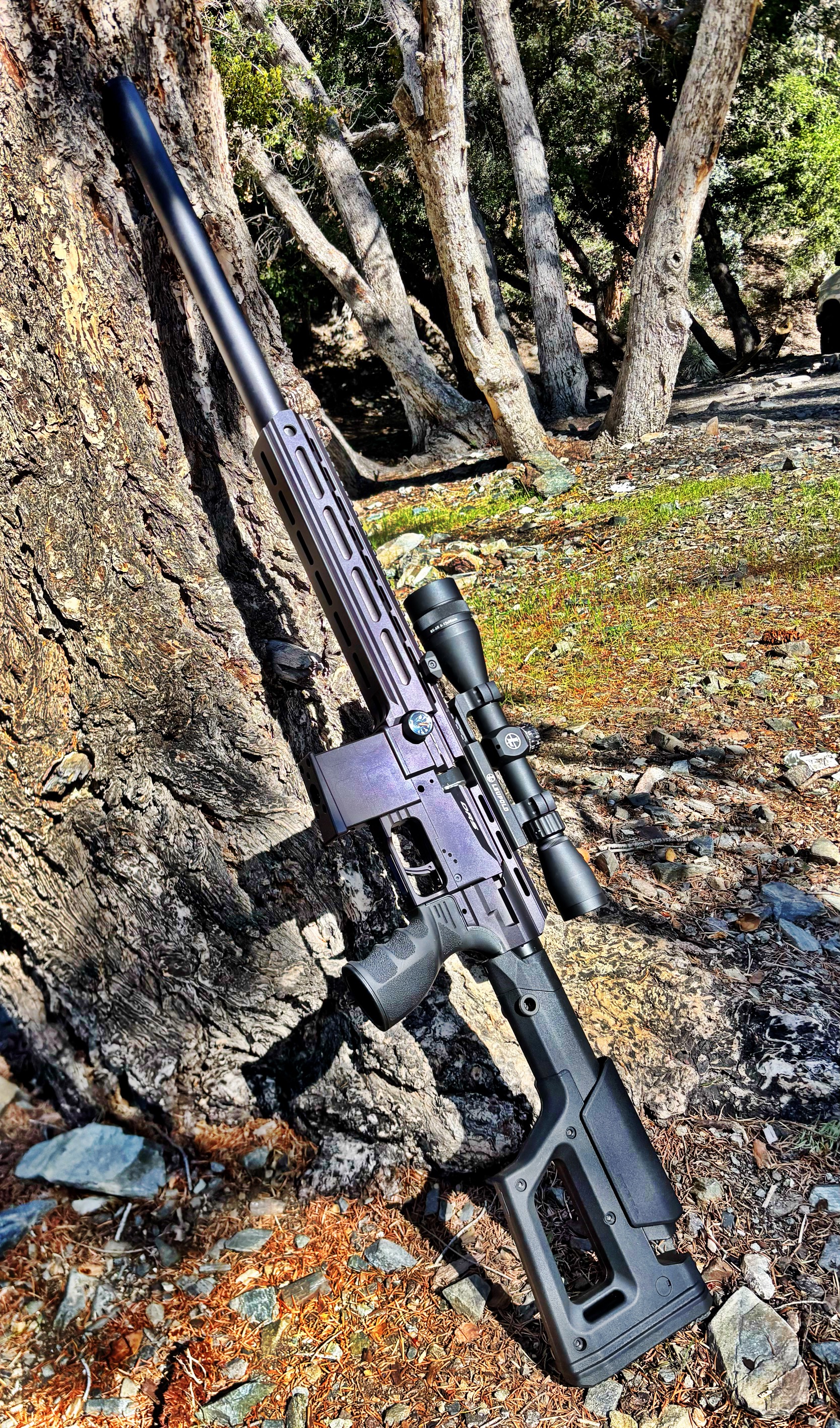

I received the DRS Tactical in .25 with the 600mm barrel yesterday from Utah Airguns and got it out to shoot today. The paperwork from UA said it was tuned to 900fps with JSB Kings. I don’t have a bipod to fit the Arca rail yet, so I shot off my deck railing. This rifle is really accurate; when I could steady my aim, it was putting holes in holes and holes touching holes at 50yds. The trigger is really light and I fired off a couple of shots before I was ready before I got used to it. I got 3 magazines out of it between 225 and 160 bar before refilling; there is an error in the manual that’s says it’s a 250 bar fill, it’s 230. I shot it without a moderator and it was not terribly loud but with the Impulse moderator it was much quieter. Not to knock another gun, but after shooting the DRS my Avenge X will now be gathering dust.
