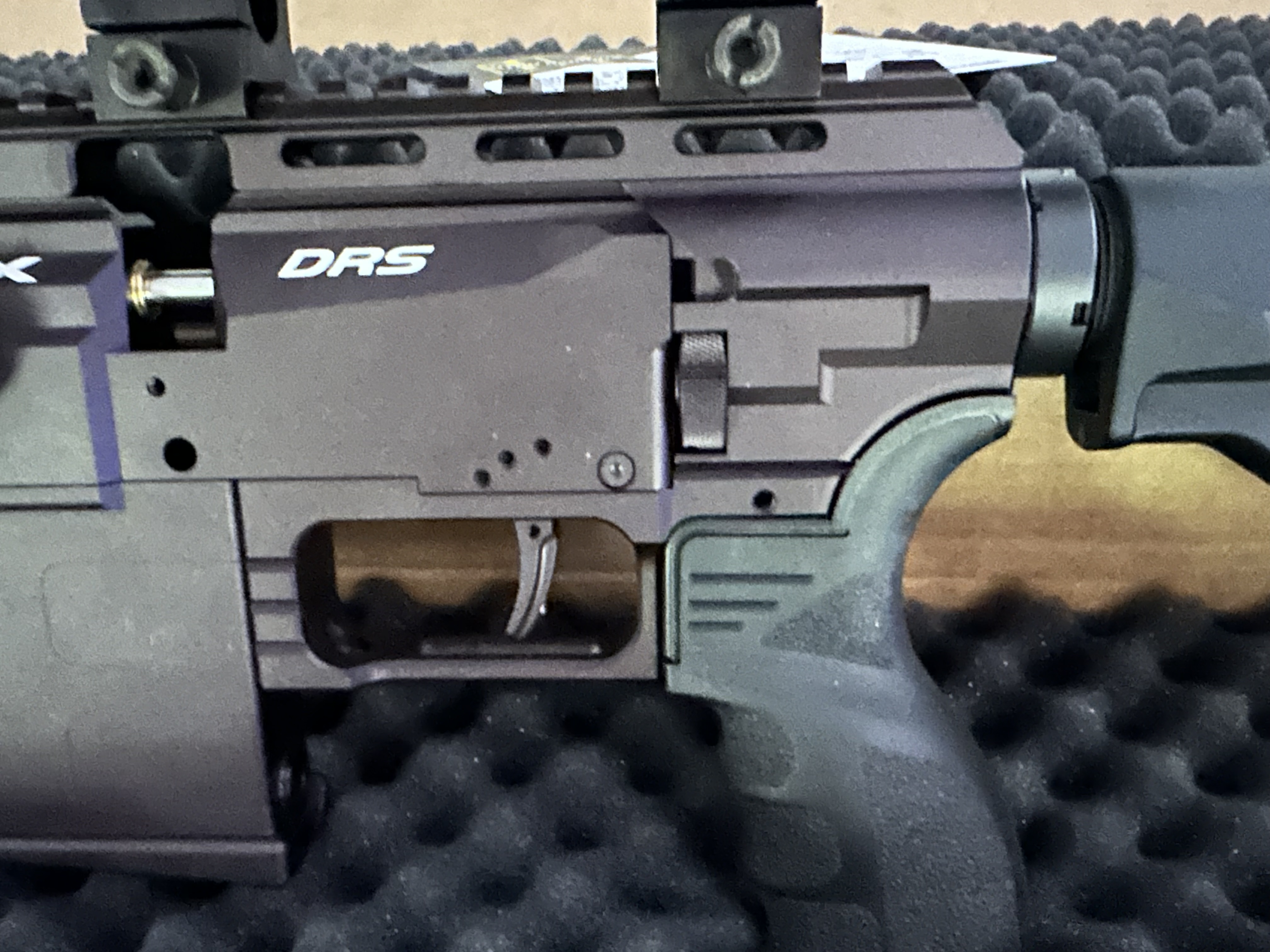

I’ve watched videos on the DRS Tactical and they all say the regulator pressure and hammer spring can only be adjusted by removing the stock and chassis. My DRS has an adjustment wheel on the left side precisely where the hammer spring adjustment is located. I went back and looked at videos that were only a couple of months old and they don’t show the adjustment wheel. I believe FX has upgraded the DRS Tactical and made the hammer spring externally adjustable. Not sure how it works since the manual is for the DRS Classic.
I’ve watched videos on the DRS Tactical and they all say the regulator pressure and hammer spring can only be adjusted by removing the stock and chassis. My DRS has an adjustment wheel on the left side precisely where the hammer spring adjustment is located. I went back and looked at videos that were only a couple of months old and they don’t show the adjustment wheel. I believe FX has upgraded the DRS Tactical and made the hammer spring externally adjustable. Not sure how it works since the manual is for the DRS Classic.View attachment 564522

I wish they would at least include a manual that includes this model. My hammer spring will probably remain untouched since it comes tuned and accurate with the JSB Kings.
You can use the hammer adjuster to tweak your velocities as the temperature and humidity change. A worthwhile addition. The hammer adjuster on the later DRS's has a spring and ball detent that gives 15 positions (clicks) per complete revolution. That means about 0.067mm of hammer spring compression difference per click. Turning the wheel clockwise increases compression, anticlockwise reduced compression. That amount of spring change is very close to what you get with each click on the Quick-Tune Micro adjuster on the Impacts, Panthera's, and the new Leopard.
