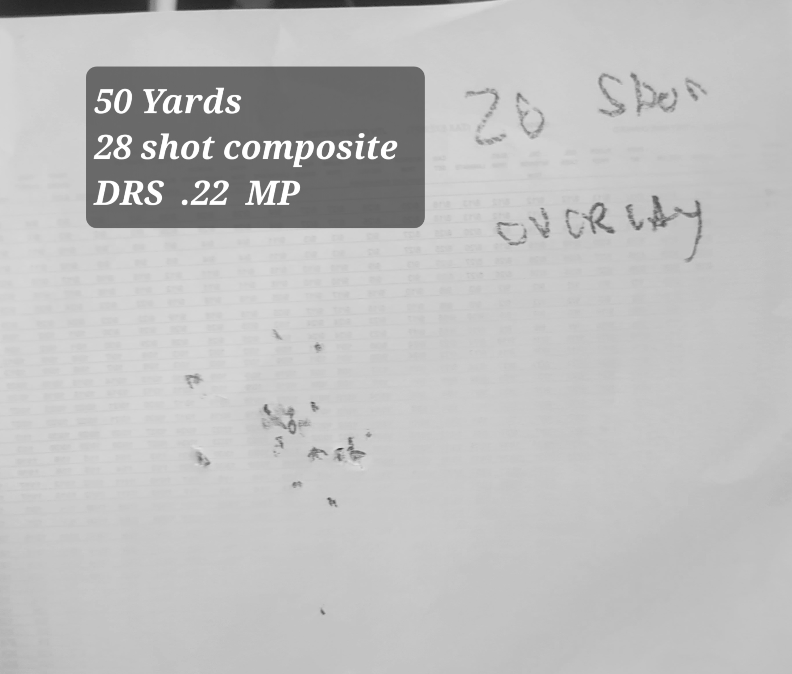

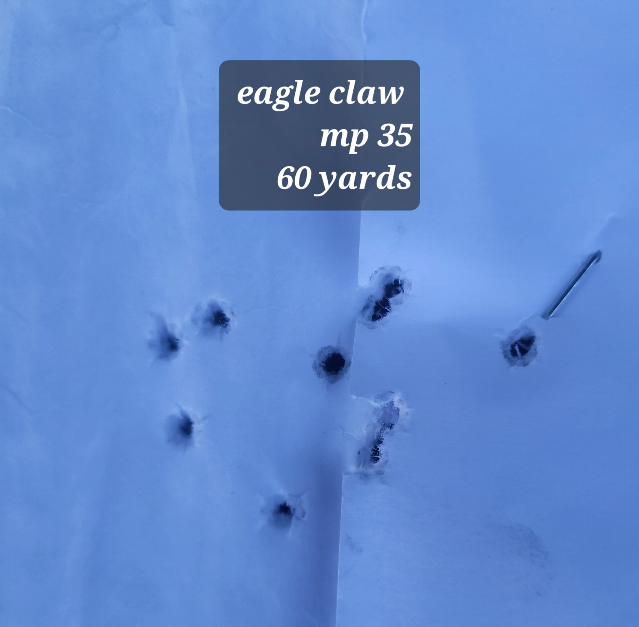

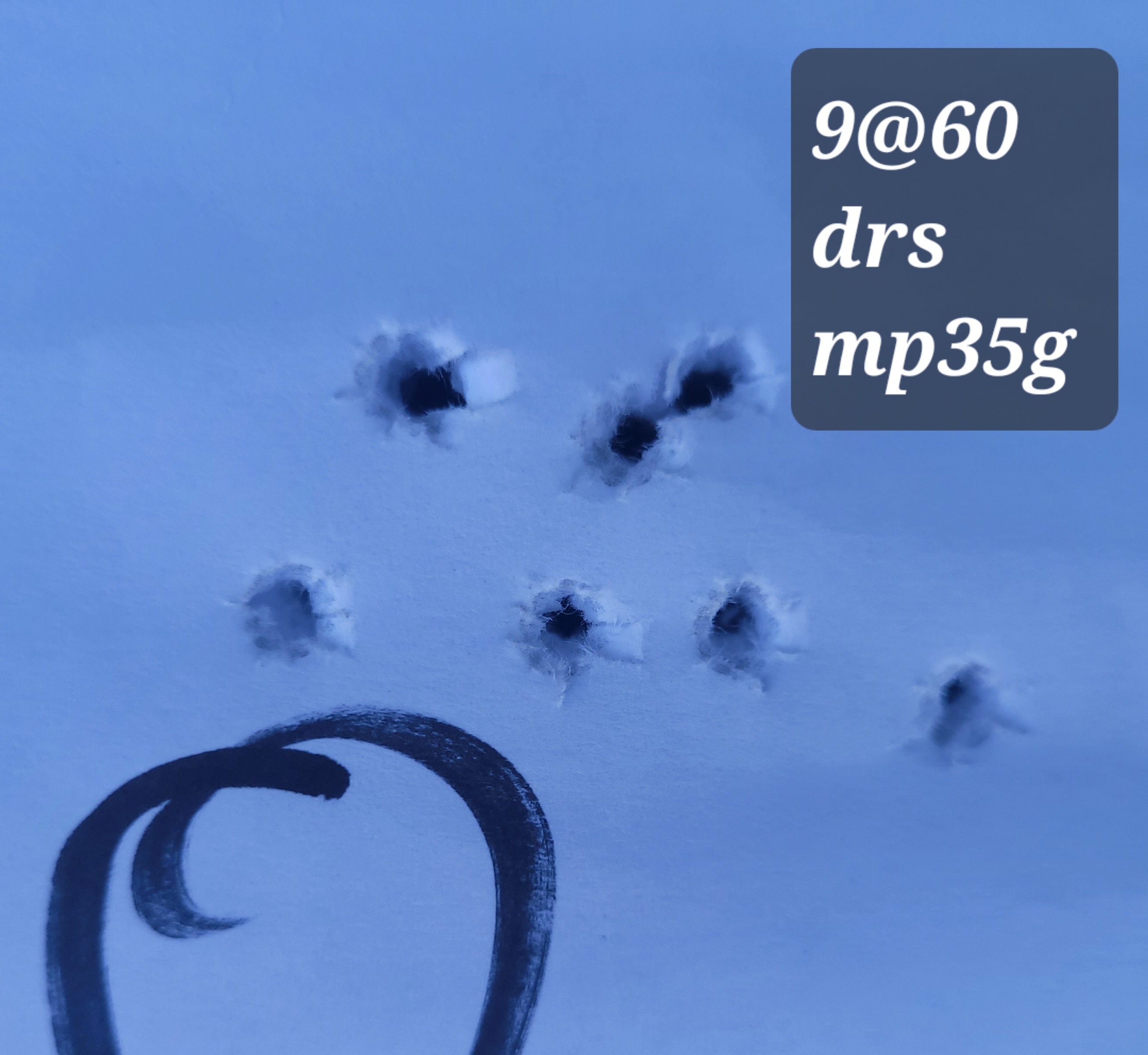

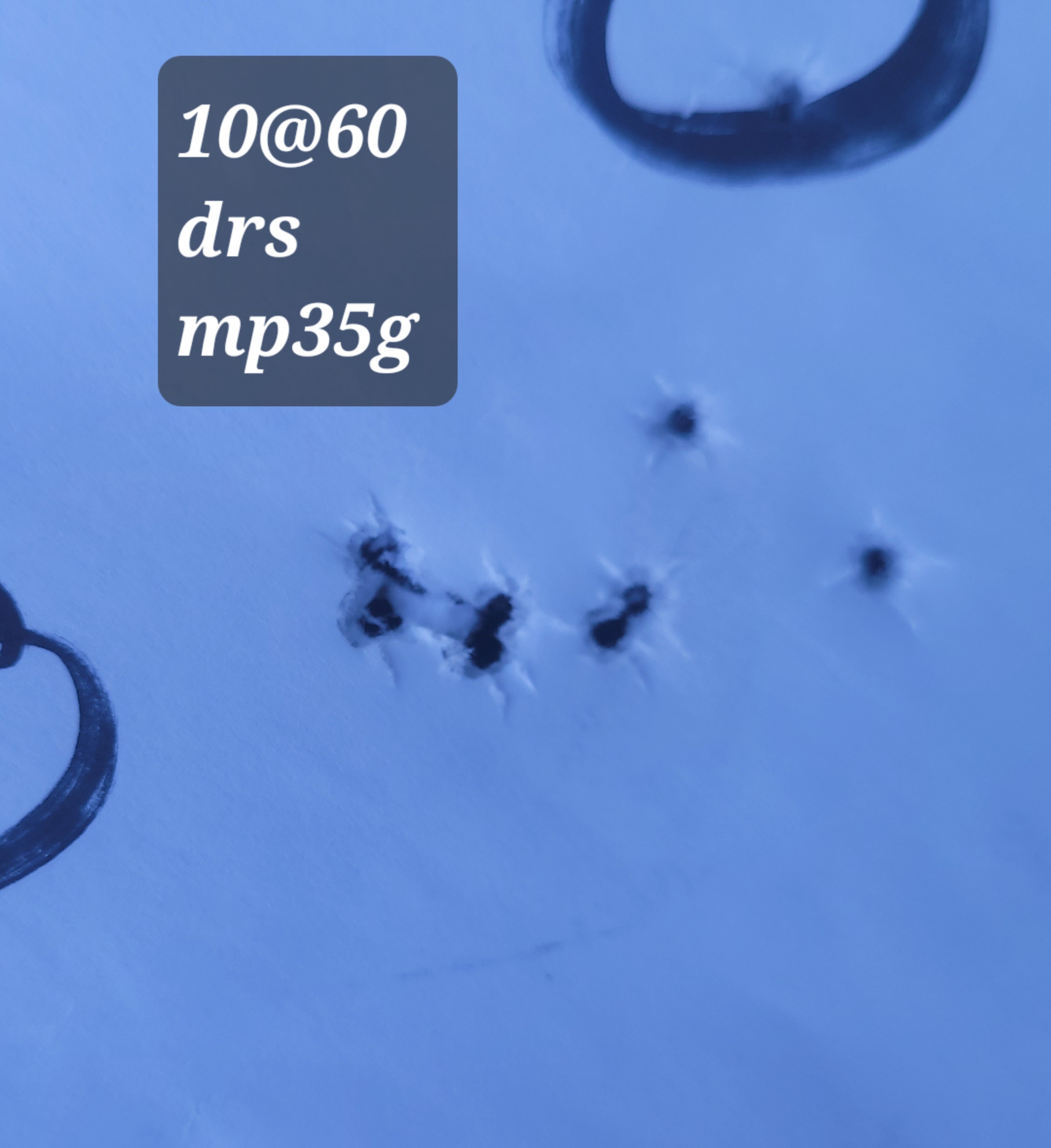

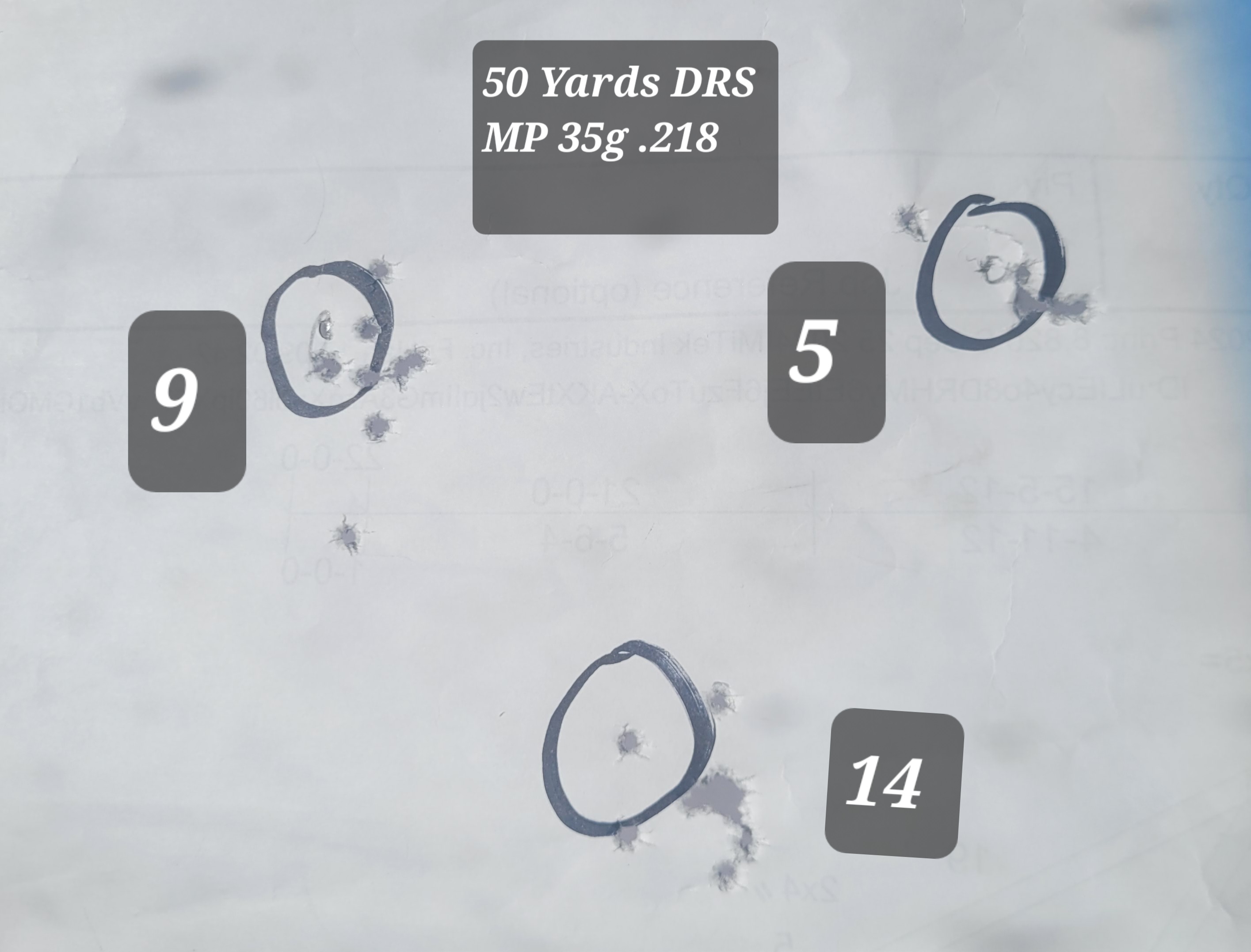

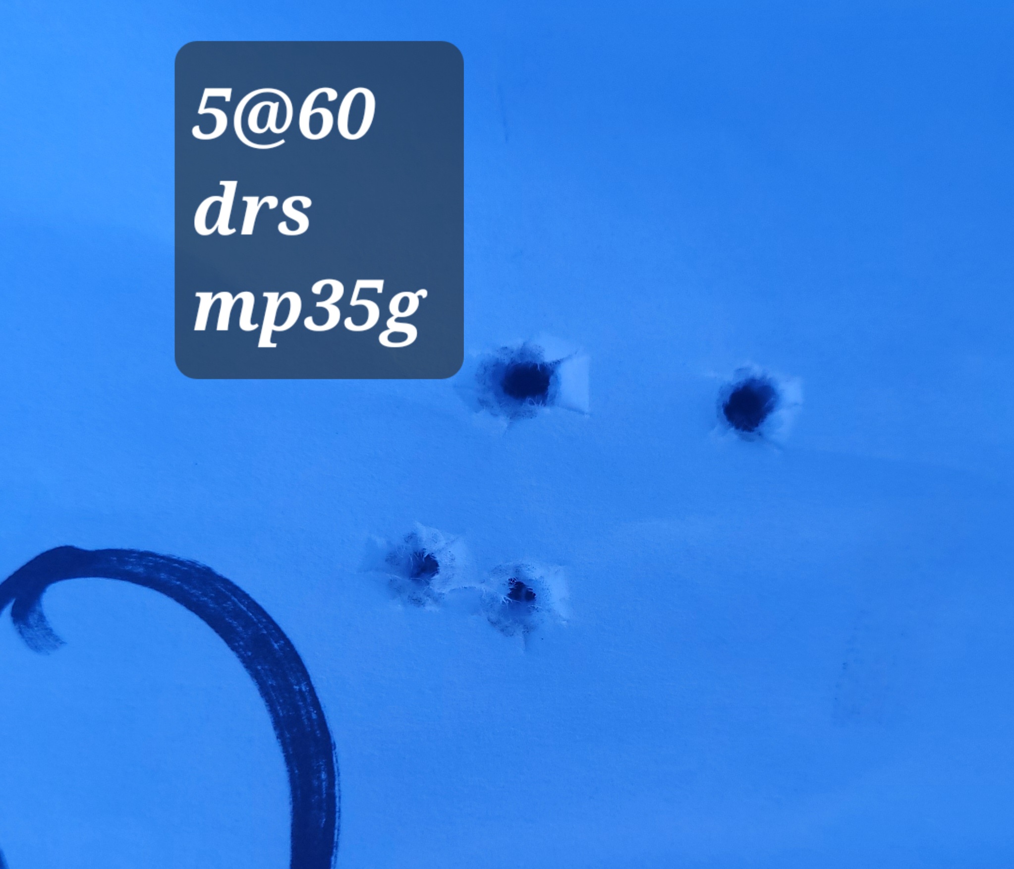

I can't get a day without horrible wind, but that's Eastern Washington this time of year. I cast some better quality bullets(oh sorry" slugs") and at 60 yards it improved a bit.Reg set at 150 Bar and I've yet to chronograph them or play with the hammer spring .
I shot 10 out of the Eagle Claw and I was surprised it shot them at all..
