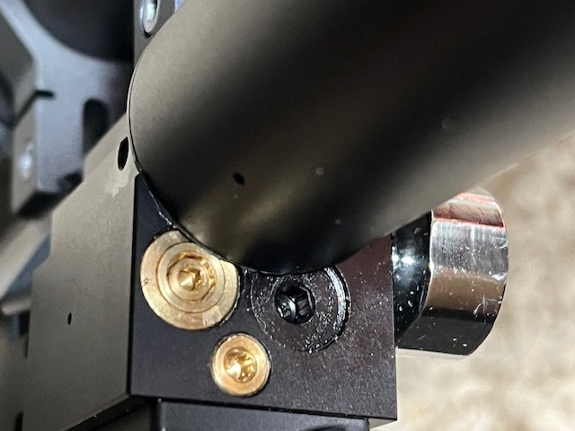

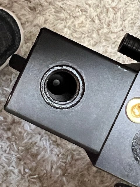

I did find a plug in the front of the plenum that had a 5mm hex drive , and after reviewing the manual in a pdf i found on the web it did show a gauge installed on the front of the plenum.
So here we go, degas the gun9 Unscrew the pressure gauge to do so) fired a shot or two after the pressure gauge read zero to clear the plenum. Unscrewed the plug from the front of the plenum and installed a spare gauge I had laying around.

1) The threads on the gauge needed are 1/8BSPP

For future reference, the small brass set screw on the lower center location of the block is the degassing port. It will degas the air cylinder and plenum, so no need to mess with loosening the gauge or dry firing to empty the plenum. I find this a nice feature!
I also found I needed to use a bonding washer to get a good seal in the gauge when attaching it to the plenum. There is no ledge or sill inside the hole, so you can't use a deleon gasket or o-ring.
The thread on that port is 1/8BSPP. I really wish they would have put that port on the side or the bottom instead of the front, where it is very difficult to see while tuning.

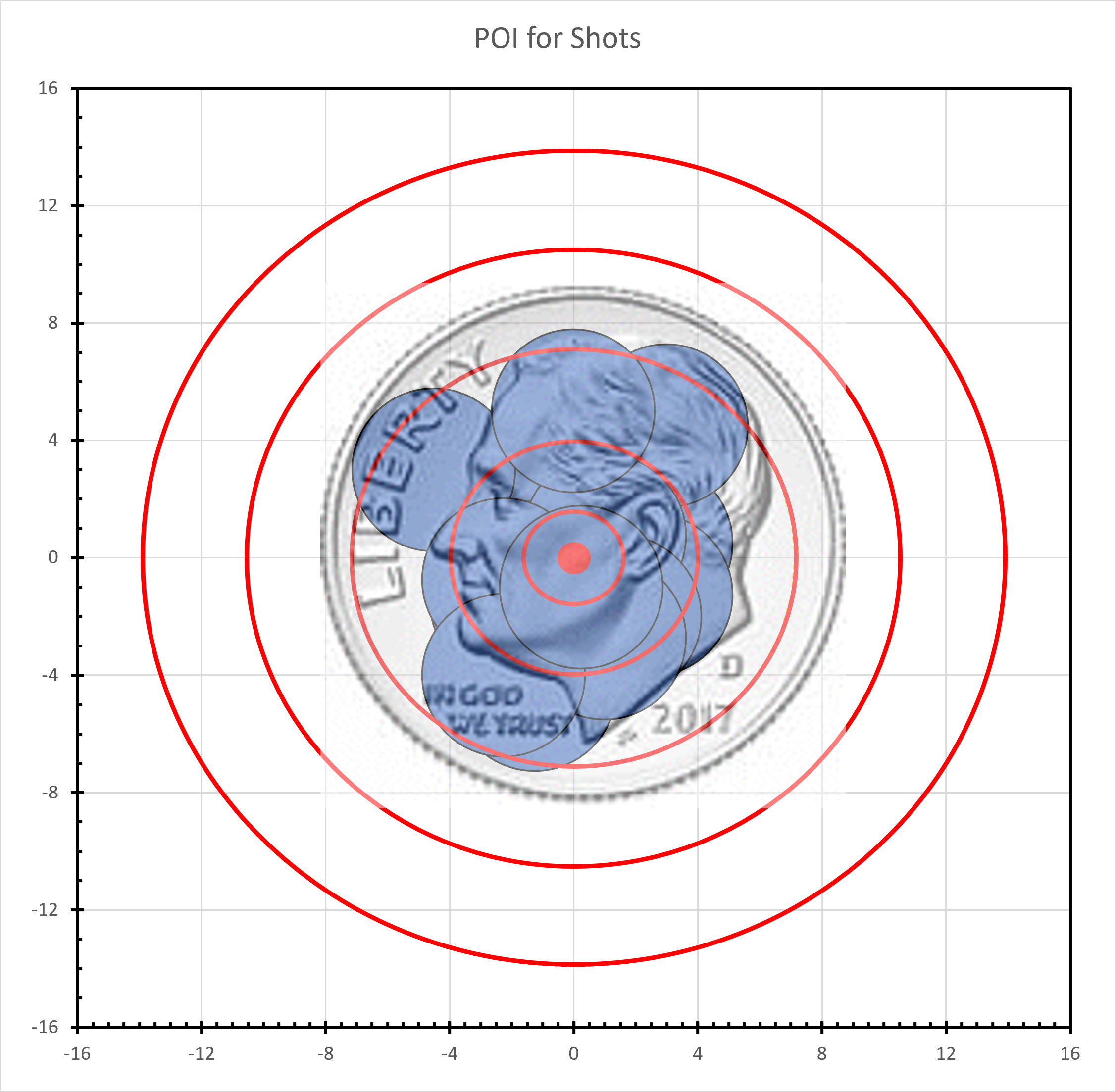

This is a very good score, but not a great score as there have been a bunch of 200 cards shot by folks in this Challenge. But to give you an idea of what this might mean for FT, I measure each shot and plotted them on a graph to show a 20-shot group. (The scales are in millimeters).
I think 20 shots under a dime at 30yds is probably good for FT. I will be shooting some 40 yd targets when the wind stops howling and then move on to the 10.3s .
