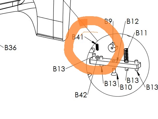

Installed the dreampup stock kit and noticed that I have to take up all he first stage slack or the triggers first stage is all slop. I looked in the package and the instructions for a second spring but none exist in either. Am I missing something? There are two screws that adjust the take -up on 1st stage but nothing to keep the ( L ) link from moving back and forth. Seems like a spring should be butted up against it somewhere to give a little tension on that initial stage.
EDIT. There is supposed to be another spring that I guess they forgot in the kit. On F10058 drawing it's part number B41, Looks small.

no spring its a touchy trigger, once you get to what you like its fantastic
I already posted that there is a missing spring.. Looks like it's a tiny one.. . ( .2mm CS x 2.2mm ID x 5mm long ) I ordered one from mcmaster that's close. On dreampup schematic F10058 drawing, it's part number B41
