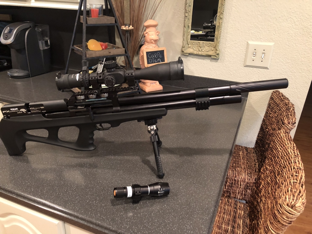

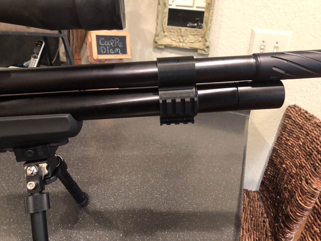

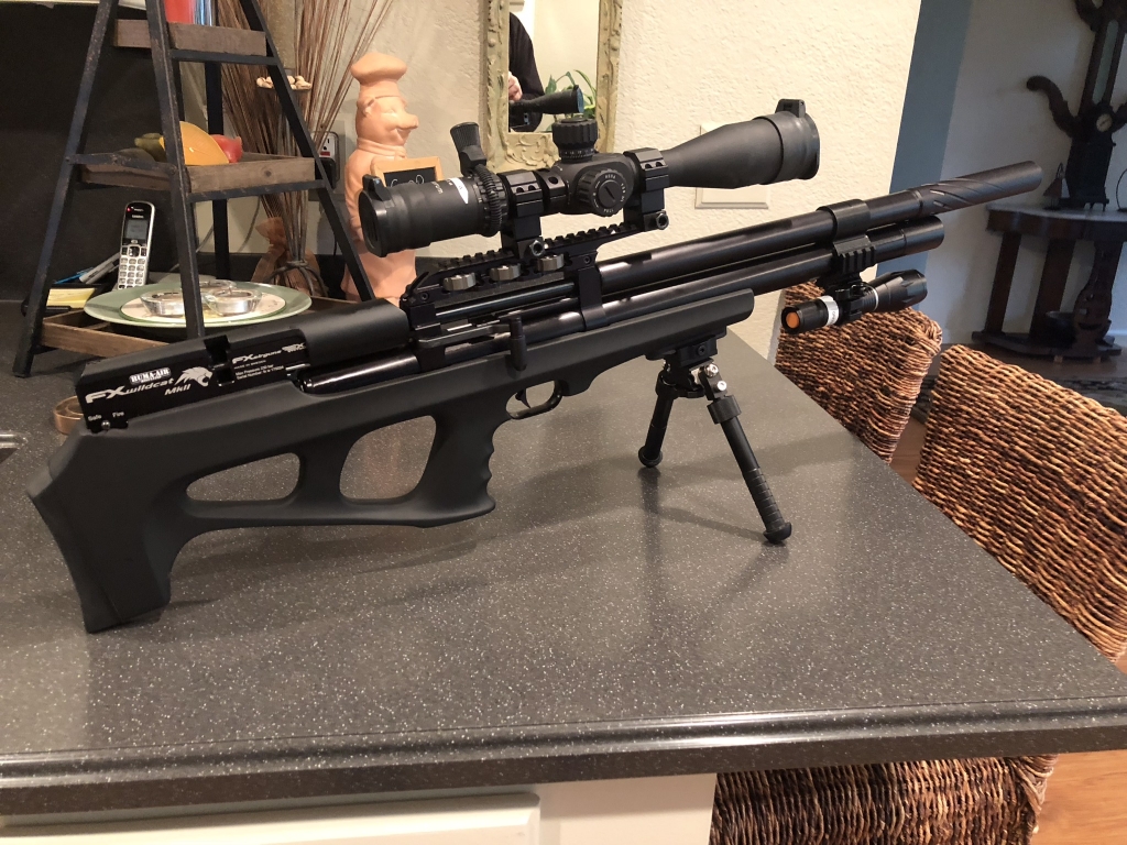

To rule out the floppy barrel worries, get yourself one of these from Stuart Waudby of SMW Engineering. He originally made these for the streamline and Dreamliner guns, but I gave him a shout to add this to his line up for the wildcats.
He sent me me an email letting me know his eBay business is temporarily shut down, but you can order from his website out of the UK. It’s made a difference in both my two wildcats along with a buddies 30 cal wildcat. His Shogun on the end of his 700mm barrel showed big time signs of clipping, and after I put one of these on, no more clipping and all 7 shots into a 1/2” dot at 40 yards.
