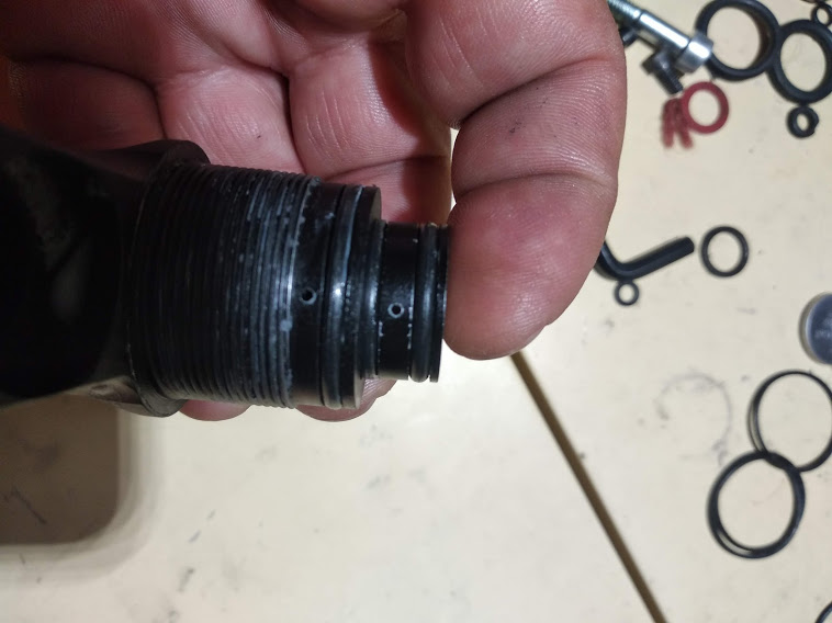

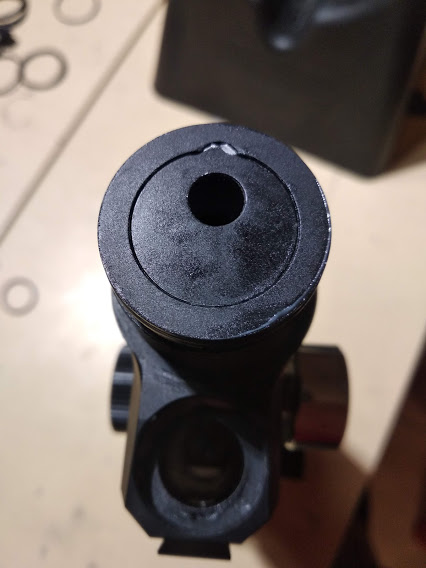

The gun leaks from the 2.5X1.5 oring where the valve sit

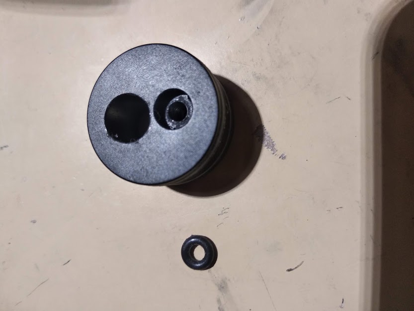

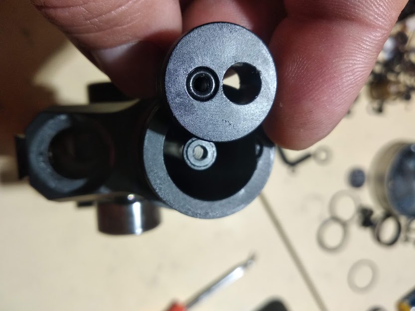

My question is the two holes at the valve cup and the valve block what suppose to be ?
The air comes from out of these halls to the threads of the block
The two holes are supposed to be there, it seems most likely one of the o-rings on the valve stop is leaking, or it is possible for the 23x2.5 nbr 70 Oring past the threads are leaking too. The first o rings should be 11.91x2.62 NBR70
