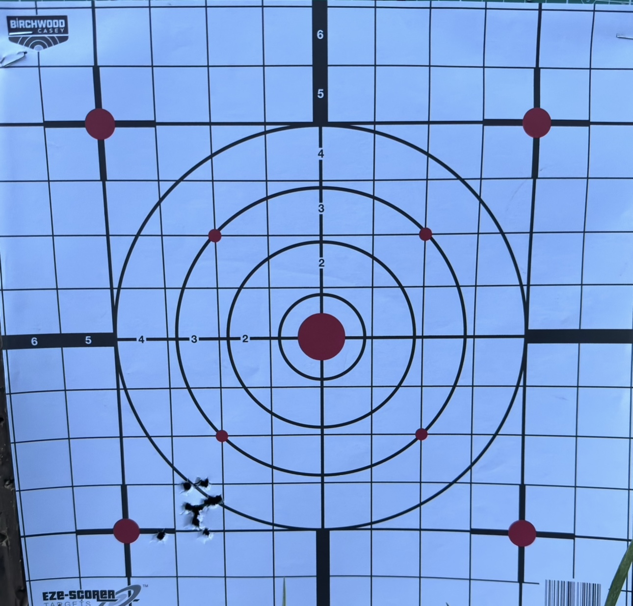

Someone asked for groups. I haven’t forgotten, just been busy. She prints good enough for me. JSB Kings 25.4 grain. It shoots tighter on wheel setting 4 at around 845fps but I’m good with these results. I strive for higher levels of accuracy out of my Impact MKII but for starlings and woodchucks this works just fine. The hades shoot good too.
Those are 1” squares at 70 yards. Prone with a bipod, holding not dialed and no rear bag. I also just shot this group, it’s getting dark around here and the center dot on the Athlon Helos is twice the size of the small dot I was aiming for up and to the right.
