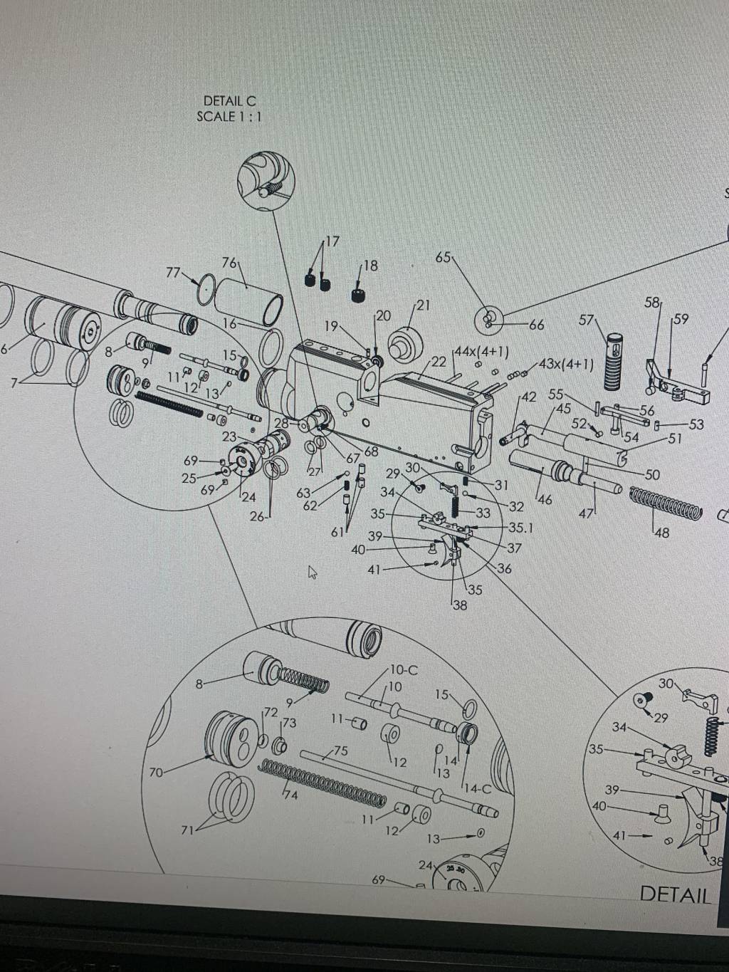

Thank you for the reply. I couldn’t find any crack during inspection. But it still might an invisible one. I placed a order on a new valve seat and pin from Bagnall and kirkwood. Was just thinking if you guys might knew if other things could cause this leak
If you cant figure it out today I would call the techs at FX USA.. I think you can find their number on Google.. but they have sat down with me (persay) and gone through my gun to help me figure out what was going on with my gun. Idk where you are but if you still cant figure it out Ken Hicks seems to be the go to man from the reviews I have seen
Reactions: monstr2
My Dreamline did the same thing. FX tech told me to check if the valve holder was loose. When you remove the air tube, it’s the brass cap inside where the air tube screws in. Mine was loose, tightened it with hex and leak fixed. FX tech said they sometimes vibrate loose. He recommended a drop of non-permanent loc-tote. I didn’t do that. Hope that helps!
Hummer57 Thank you . Where can i find the valve holder?
