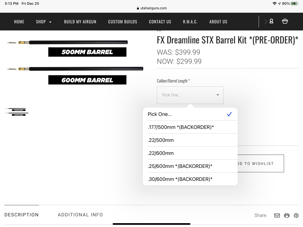

https://utahairguns.com/fx-dreamline-stx-barrel-kit-pre-order/
when the kit you want is available it will be $399, unless it is on sale
