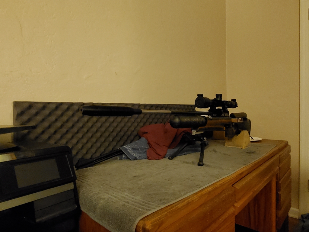

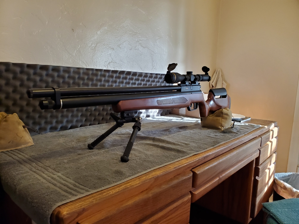

mrod with picatinny rail with a cal atlas bipod with clamp for quick release, it fits other guns as well
If you are just shooting from a bench then a sling stud is the easiest way to go. If you are going to use the bipod on different rifles then a Picatinny rail is great for quick detach (QD). I bought a Caldwell just recently for $40 and its not too bad but it is not a Harris. Harris is great! I will say the Altas looks to be really nice with the legs that pivot forward for a lot of adjustment for elevation changes, but $300 / ouch.
I have the Atlas and like it. Would like to have the Accu tac H-5.
