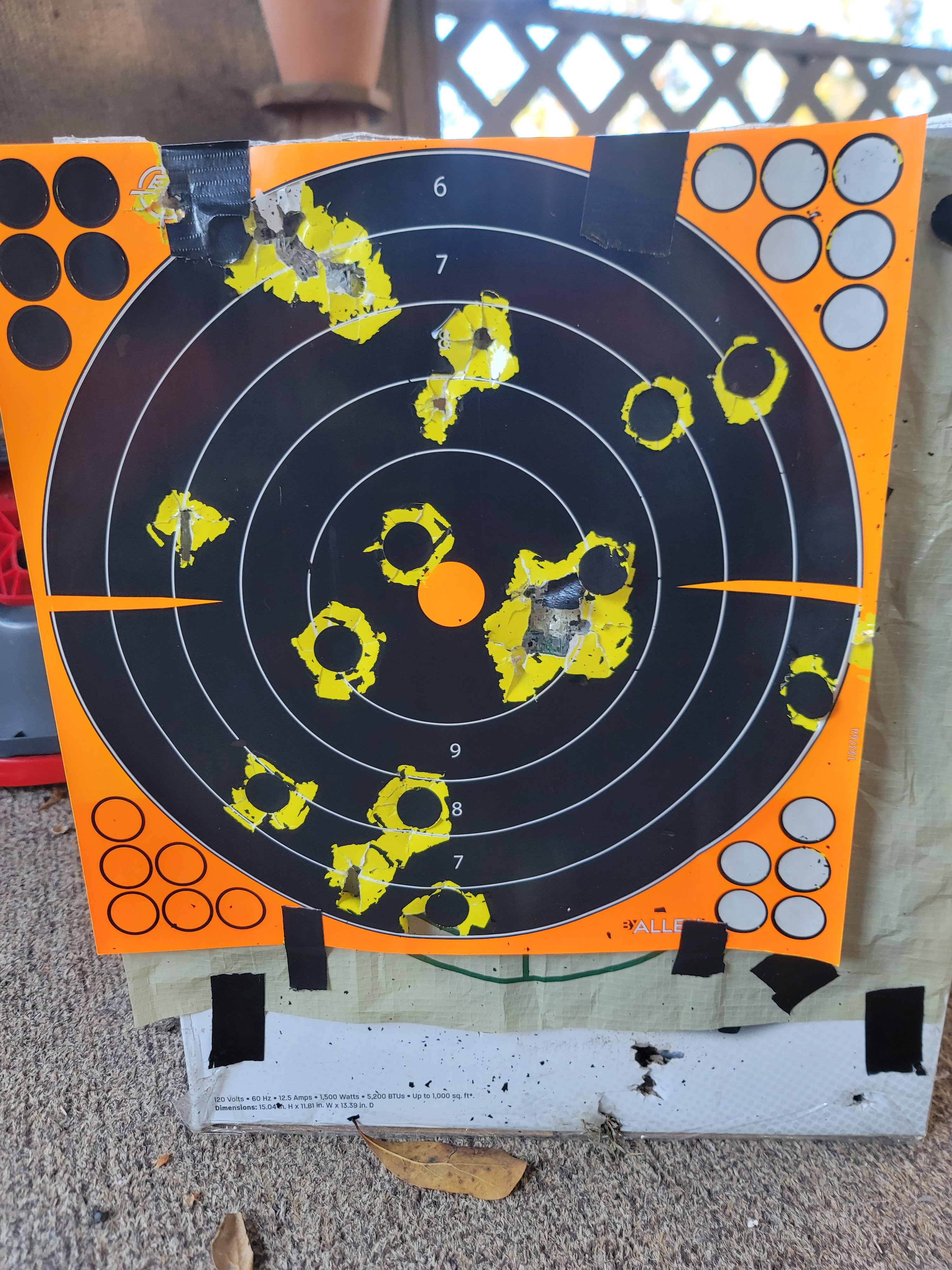

I am having trouble with my Dragonclaw II. I cannot seem to get it to shoot straight. I can always hit the target but never get it zeroed in. I have tried with Seneca round balls, hollow point, flat nose, and even the 330 grain flat nose slug! I have shot boxes of ammo trying my best. I always shoot my shot with the pressure the same for 4 shot groups. I'm just not having any luck. Any advice would be greatly appreciated!
Do you have a chrony to measure your FPS? Have ANY projectiles worked consistently accurate in the gun before? Not a lot of information from you to base an idea of how to help. Don't understand "I can always hit the target but never get it zeroed in". Do you mean hit the bullseye or just hit paper? Original owner or bought used? SO MANY questions!
I do not have a chrony to measure FPS. I have had the best results with the round balls. I can always hit the 12" target somewhere on the paper but never consistently. It will hit the same spot randomly on the paper sometimes!! I bought the gun new 2 months ago. I Am new to airgunning and really appreciate any advice received. I can answer any other questions you may have if you just let me what you need.
This was today with the flat
Balle Blondeau Flat Head .50 Cal, 210 gr.​
