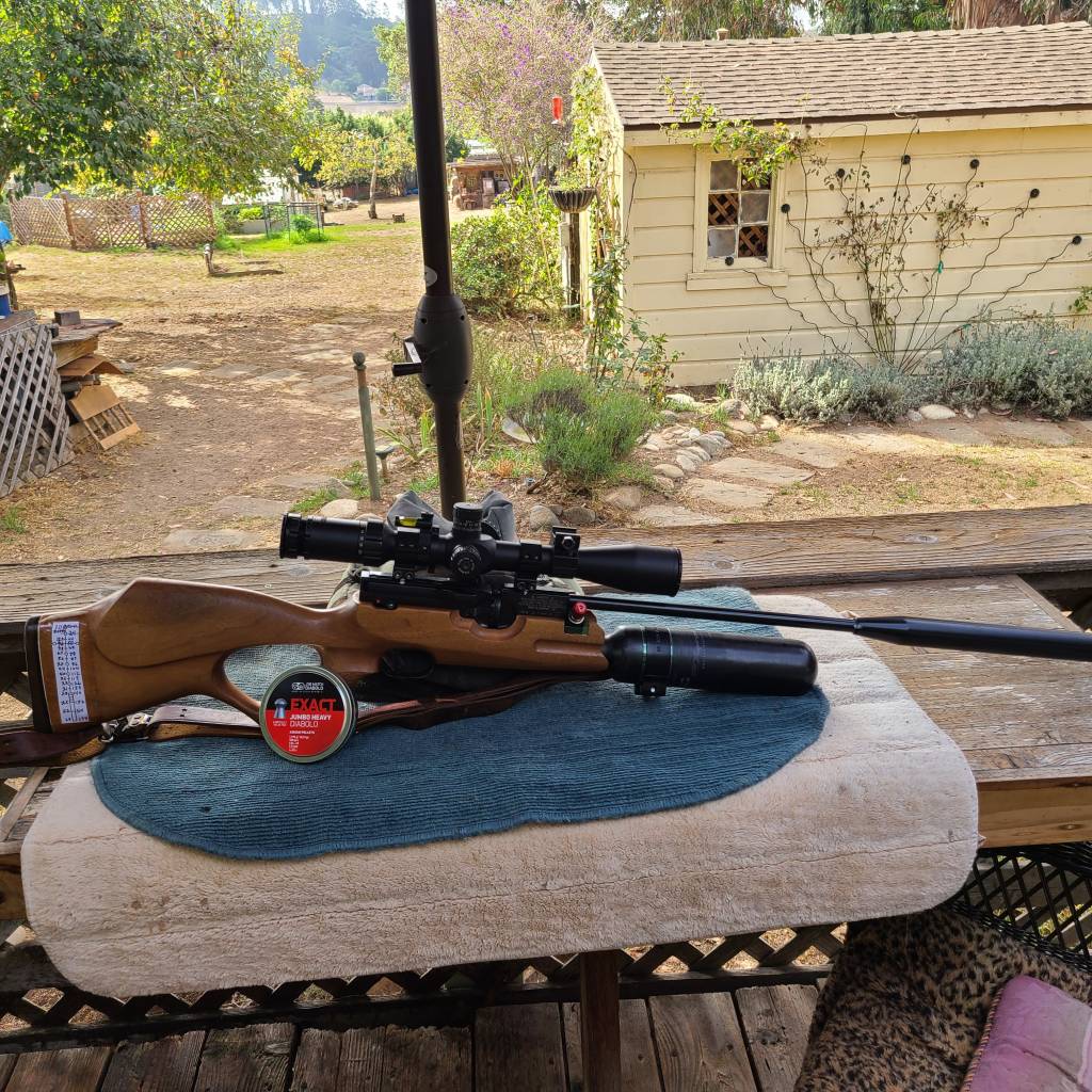

Here's the finished product. The major thing is when you chop the stock is now you are taking away the linear support of the action in the stock due to the lack of the oring air vessel/ barrel support in the fore stock. Alignment of the action/stock screw must be done very carefully.
During non-pesting season , I'm planning on attaching a wooden under forestock to put upward pressure on the bottle, thus aligning the action better. But for now it works fine.
The bottle is a Fx 480 ci carbon fiber bottle, with a fill of 3600 psi.
My HW100 has a FX smooth twist barrel, AZ tuned with a custom moderator. Extremely quiet. Regulator set at 140 bar allows me 75 shots at 33ftlbs. 18.1 gr. Pellet at between 870 to 875 fps. With the FX .22 gr. hybrid slugs I'm getting 820fps. I have to move my elevation know on my scope 10 clicks up for zero. Windage remains the same. The slugs really smack. I've tried others but these slugs seem to provide the best accuacy.
