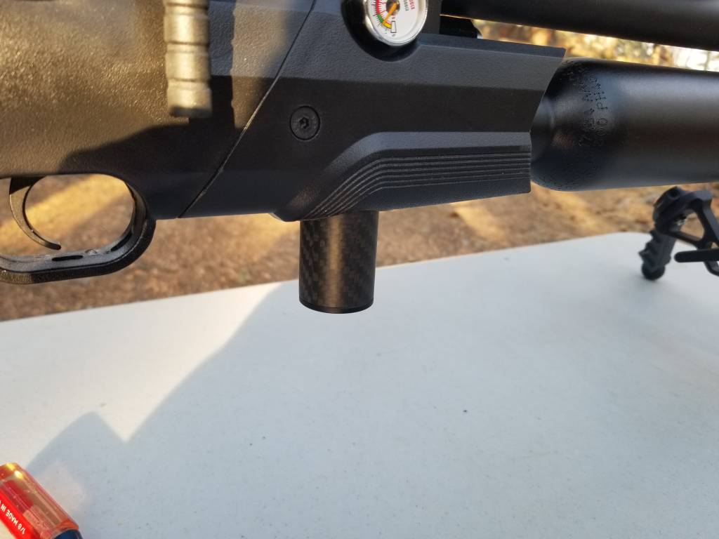

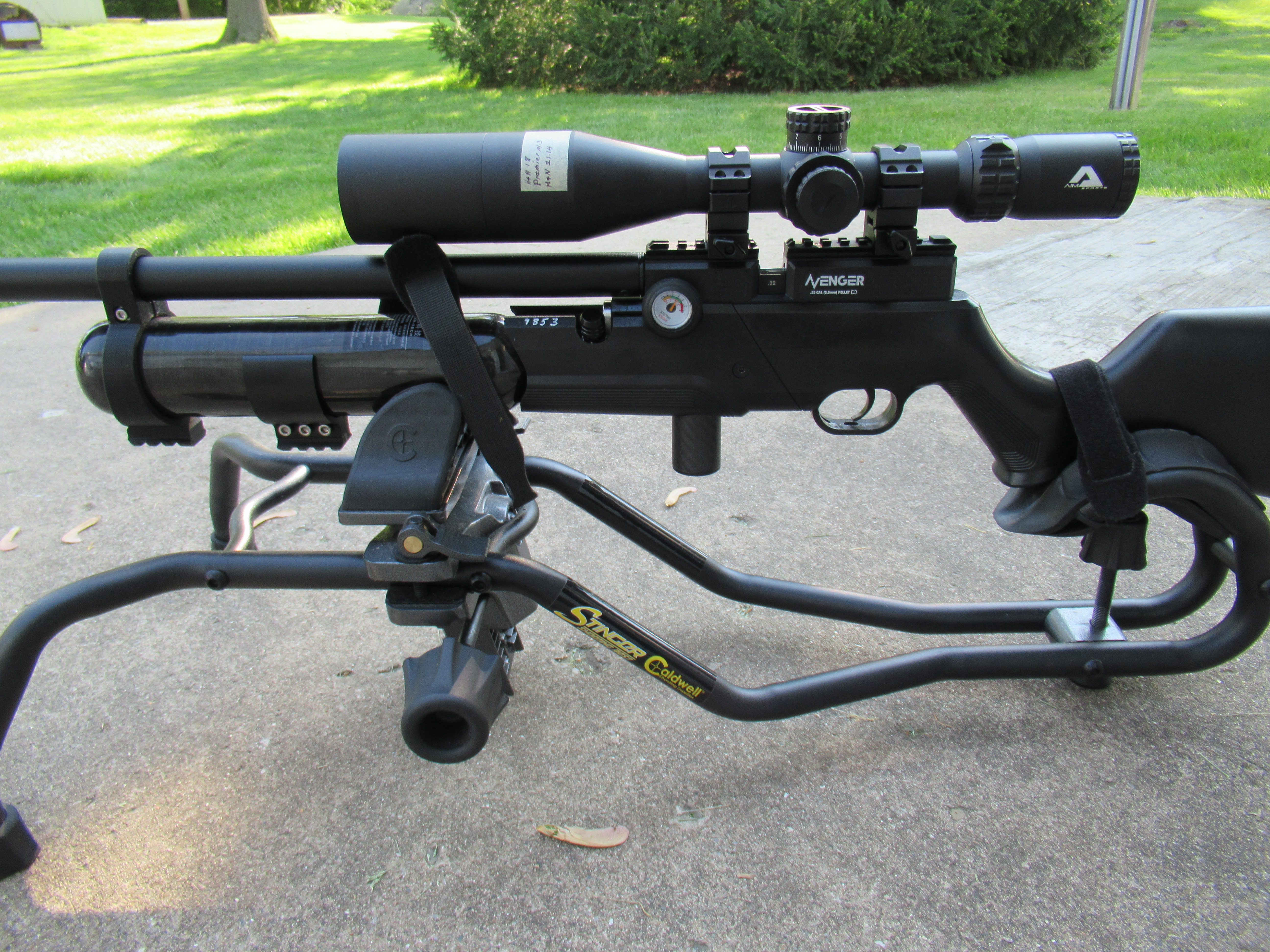

Well I finally decided to add a power plenum to my Avenger so I made one today at the shop. I'm not sure on the volume of it but it works good. I have the regulator set at 2800psi and the hammer is tensioned about halfway and I'm getting 825fps with 40grain slugs and 955fps with 27 grain pellets. Not bad for a .25 caliber but I hate the way these look with a plenum. It's just goofy looking to me. And im fully aware that my welds have some low spots but I machined a deep groove in both pieces before tig welding it so it has good weld penetration.
Well I finally decided to add a power plenum to my Avenger so I made one today at the shop. I'm not sure on the volume of it but it works good. I have the regulator set at 2800psi and the hammer is tensioned about halfway and I'm getting 825fps with 40grain slugs and 955fps with 27 grain pellets. Not bad for a .25 caliber but I hate the way these look with a plenum. It's just goofy looking to me. And im fully aware that my welds have some low spots but I machined a deep groove in both pieces before tig welding it so it has good weld penetration.View attachment 411824
Nice work!
The guy that built mine put a small piece of carbon fiber over it to neaten it up.
Reactions: TheBeardedGunsmith

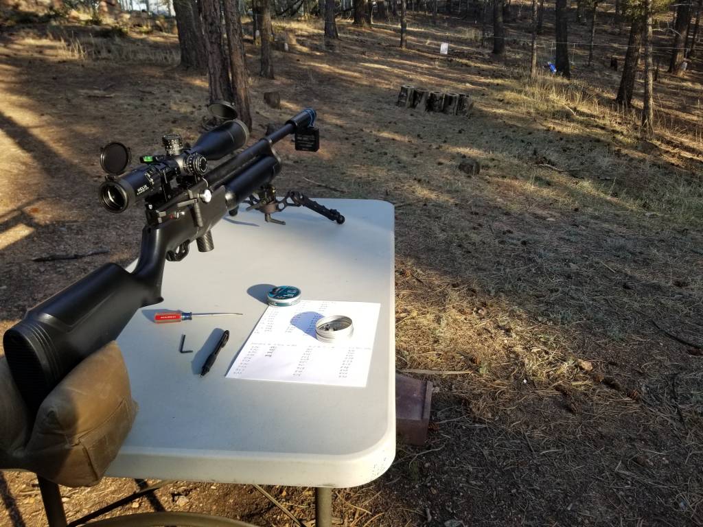

Anyone know why a .22 Avenger would not be able to push a 25.39 JSB more than 800 fps with a 20CC external plenum? I could do 930 fps with a 18.13 JSB with the Doux 11 cc at 2.2k reg and 3.5HS and thought the 20cc would let me shoot the 25.39 just as fast.
Tried all regulator settings like 2.2 to 2.6k for the 20cc all at max HS and highest I got was 800 fps.

Yeah I just shot a bunch of the FX 5.52mm 25.39 gr this weekend. With the 20cc plenum and the heavy hammer spring installed , at 2.6k psi and 3 HS I was able to get 50 fpe (940s)
The spring from ebay is very strong. At 2.1k psi and HS backed out, it shot 840 fps which was max fps I got with the stock spring all the way in at same reg psi for 25.39gr.
At the 2.6k psi it also made my Avenger loud so I'm trying to see if I can get good fps #'s from lower reg psi but higher HS and find the ~97% knee.
The 25.39 is very heavy for .22. I think that's why it needs more fps to shoot well, besides i think JSB version is 5.5 where the FX is 5.52mm. I did not shoot paper but at spinners at 75 yards. I'll have to hit paper when I figure out what reg and HS settings I end up with to see if I can get these shooting as well as the 18.13gr I had used all up til now.
Accuracy is everything so if the 25.39 really don't work out (quiet it down w/tune) then I'll pull the 21.14 H&N out to test those. They're very good quality I just like JSB / FX because I buy from Trenier who unfortunately doesn't have H&N.

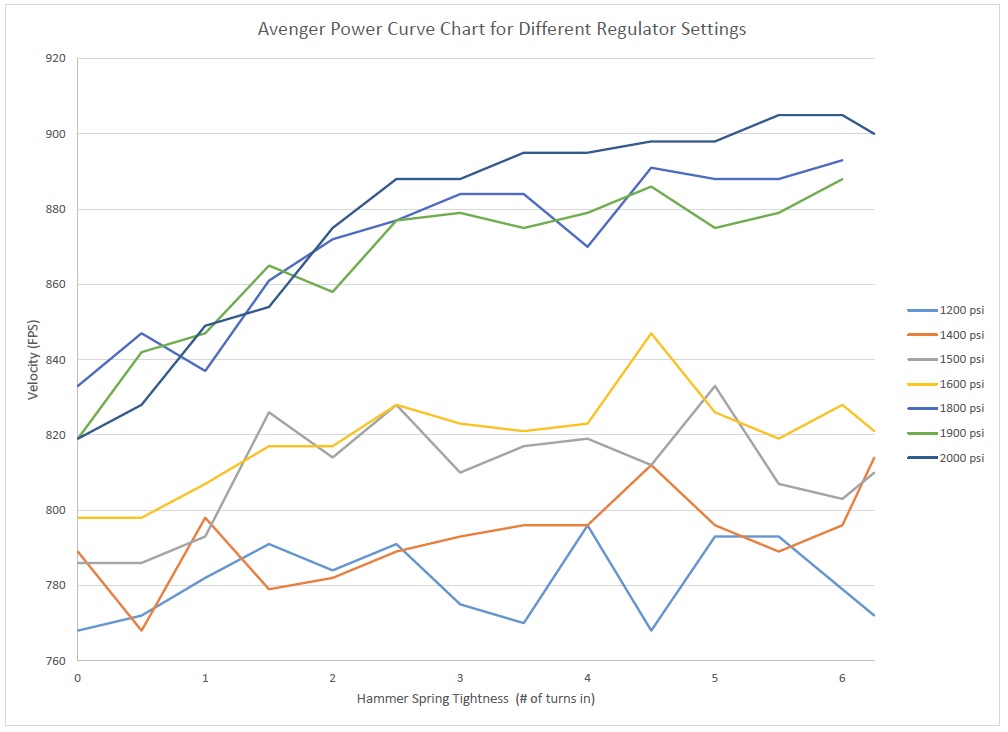

I am shooting these
And yes this spring is a huge difference. It is very strong and was nice it came in red powder coat and I got the light valve spring too but didn't install that.
It gets good #'s and speed just is so loud at that power. I've tried going again starting lower reg and seeing if that's it but the spring is so powerful you need to be in the 2.4k range for it to start balancing. It had a trend of being top speed at 1HS or 2HS at those lower pressures like 1.8k - 2.0k psi
Weirdly, at each reg setting the 0 HS all had about 805 fps or so. You'd think it'd go up or down but I tried 1.8, 2.0, 2.2, 2.4 and they all were about that.
1.8k 25.39 gr
0HS 800,
1HS 811
2 HS 832
3 HS 828, 822
4 HS 832
2k 25.39
0 HS 802,
1 HS 830, 833, 833,
2 HS 848, 835
3 HS 850 loud, 850
2.2k 25.39
0HS 816
1 HS 843, 842, 845,
2HS 860, 860, 868
3HS 873, 870
2.4k 25.39
0 HS 806
1HS 853, 845, 850,
2HS 870, 873
3HS 892, 890, 893, 890, 897, 898
I ran out of air after that was gonna do 2.6k again which is about where I pushed to 940 fps. That's NOT total shot taken I just would randomly start jotting down #'s after messing with setting that's why some have one fps others have a short string.

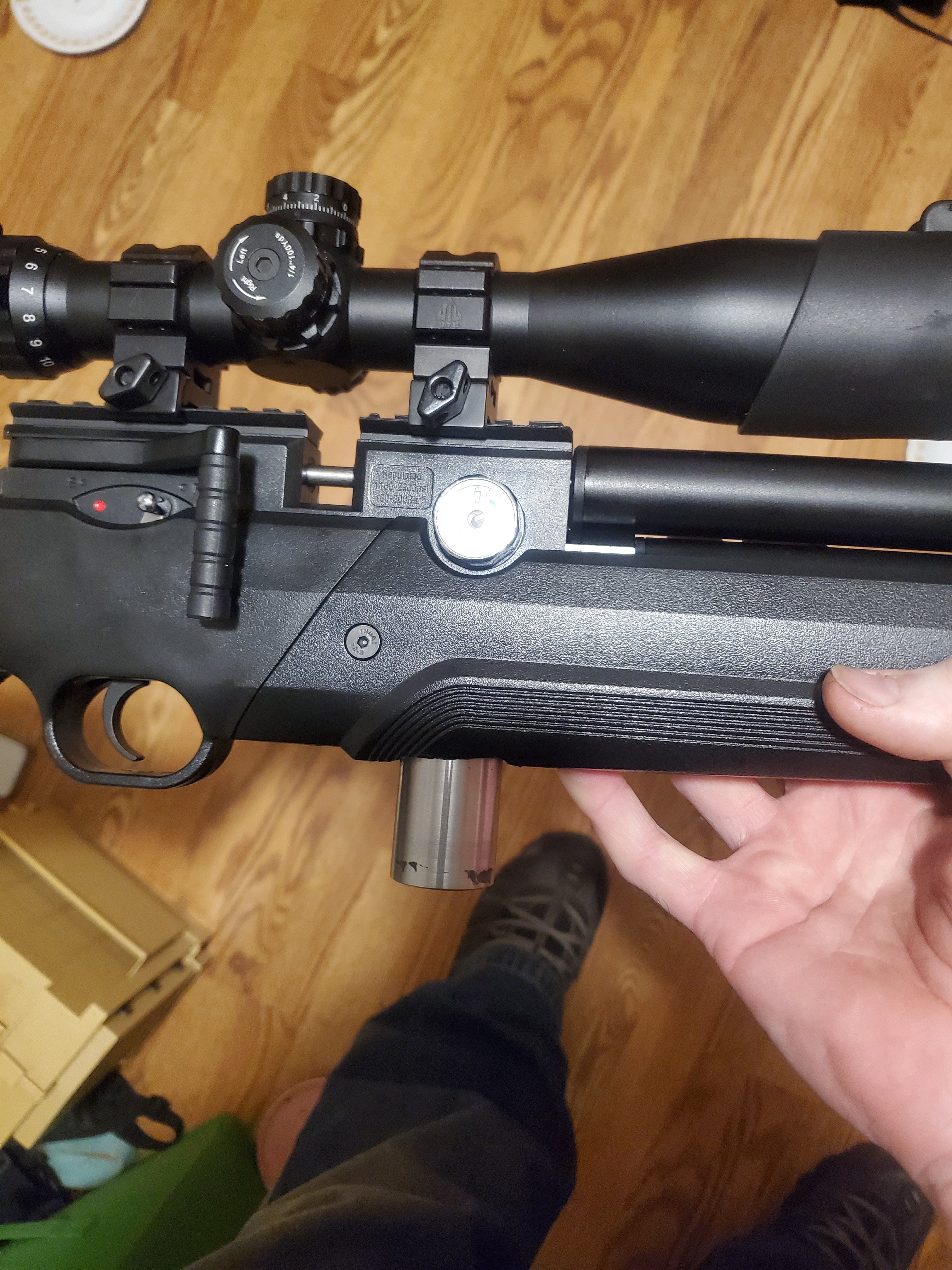

I might add one of these to my .25
How long does it extend out?
About 3in maybe?
Where can I get one?
Do you remember the cost?
