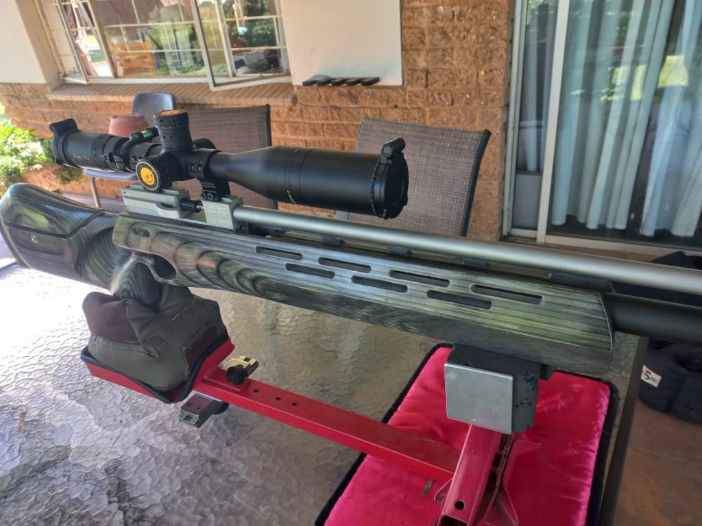

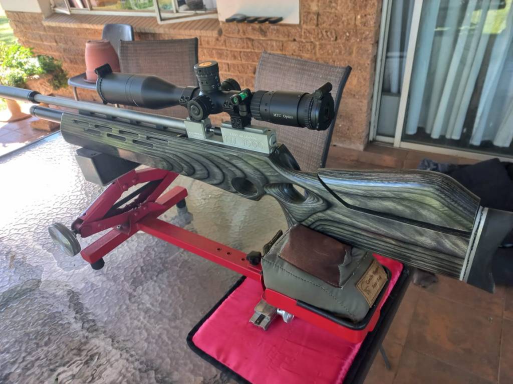

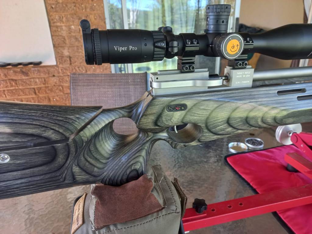

Thanks Guys, appreciate the good advice. It has a custom laminate stock made by one of our top stockmakers, I am sure you will appreciate the beauty of this gun.
