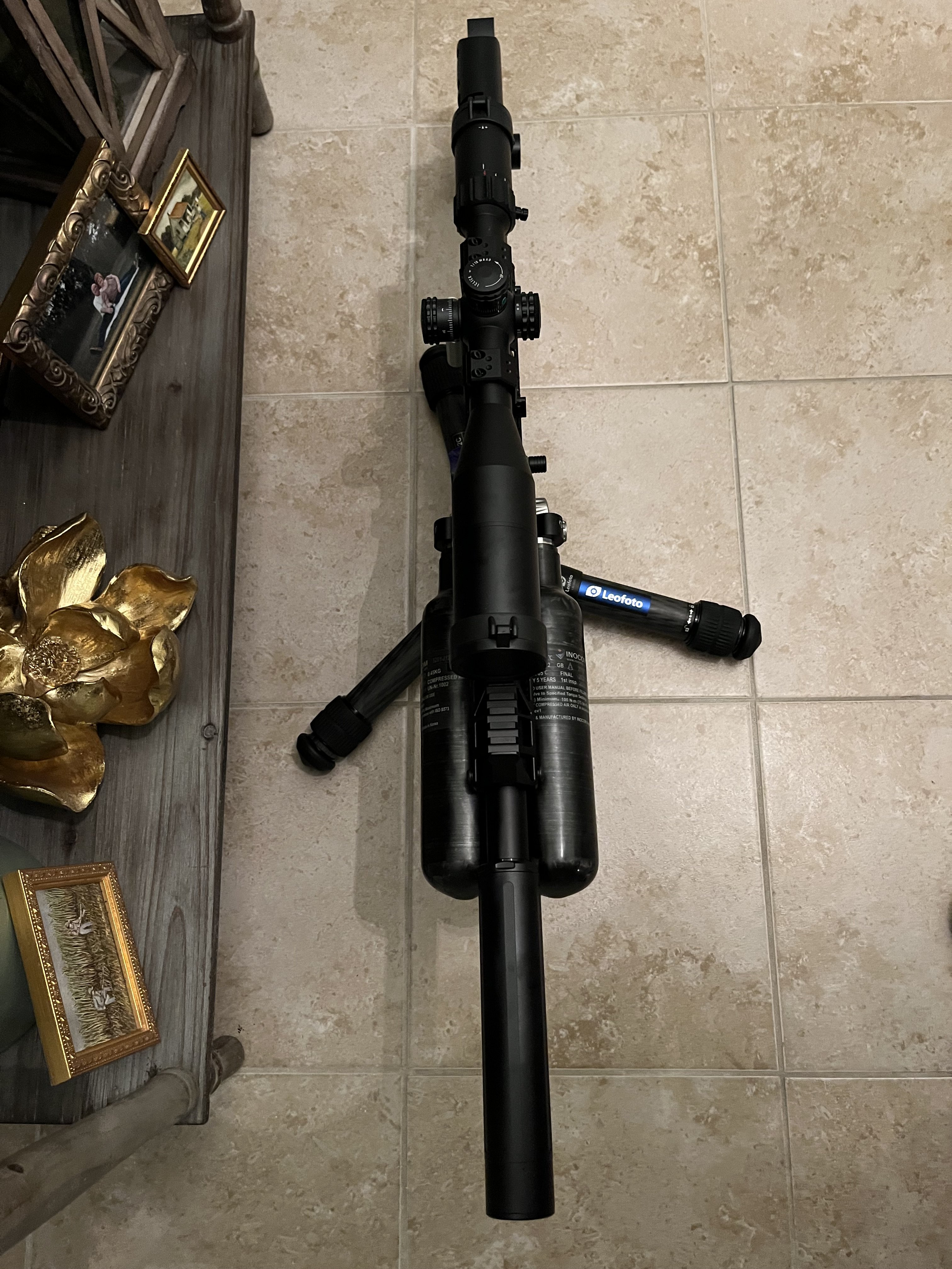

I had my maverick in a double sided AR case and I couldn’t close it all the way. So those tiles are 12” X 12” so you looking at 6-7” wide
Really appreciate the pic. I might just go for a standard barrel length with a 580cc bottle after all.

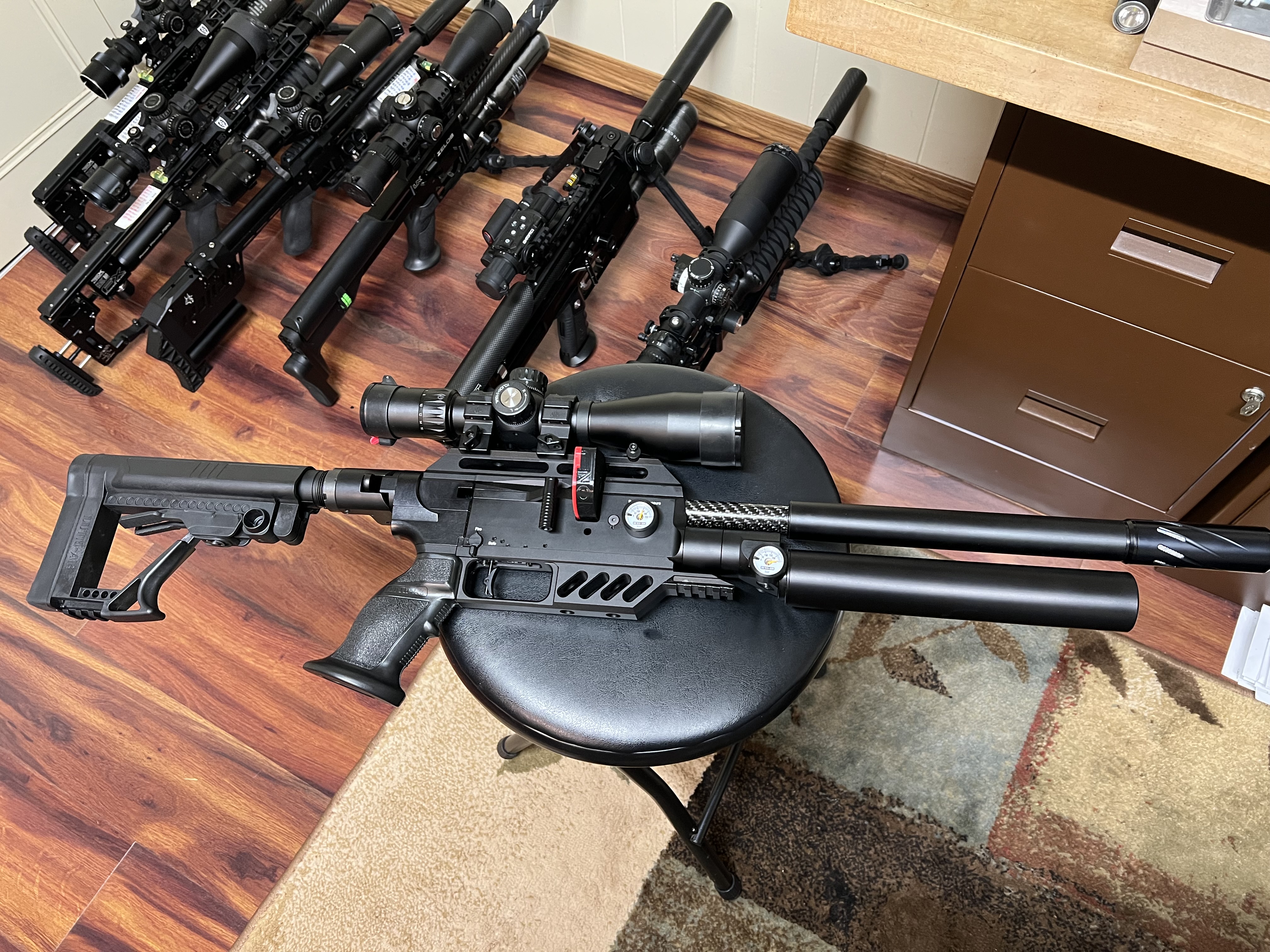

I am the opposite i look for a conversion away from a bottle to a tube .
It’s funny you say this. I just got my Dreamtac back from my dad. I had to reseal his BSA so the Dreamtac was a loaner. First thing he said was he didn’t like the bottle. I said you’re in luck. Went home and got the tube the gun came with. It does handle way nicer this way. So I snapped a pic before I put it back in the safe. Going to leave it a tube gun for a while.
