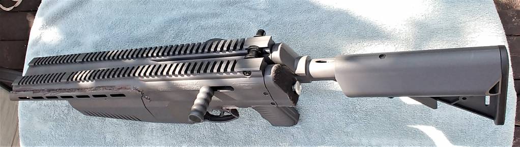

When I was working on some minor Mods to my Air Javelin arrow carbines I cut the butt stock and pistol grip off of one of them while doing some tests. Since it was still functional I was curious if it could be mounted alongside of an unmodified Air Javelin to make a functional, if somewhat bulky, double barrel 2-shot arrow carbine.
Using the single butt stock on the unmodified Javelin (on the right) worked surprisingly well since the left hand helps to hold the barrels up and even. The cocking handles are on opposite sides of the guns, and I could use both triggers separately with a modest stretch of my trigger finger.

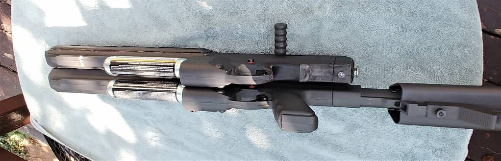

The CO2 covers still fit over the cylinders but added unnecessary weight and bulk.

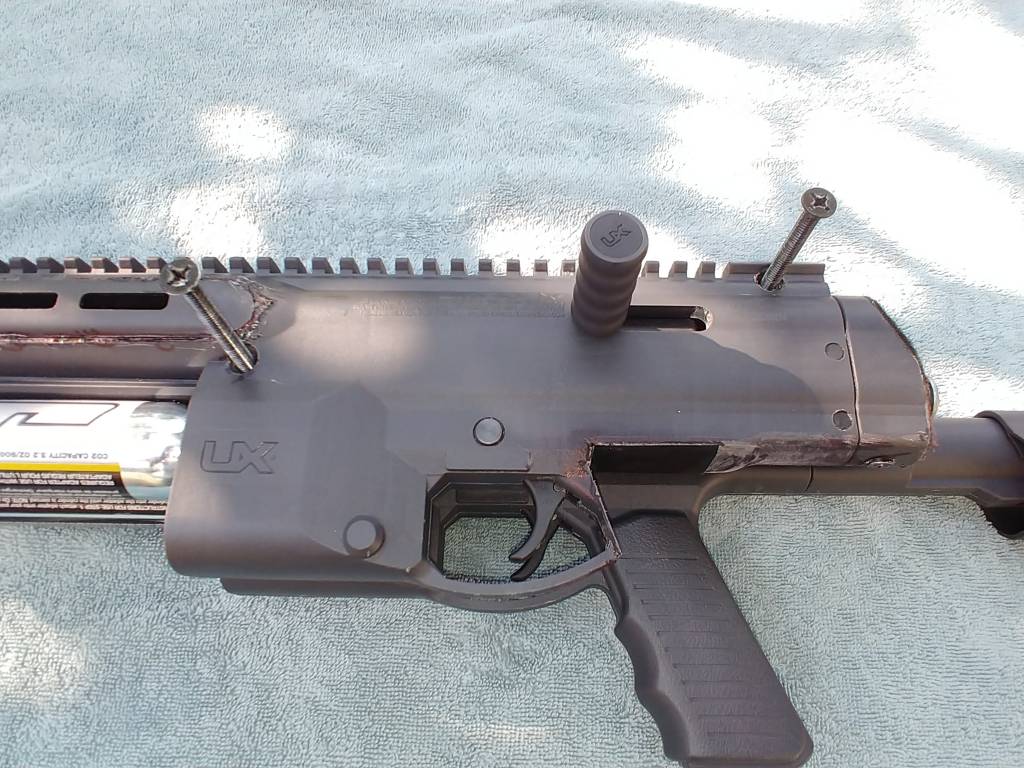

In the next 2 pictures you can he how all of the grip behind the trigger guard needed to be removed from the left Javelin for the triggers to line up, while still leaving enough hand room to hold the pistol grip and to reach both triggers with one finger.

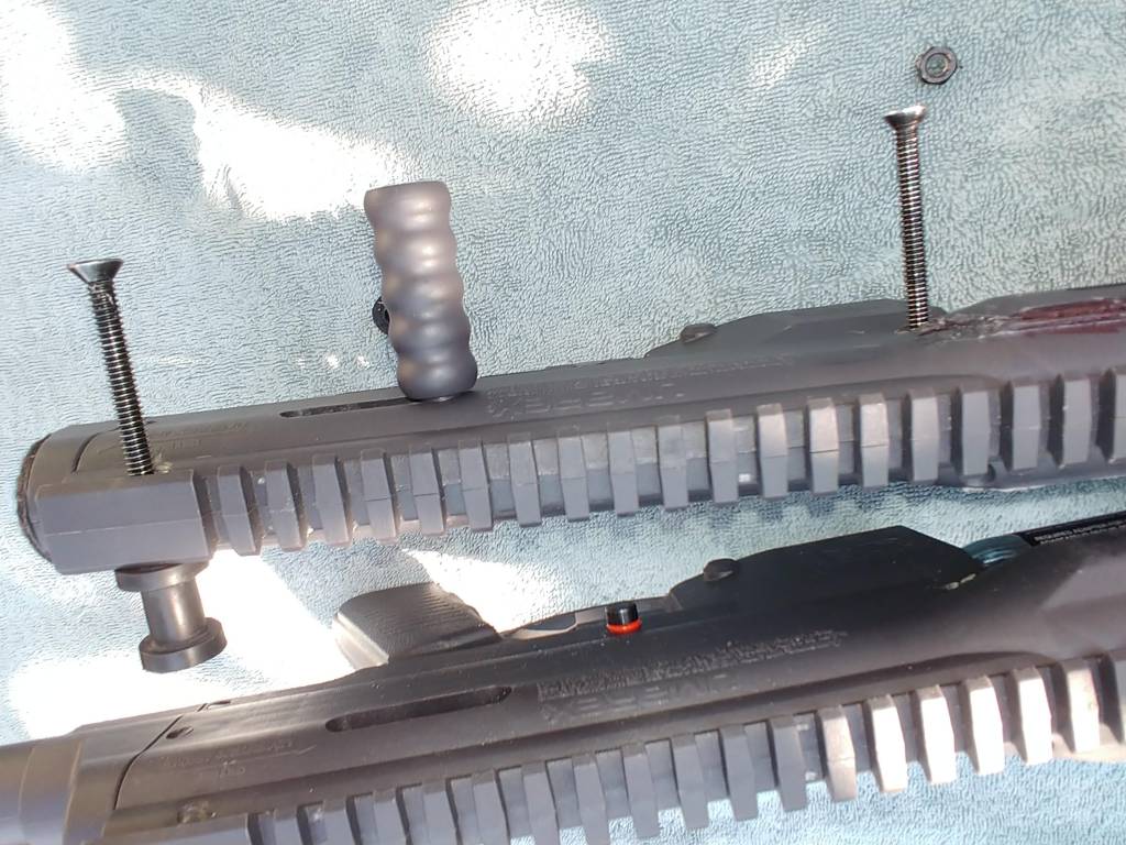

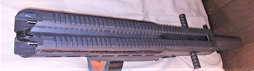

Holes for the bolts which connect the two guns were drilled directly through noncritical spots in the stocks. The flat bolt heads didn't show after they were tightened flush to the stocks.
The shroud tubes were a bit too wide for the actions to be bolted flat together, so I cut out a section along the inside of the left Javelin's should to make that shroud about 1/2" narrower. That cut doesn't show when the 2 shrouds are pressed together and accuracy was unaffected. Mostly it explains why the gun in the picture below looks so patched up.
