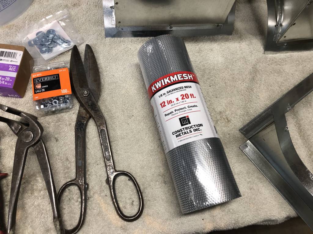

I have a question on rubber mulch traps, does the pellet hitting the wire mesh make noise?
Heck no!! It’s already “pre holed” and my ammo is flying thru there so fast, and the mulch is right against the screen. So in a fraction of a second’s fraction, the pellets point slices thru the thin wire and is immediately buried into the mulch
At Home Depot in the gutter and metal flashing section they sell a 12” wide roll of what I call in my trade “bird screen “, which is typically a 1/4” squared wire mesh. This mesh at Home Depot is patterned out diagonally like diamond shaped openings, about closer to 1/8” in opening size. Good stuff and easy to work with.
it is used a lot in the soffit vents, eave vents, and the same screen tacked on the backside of gable end louver flashings. Main purpose is to properly vent your attic space while keeping the critters out.
Here it is just to the right of my bench snips-
