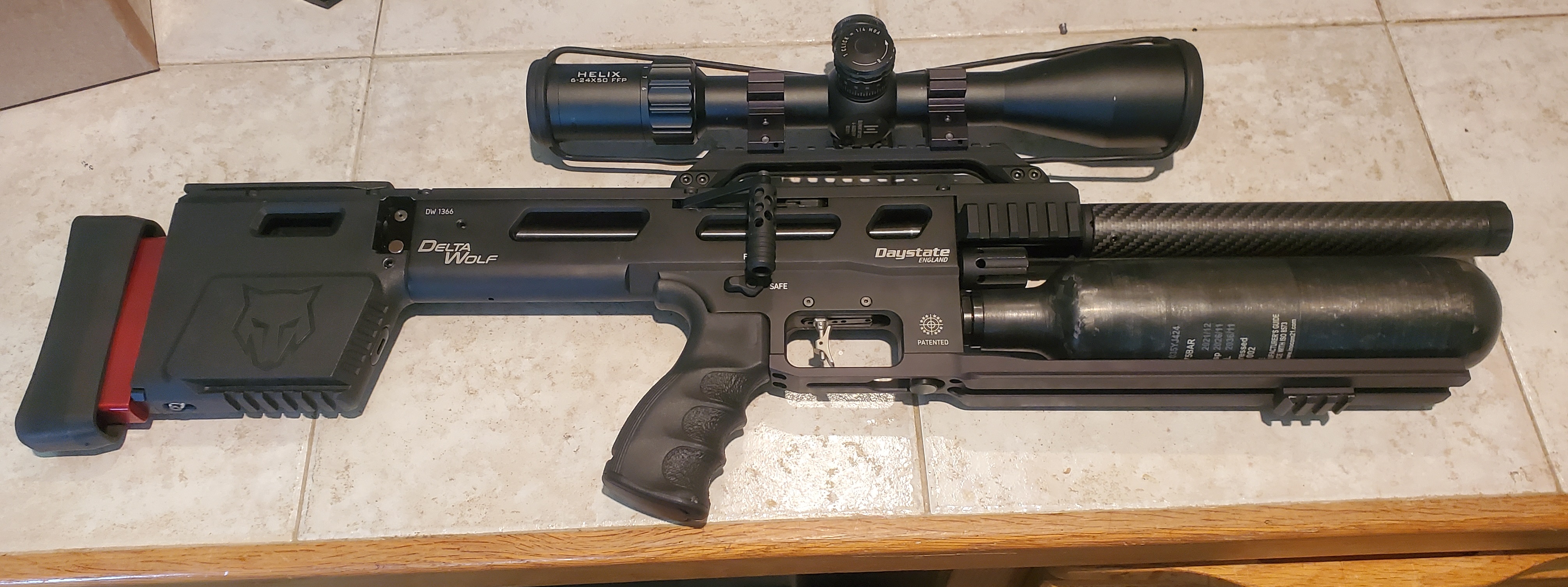

Daystate Does my .177 Daystate Delta Wolf shoot over 800 FPS?
This came tuned to shoot 10.3 gr .177 well, but then I wanted to shoot 16.2 and it only has 13.4, 15.89. and 8.4 to choose from. When I try to program 13.4 it won't select over 800 FPS and when I select 15.89gr (16.2?) it won't select over 700 FPS.
Does this not have the ability to push a 16.2 JSB pellet? Do I need to get into some advanced sort of tune/settings?
I was thinking of going 177 in that platform but when I researched it is actually utter weak sauce. I think 800 was about it with 13.43 in the 17” and I think you need 150 bar reg to do that. However you can play with advanced settings. In my gun I can get higher speeds for a given reg pressure in advanced mode than the factory mode will produce.
