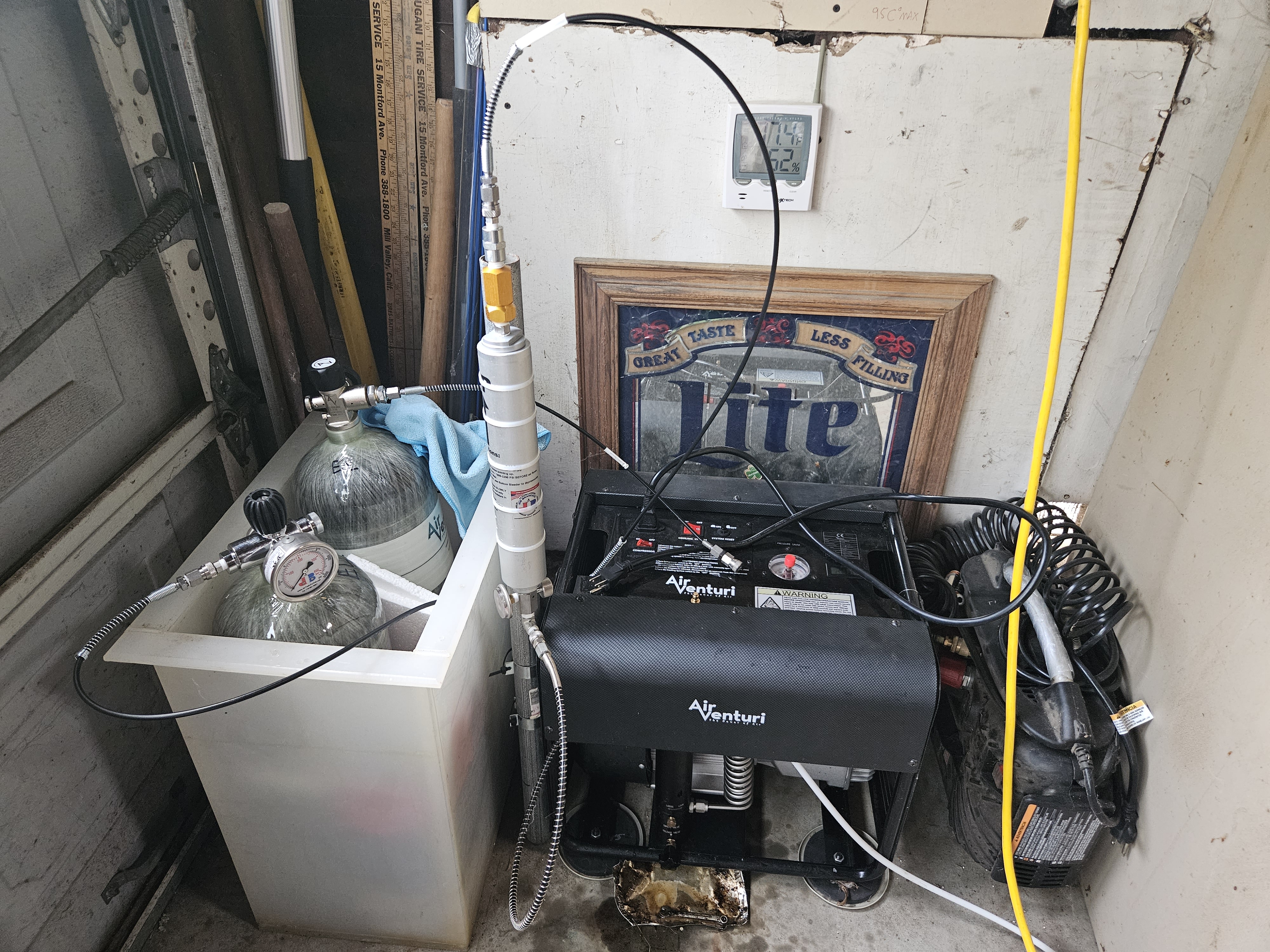

I just got this alpha filter because I noticed droplets of water in my output hose. I have the molecular sieve pre filter and now the alpha. I haven't seen a drop of water come out of the alpha, even after using it for 2 hours straight. Maybe the compressor and pre filter are trapping it all? It's about 50%rh in my garage.
Does it matter if the alpha is higher or lower than the bottles? I've invested quite a bit in pcp guns and finding water in that line made me freak out. I think I've got it set up OK but thought I would post a pic incase anyone notices anything I've got wrong.

The setup you have there looks good, Your PCP should also be above the compressor and filter, Humidity looks good to go
