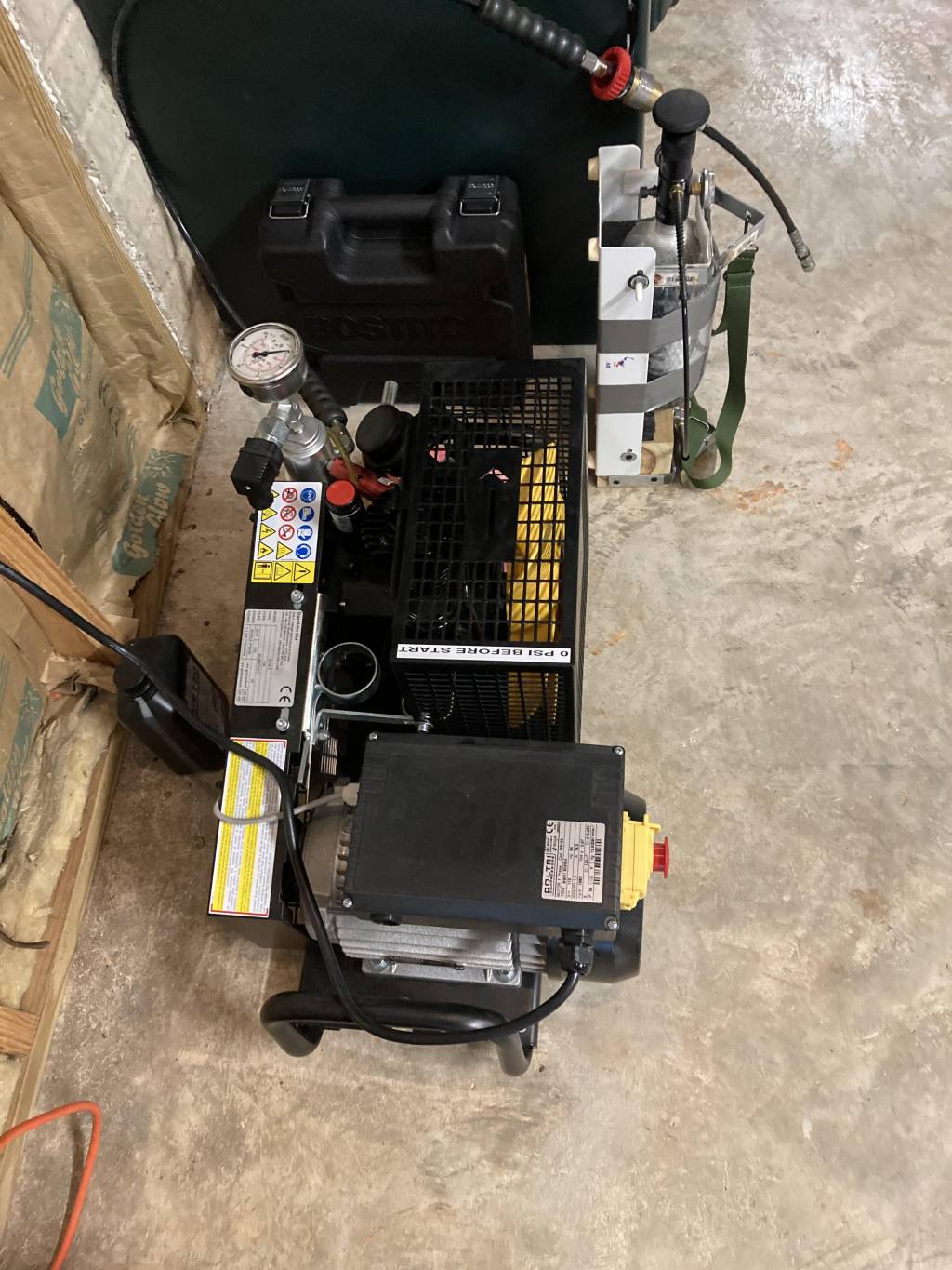

I have owned a LC-110 since 2018 that I use to fill my 90 cu-in bottle. I fill inside and the humidity is relative 50-55%. I have no bolt-on extras other than stock. I have never experienced indicators of moisture incursion into my air systems.
Like many experiences we all share I suspect much of it may vary based on location and circumstances. I applaud the innovation and inventions constructed by our AGD friends to work around improper engineering but like you I think at a certain point indeed you get what you pay for. The somewhat inexpensive portable compressors we see under various brands are certainly suspect and are often water pumps as much as they are air compressors.

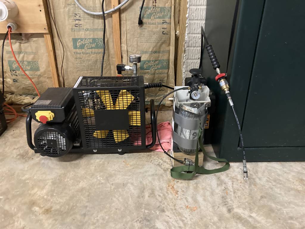

Here is my setup, I fill in the basement, and as of now:
Bottle fills my Brocock Concept Lite.

LMNOP - love the setup. Nice compressor, just out of my price range. I believe you are right. A well designed compressor should take care of the condensation without all the extras. As for humidity, it's been the monsoon season for us. Two (yes, TWO) major thunder storms with driving rain this week. Granted that's the first rain in 2 months. But the storms took us from driest year on record to third driest. For the most part, the cold beverage glasses would be dry as a bone here.
