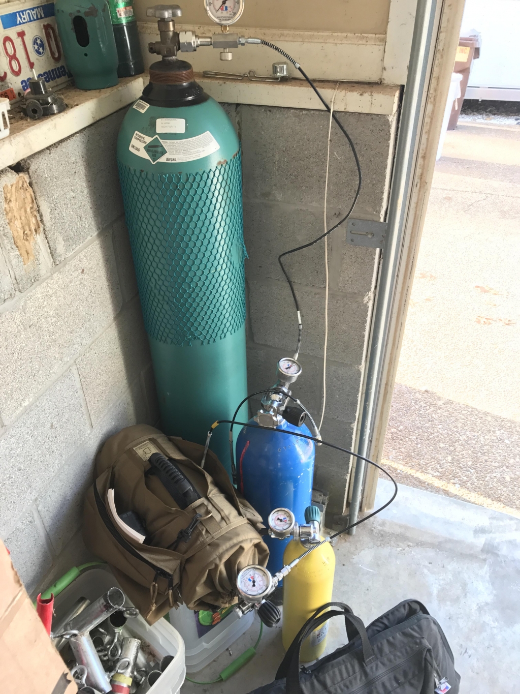

Nitrogen works great but you need a gauge set. Preferably a regulated gauge set but those are $500-$600. If I were inclined to buy a high end $3-$4k compressor to fill a scuba tank I would just rent a 6000psi nitrogen tank. No maintenance. Just fill your rifle and shoot. They drop them off at your house and switch the tanks out. We get about 350 Marauder fills out of a tank. So basically a person could shoot everyday for a year so a normal guy that shoots 2-3 days a week could shoot for several years on a tank. Of course I am talking about normal rifles and not some big bore air hog that gets 8 shots per fill. Nitrogen tanks aren't portable though. So you could get a guppy carbon tank and fill it off the nitrogen tank if you want to travel.
Nothing but nitrogen for me. It’s dry and clean
1554647409_20310914425caa097191a8c6.73164696_62CB5299-A5B2-4AB4-B946-ACDC556D37B1.jpeg
