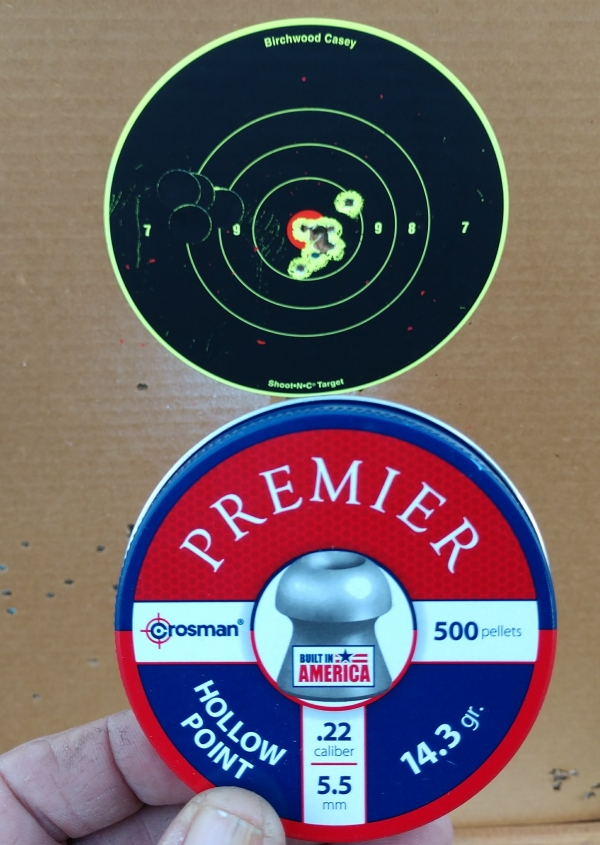

The last 2 times this week when I took the rifle out back to do some target shooting and plinking the first 15-20 shots were 2" low and 2" left. Then miraculously with no adjustments or changes in my hold they started pounding the bullseye.
What is happening? Does the gun need to "warm up" or what? And how can I prevent this?

I guess it was just LEFT the other day. But today it was Low and Left.
You can see the "patches" over my first round from the other day. About 15 rounds later it ZEROs again. And it will stay zeroed as long as I keep shooting. But take it inside for the night and I guarantee tommorow that MFer will shoot the first 10+ round either Left...or Low and Left.

First thing I would do is shoot it over a chrono if you can....see if the fps is the same from when it is wonky to where is calms down.
Are the shots going 2" this way and that way....are they in a nice group?....or are they all over the place.
One of my gamo rifles an old silent stalker does this, and for some reason the first 10 or so shots are around 200 fps slower then the others.....I just noticed it not that it has gotten cooler as well (I am also in MO) I have also noticed what could almost be called dieseling with the gun at first...then it goes away, the speed gets FASTER, and the shots start going where I want them to.
I keep my gun in the basement so it is cool down there, so I don't think going from warm to cool, not cold is it....I don't really know, but I would love to see what the fps numbers are between the gun shooting stupid and shooting well.
