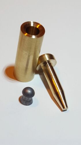

Try to get hold of a TAPERED sizer, it's what pellets were designed for... Head smaller and somewhat bore riding and the larger skirt to seal the bore.

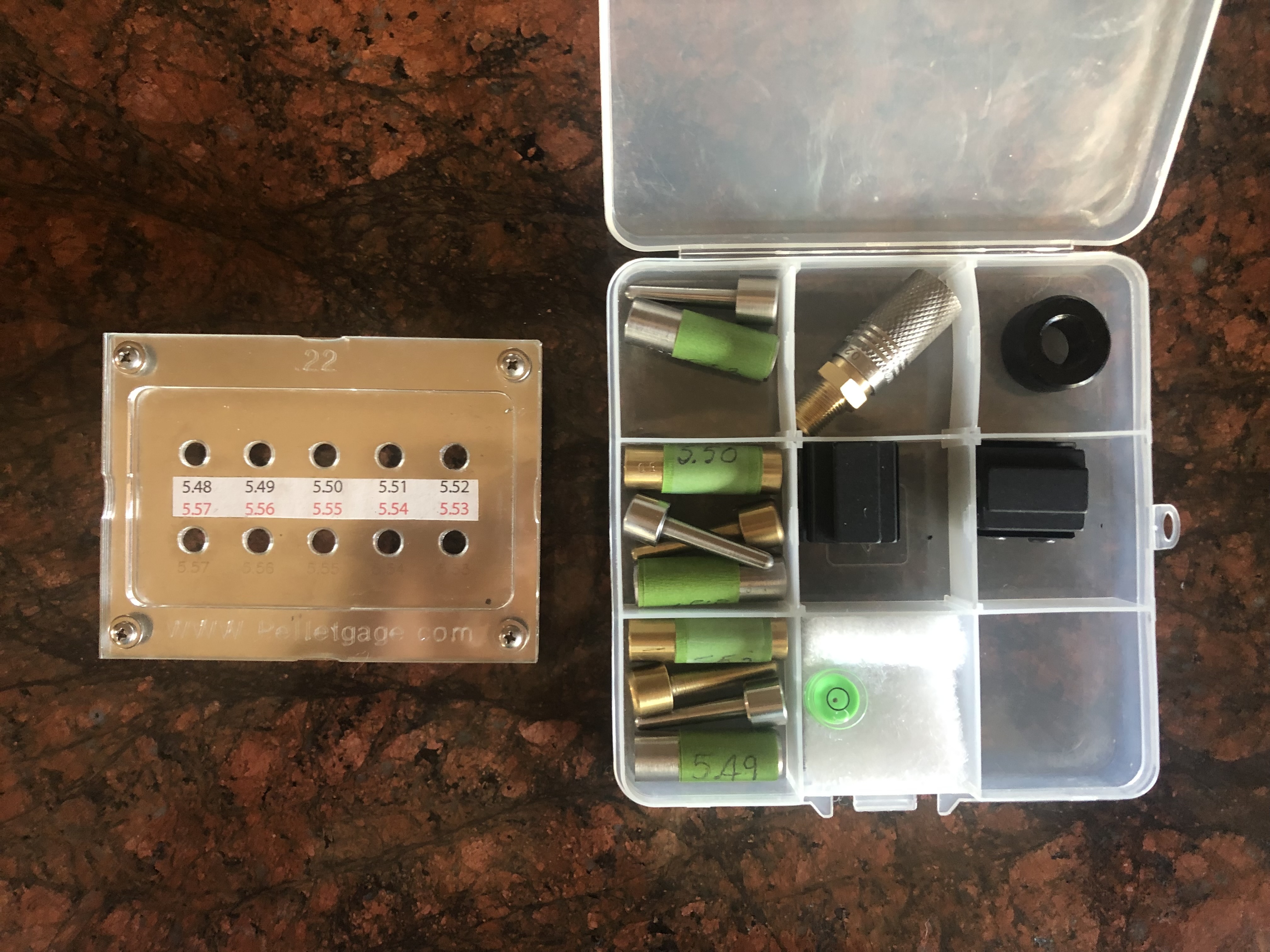

I did a lot of accuracy testing with 9 different air rifles (5 .22 and 4 .25) all mounted in a rifle vise, all on a regulated air supply trying different sizing and found that straight push through sizing usually hurts accuracy or does not help much. Tapered sizing, however, once you determine the head size your rifle likes DID appreciably tighten groups over unsized pellets. Some of that is that damaged pellets get sorted out or repaired/trued up also though.
I found that oversize pellets did not shoot as well so the philosophy that it "sizes as I chamber it" is not true either for the best accuracy.
Since the pellet has to go in to the selected depth in the tapered die, then be backed out it's slower to process a batch but when the gun was capable of utilizing the 'best fit' pellets the smaller group sizes (and the more surity in making that varmint shot) was worth the effort.
