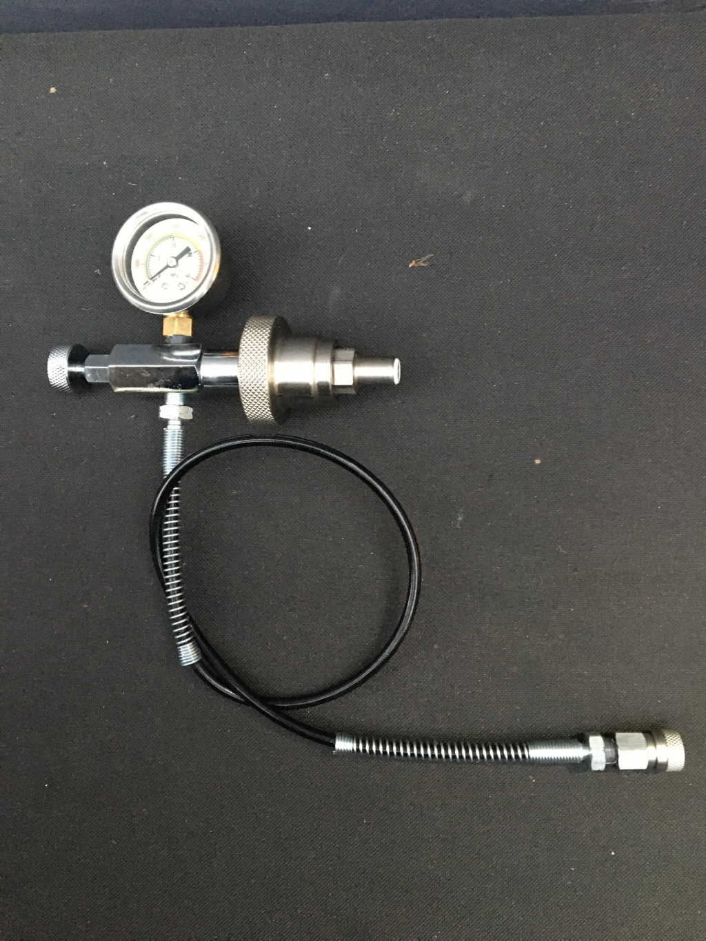

Yes, those are a very good deal. I’ve bought 5 of them over the past year, and every one passed visual inspection and hydro. That tank has four good years left in service, and it’s American Made, unlike many that are being discussed above egging you into buying new. Have no worries, there’s a 99% chance it will pass inspection and hydro. You’ll need one of these...
https://rover.ebay.com/rover/0/0/0?mpre=https%3A%2F%2Fwww.ebay.com%2Fulk%2Fitm%2F401568527106
