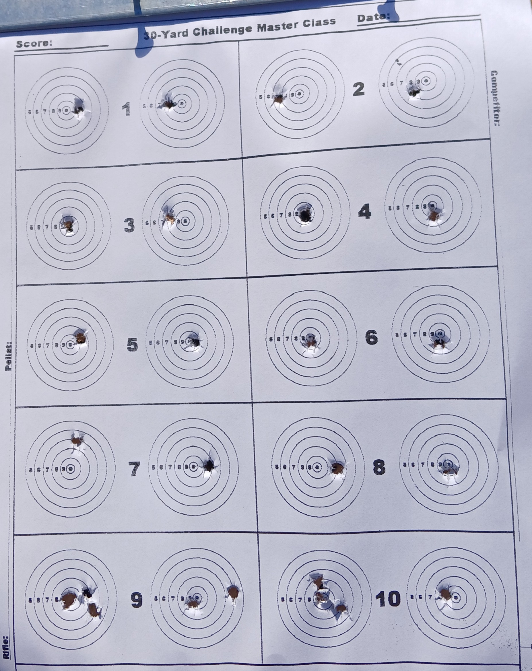

I figured out recently that my SPA made bullpups, a P35-22 and a Bullshark in 22, really like AEA pellets. A 22 grain for the P35 and a 18.1 (called a 18.3) for the Bullshark. Both have given me a 200 on the 30 yard challenge with these pellets. But they react quite differently from barrel cleaning. The Bullshark had been shooting really well but then gave me a 194 and a 195. I cleaned the barrel and shot two 199s in a row. So when the P35 seemed to be a little off I cleaned it. I fired 10 shots into the practice target then started a "real" target. I dropped 5 points in the first 10 shots and then only 1 on the last 10. So it needed 20 shots to lead in the barrel.
I was shooting the Bullshark this morning in pretty much still air. The scope seemed to be adjusted for a little wind and I was working to dial that out. Then I started this target. I shoot left to right then right to left down the card. Things were going OK until cell 7. I was getting 9s and 10s, not great but normal for me. The first shot on 7 was a 9 but then the second was an 8. I looked at the wind flag and it did not seem to explain it. I moved on to 9. The first shot on the left bull in 9 went a little low and right and is another 8. Then the first shot on the right hand bull went really right and is a 7. So I knew something was off and cleaned the barrel. I used cell 9 to lead in the cleaned barrel and check to see if I "fixed it". Immediately the somewhat wild fliers was gone. I clicked the scope a little but I'm not sure it needed it. I shot the bull on the left in 9 first and then one shot on the bull on the right in 9. Then I shot the left bull on the left in 10 and got a couple 9s before it settled down. I then shot the bull on the right in 10 and I think it is an X.
So my Bullshark seems to get the barrel dirty faster and to really not like being shot dirty. My P35-22 doesn't really like cleaning much and takes longer to settle in after cleaning. I'm not sure which I prefer. I'm lazy enough to like a barrel that doesn't demand cleaning but I don't love it needing 20 pellets to shoot at it's best again. The Bullshark may have needed about the same number of shots to truly settle down but was very close from the first shot on a clean barrel. I guess it doesn't matter much what I want, the guns will do what they do. But just for fun, if you could choose what would you choose?
