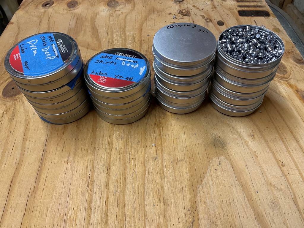

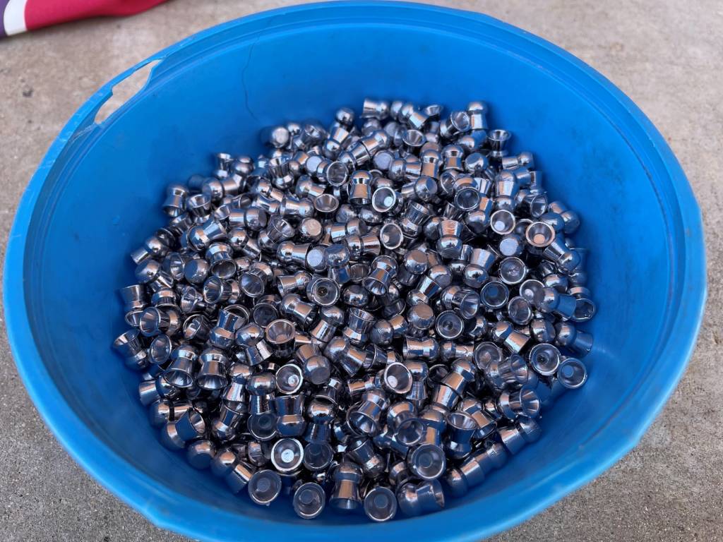

I started casting with the NOE 30cal 46gr 4-cavity aluminum mold few months ago and have been really pleased with how they they shoot. Glemm Chally has the 2 cavity and he shared some of his for me to try. Thanks again Nate. I shoot them out of my Impact MKII with a 700mm Heavy Superior liner and out of my Crown 600mm/Superior liner. Although not as accurate as a JSB or Hatsan Supreme they are probably 75-80% as good which is fine for paper shooting and pesting inside of 70yds in my case. I'm hoarding my 14 tins of JSB/Hatsans for future times. There's a couple of reason why I wanted to try it. One, the lack of availability and increase in price of the good stuff and secondly I now have a good use for my stash of spent pellets that I've been recovering from my targets for years. The pellets in the blue bowl represent what I cast yesterday in a couple of hours, approximately 720 rounds. I currently have about 3600 "free" NOE's to play with which will go a long ways. Any questions don't hesitate to ask.

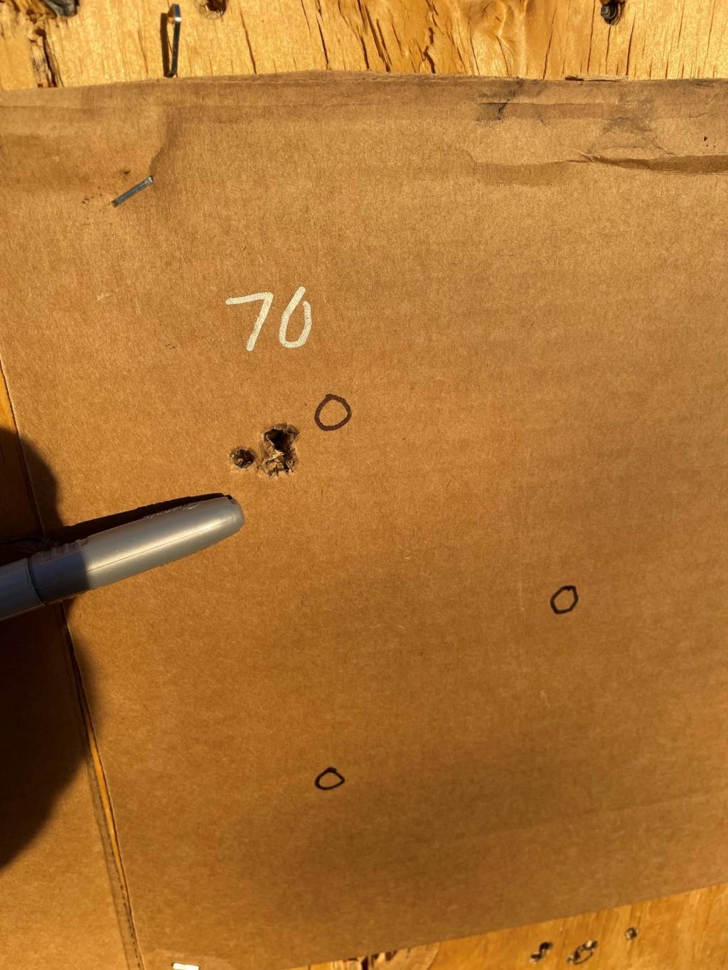

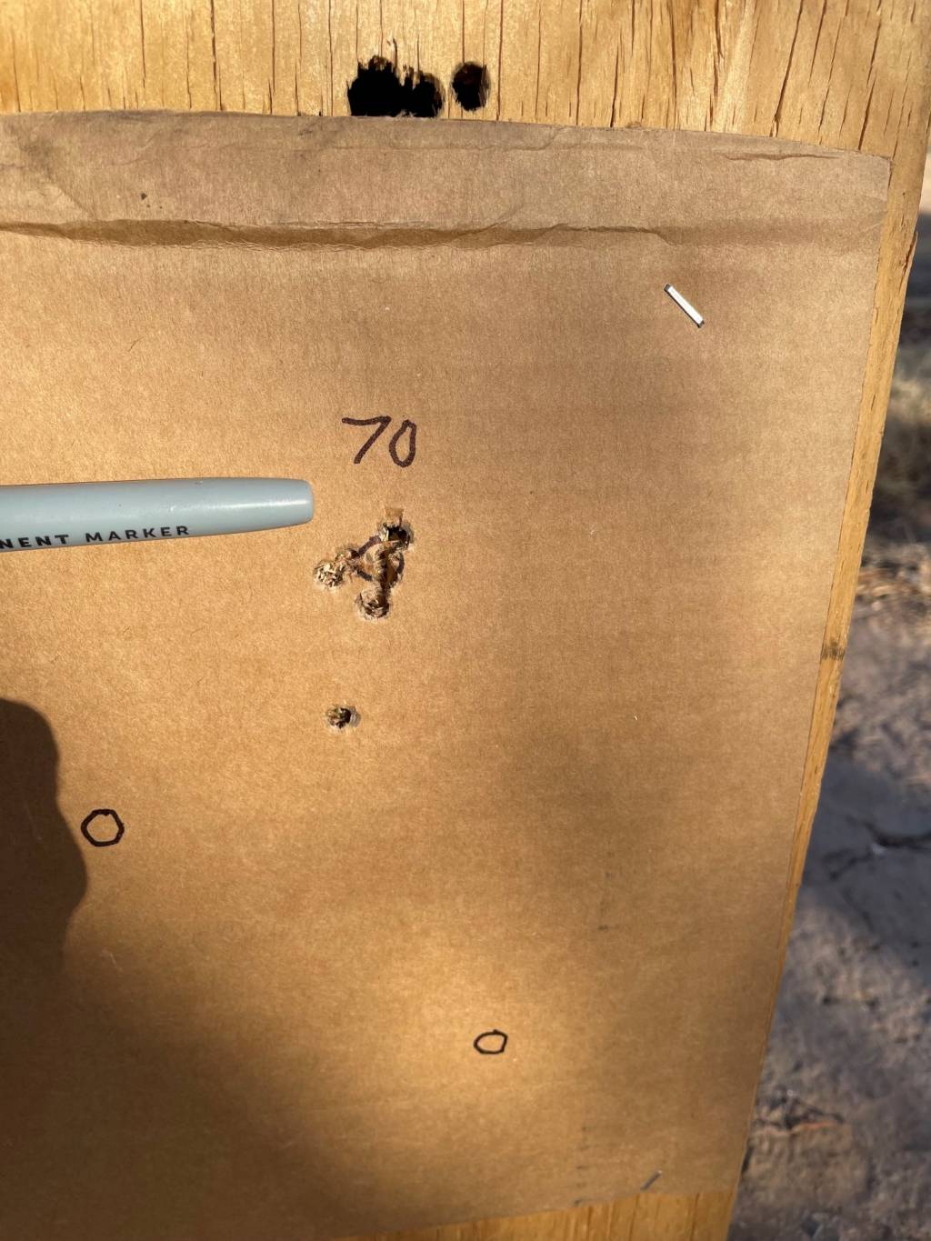

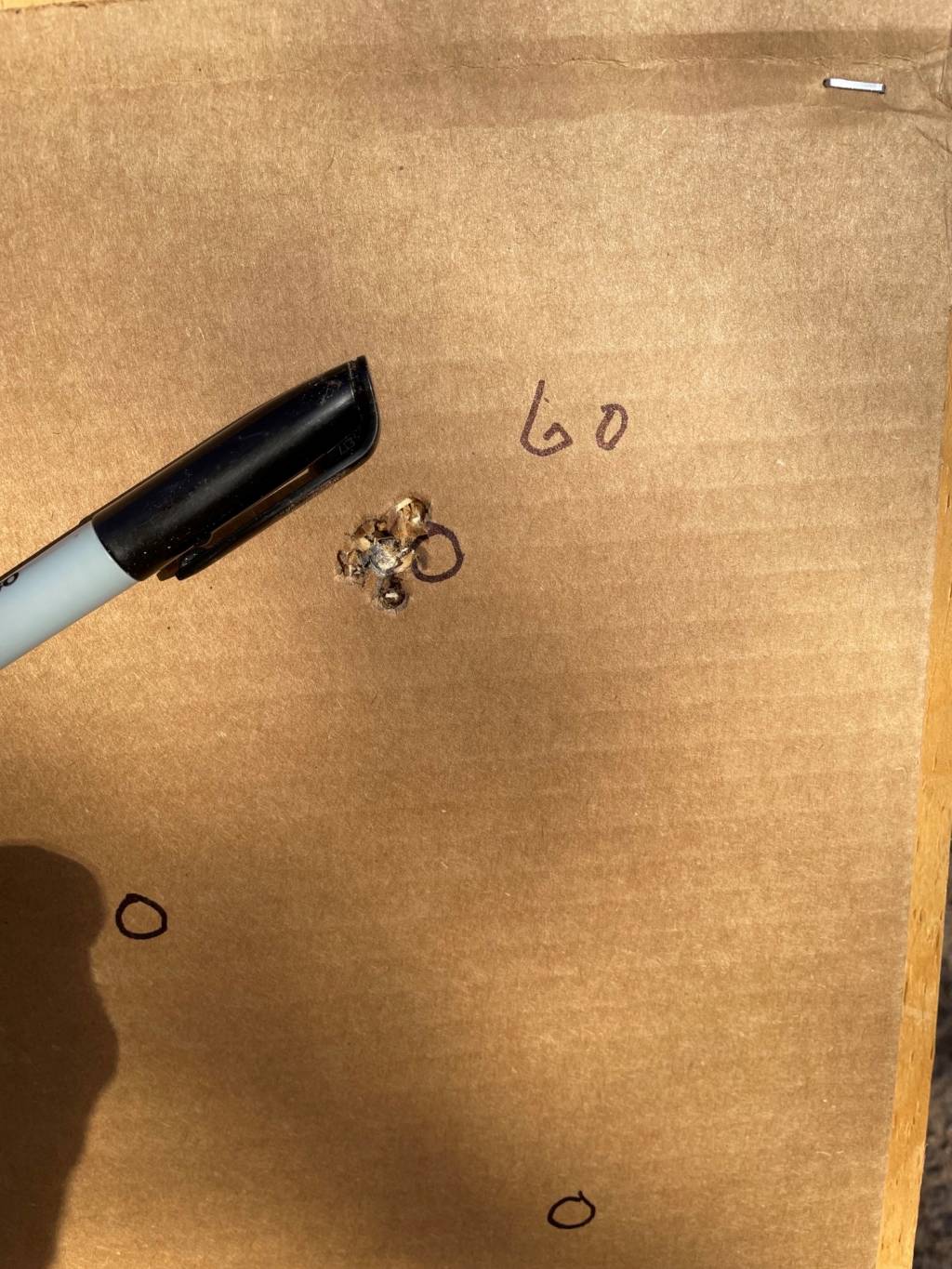

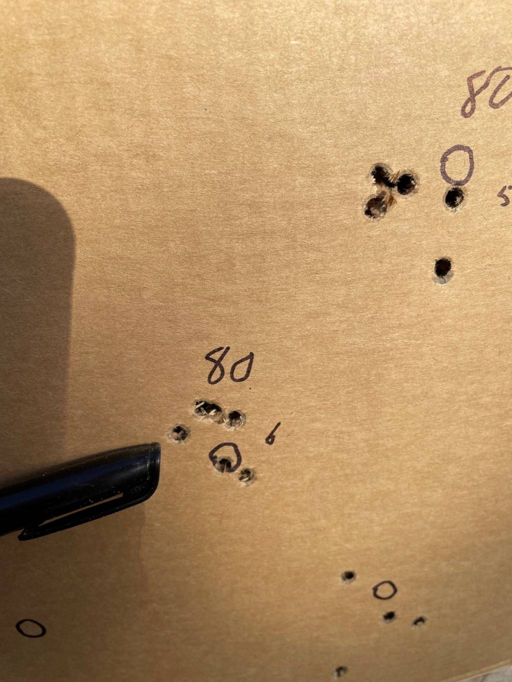

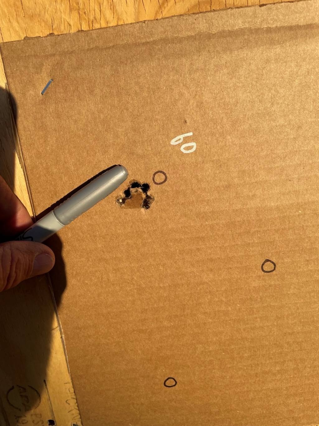

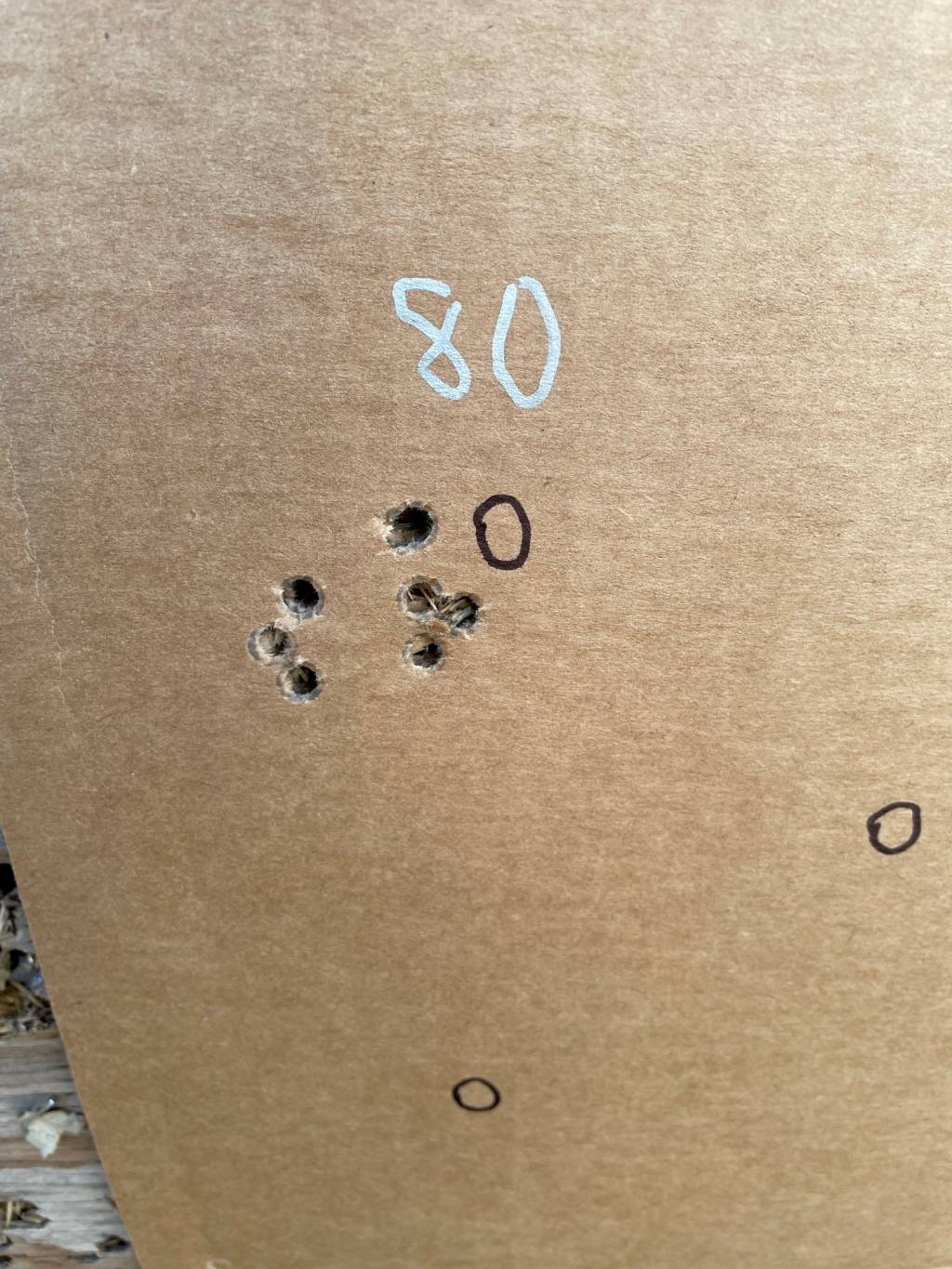

If your on the fence about trying a NOE 30cal mold I think you'll be pleased with the results, at least I'm thoroughly happy. Again they are not JSB's but for me they are fairly close and definitely worth the investment. As I said before I have about 14 tins of JSB and Hatsan Supreme but they are staying in storage. I shot these groups out of my Crown with a Superior liner in it. I shoot these all the time now but a couple of days ago I put up some fresh targets and the weather was perfect. I fired a couple of shots just to wake up the regulator and proceeded to my 60,70 and 80yd targets. I did have a right to left 5-10mph off and on breeze which seemed to show the difference at 80yds. I just shot the 60,70 and 80 single groups consecutively.

Yesterday evening I tried to repeat my results. One bad flyer at 70yds though.

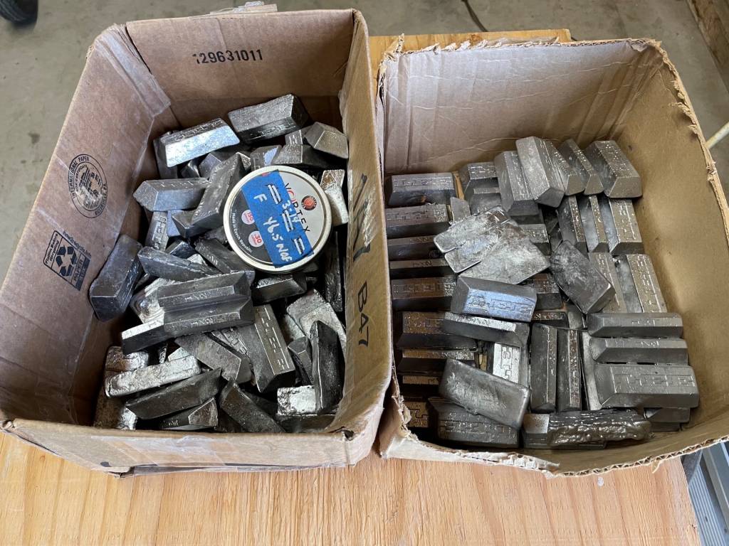

I tried pure lead with some tin added and that worked a lot better but the production of good pellets was way too time consuming,too many rejects.
I have cast literally tons of lead into bullets for PB use using different alloys over the past 35 plus years but i put the pellet mold away for now.
When i go back to casting pellets im going to get some 20:1 alloy from Rotometals,that should cut the reject rate down to acceptable levels.
