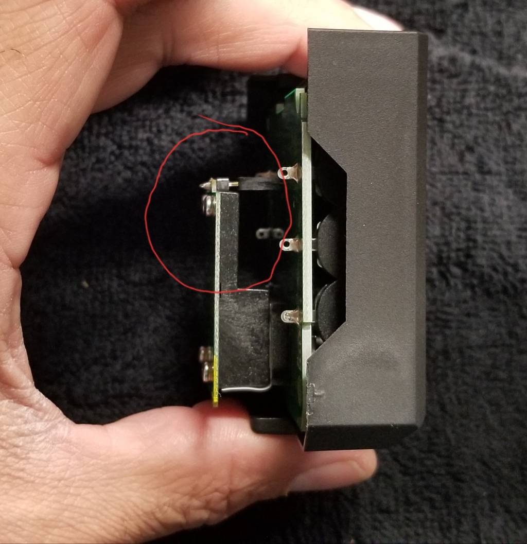

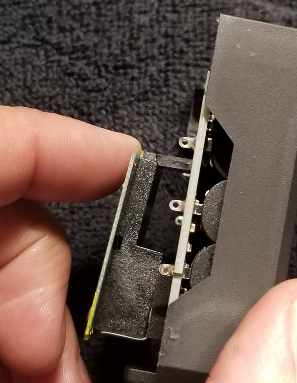

I had a problem with mine when I first got it, the sensor was coming out and making a bad connection (probably during shipping) and was missing 1/4 of the shots.
Take it apart, you will see where the sensor plugs in, put a small dab of super glue on the edge of the connector where it doesn't touch the terminals and push it all the way in, the sensor will then be angled to pick up the projectile.
I haven't missed a shot since. I posted the issue here a while ago under a deleted profile.
