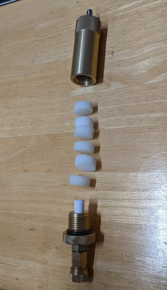

So, I've been using similar "filters" on the high pressure side of my Shoebox compressor since the end of 2018. I just tallied up my log sheet and I'm just shy of 71 hours. Lots and lots and lots of fills on a little tampon filter like the blue one responsible for the stitches in the thigh in the link above. And each fill for the filter is a 0-4200psi endeavor, not just 3000-4200 like the SCBA sees. A few months ago I bought a second compressor, with concerns of work hardening with all those 0-4200 cycles in the one that's been in use for 3 years now. But I've yet to pressurize the second one. Both were bought from either Ebay or Amazon for the something like $20 from a no-name company that is probably not even still around. I'd sure have a hard time even finding the purchase info, much less who I bought them from. So accountability is likely not something these companies are concerned with, as they can just dissolve back into the internet underworld of alibaba/amazon/ebay.

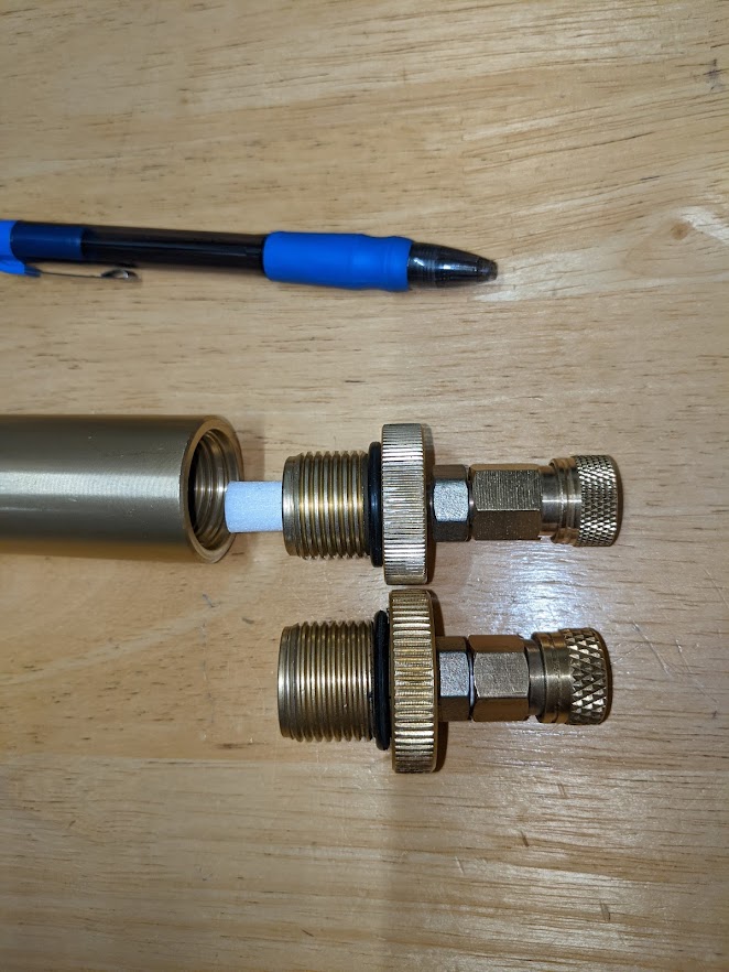

So here are the two.
And the threads...
I'm measuring the wall thickness of the one that has been in use at 0.245 inches, and the wall thickness of the "new" one at 0.230 inches. The older ones cap has more threads than the newer one dose, but they appear to have the same thread pattern.
I usually fill it up with the foam discs and then put the tampon in the end, like this. My thought has been to create a tortuous path for the air to flow through, allowing more surface area of the filter media to strip the air of the moisture ( convoluted air passageways through the foam), I've liked this method as I am not recharging silica beads, introducing silica dust/particulate to the system, nor am I buying/maintaining a supply of molecular sieve.
After I've topped off my tanks, without fail, I can squeeze a drop of water out of the tampon, the first two foam discs are slightly moist to the touch, and the rest of the foam discs are bone dry. And the tampon portion will also have a bit of discoloration if I overlubed the felts on the compressor pistons with silicone oil. The blow out on the bottom of the tank on the first stage compressor always has a decent amount of water, a couple mls would be my guess.
Some will argue that isn't sufficient, but I've been unable to find any moisture in any of my tanks or guns with this method. I live in AZ and don't fill during the rare times that it is humid. I'm not wanting a debate about the necessity of silica gel or molecular sieve or etc, etc etc. I am however, wondering if I've gotten really lucky to not have had an accident yet.

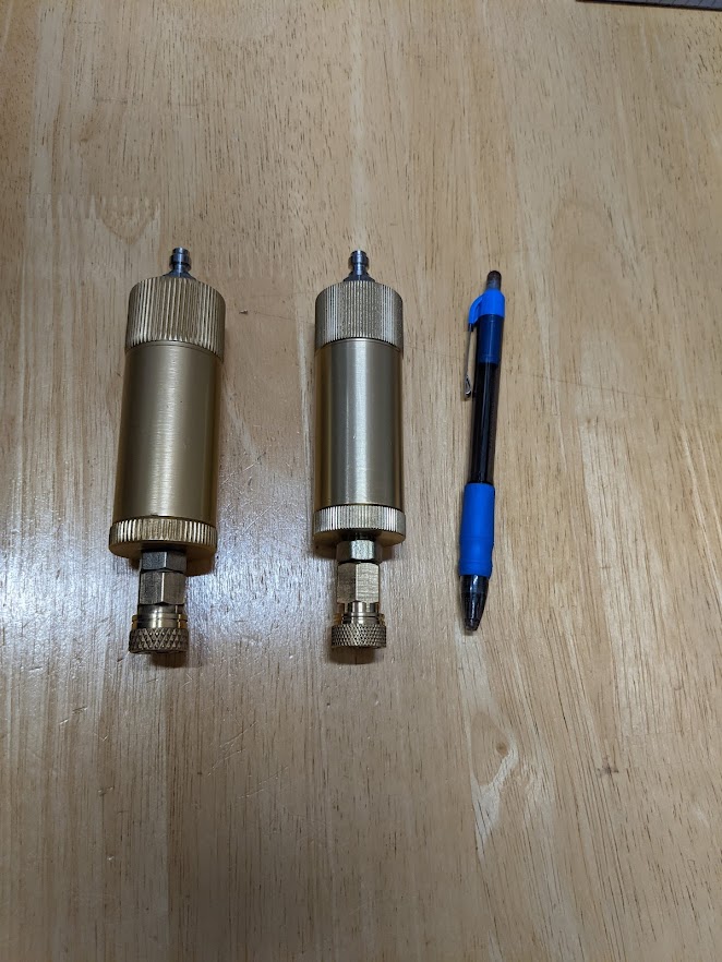

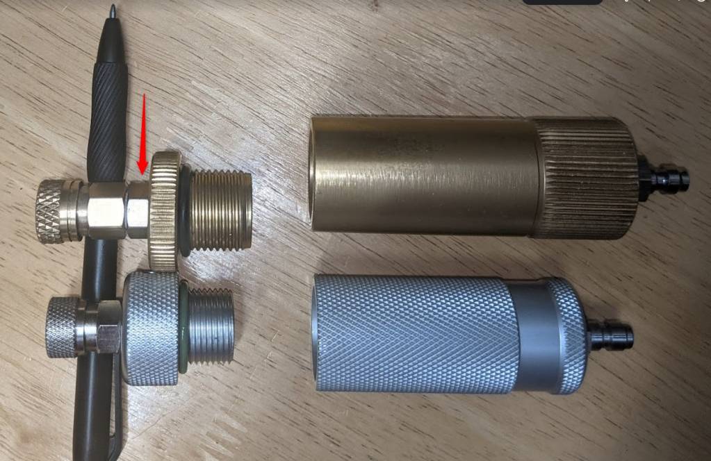

Received the new one from PA (the silver one) and did some comparisons.

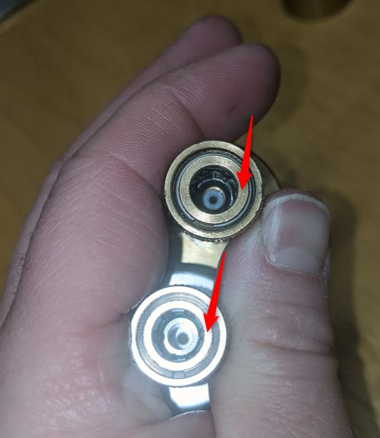

Nothing magnetic on either of them except for the small thread adaptor? the red arrow is pointing to. Don't know if non-magnetic is a good thing or a bad thing though. Not a metallurgist but I think some stainless is not magnetic.
The first thing I noticed was that the silver one has a lot fewer threads holding that cap on, and the threads themselves aren't as pronounced.
Wall thicknesses of the main body are very similar, with the new one being about 0.242 inches. What little I know about cylinder strength is that the smaller the diameter, the less thick the walls need to be for structural integrity. The new silver one from Pyramyd is smaller in diameter so the wall thickness doesn't worry me (much thicker than the walls on a PCP tube).

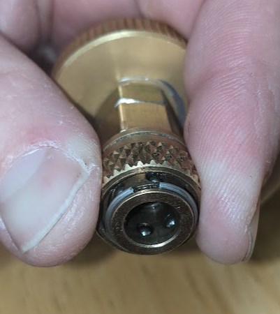

The lockring that holds the small locking ball bearings is much less robust in the new PA one.

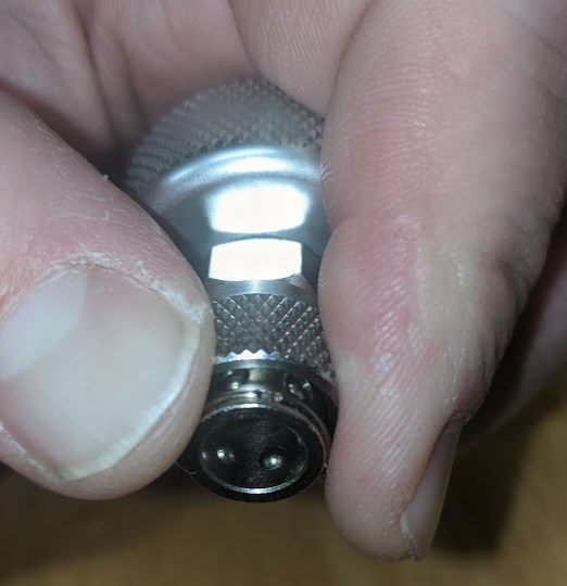

They both have 6 ball bearings for holding onto the rim of the male foster.
The following concerns me a bit too...
wall thickness of the pressurized portion of the qd is thinner on the new PA filter.
Between the wall thickness where the female qd is pressurized, and the fewer and less pronounced threads holding the cap on......I don't think I'm going to pressure test this new oil/water separator from Pyramyd Air. The close inspection of the PA filter made me feel much better about the no-name filter that has been in use for a couple of years, to the point that I topped everything off with it yesterday-without an ER visit or otherwise negative incident.

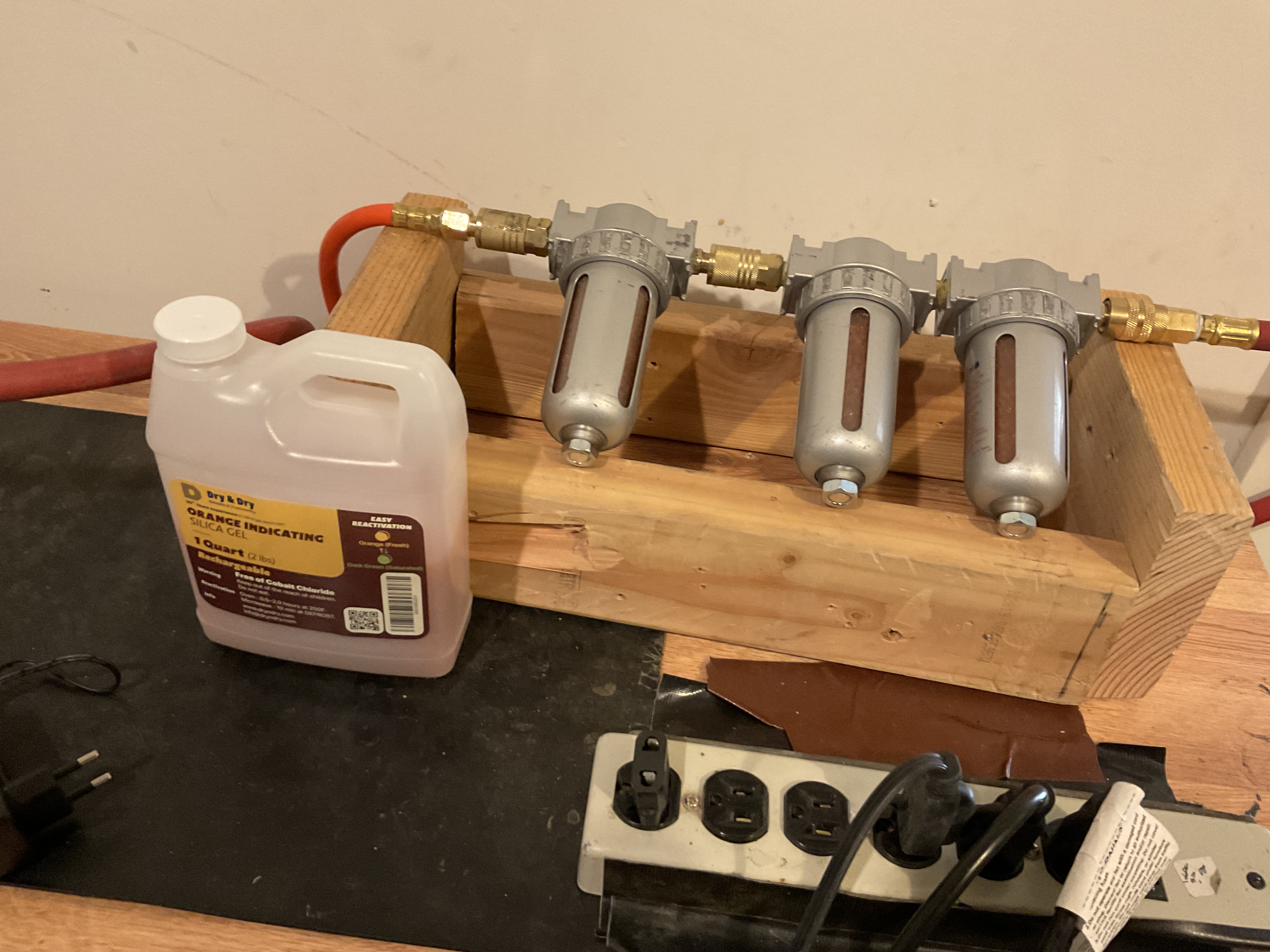

I don’t trust any midget tampon filters for removing moisture on my CAT/Altaros booster system.
This is what I use between my 3 CATS and my storage tank and booster and replace the dessicant in all three after each run. I never get moisture to my Altaros booster as a result.
I bought them off Amazon for around $45.00 each.
