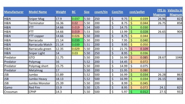

I think the Gamo barrels like the 5.50 size pellets. Below is a chart I made comparing pellets which shows the information I could dig up on the internet but I'm not sure how accurate the head/skirt sizes are. Fishinwrench - the ballistic coefficient is key for a medium power air gun like the Swarm if you want to go out to 40yds, I've been LOVING the Sniper Magnums through my Gamo Magnum and would love to try the Sniper Lights through the Swarm, maybe consider those in your next order. Also, both my Gamos shoot faster after the barrels are dirty so clean it very well if you haven't since you got it but then let it build up a little.
