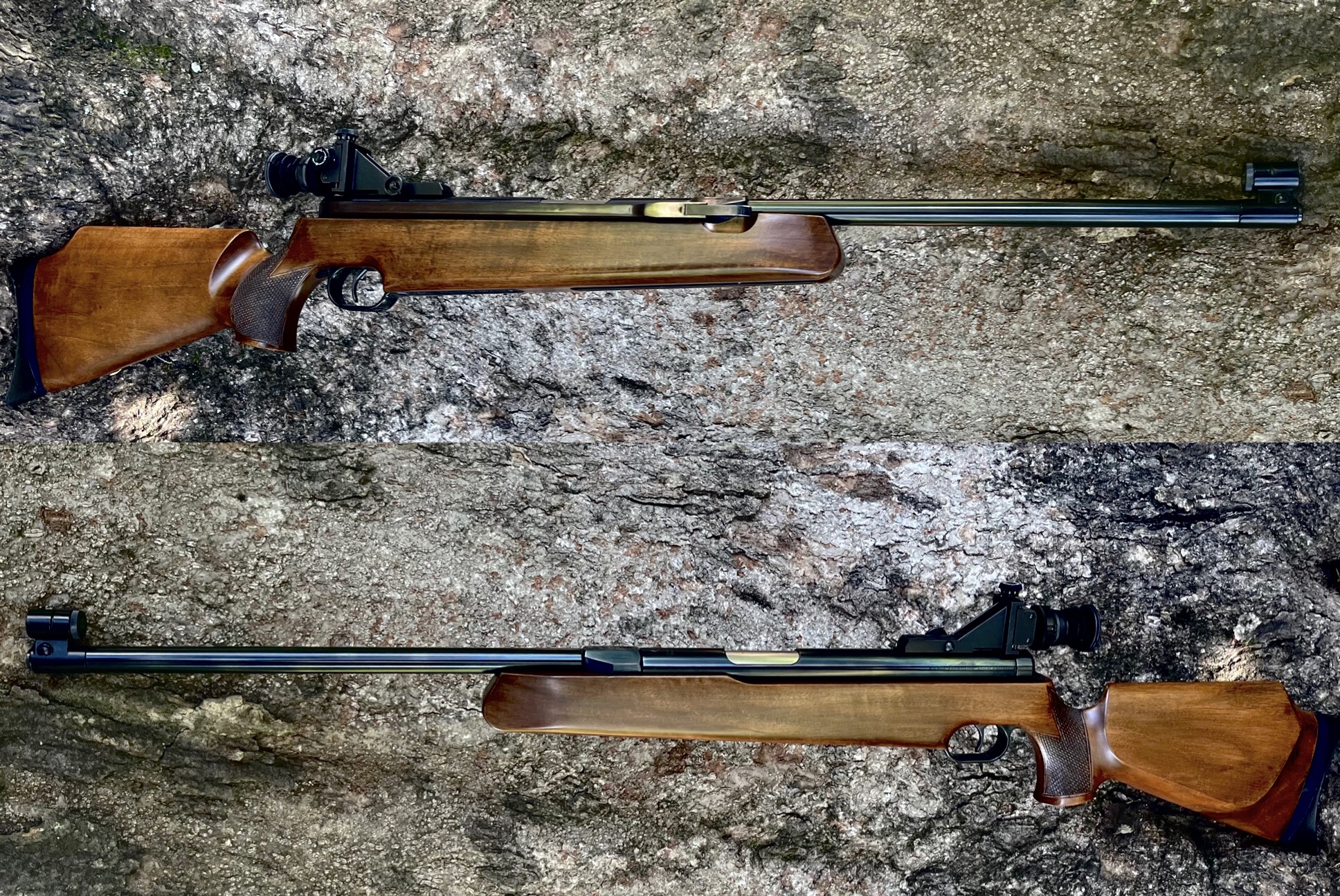

Here is a FWB from later '60's that looks new condition wise, almost unfired, but the breech/piston seals are shot and lots of spring twang. Do I need to replace the spring as well as the seals?

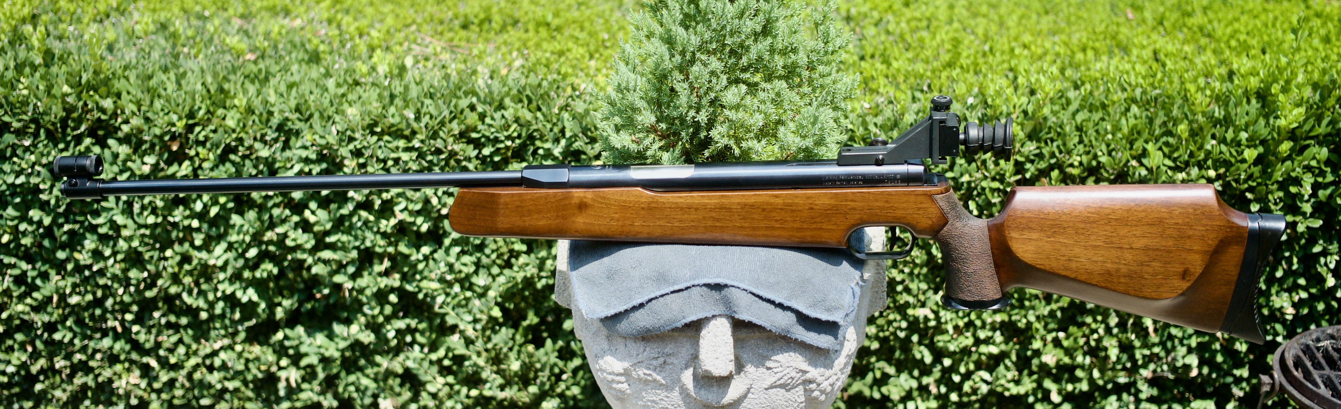

I just replaced the breech and buffer seal on this newly acquired FWB 150. 1968 model. The gun, spring and piston ring are like new. A lot of new springs these days seam of lesser quality. Why chance it. I’m not sure why you have spring twang. Won’t know till you get inside it. Congratulations, you have a beauty.
I think they lose a little bit of power over time. I had a Daisy 111 I sent to Dennis Baker to reseal and put in a new spring. He just did the reseal, and he got about 210 fps. I asked him to put in a new spring, and he got 249 fps. Granted, the Daisy 111 was about 60 years old, so I'm not sure if this is applicable to newer, more powerful springers. I don't think my 40-year-old FWB 124 had any significant velocity decline before I did some maintenance on it.

Here is a FWB from later '60's that looks new condition wise, almost unfired, but the breech/piston seals are shot and lots of spring twang. Do I need to replace the spring as well as the seals? View attachment 582742
Beautiful gun. I got two of those earlier this year. One had documentation where it had been resealed and new spring a couple of years back. Visible seals are of proper blue color. The other needed resealing so I sent it out to a reputable airgunsmith and he did the seals and said it needed a spring. Kind of hard to argue from 500 miles away.
Most gunsmiths will want to replace all internals. Not being certain of past use or abuse, they have their reputation to protect. If you learn to do it yourself then you can maintain it as you go. With the help and encouragement from other AGN members and videos out there, I found the task of replacing the seals quite straight forward.
Agree, but I've found a few times on really older airguns (Walther LG55, Anschutz 250 specifically) that the new springs are longer than the older! I just wondered if a spring that had almost never been used, as on this FWB would need replace? Maybe the metal gets less "springy" with time?
The spring over time will take on a little set. So, it will be shorter than a new one. But so will the new one. The spring in my 57 year old FWB is still shooting at factory specs with the new seals I just installed. The old saying still holds true, “don’t fix it when it ain’t broke”.
