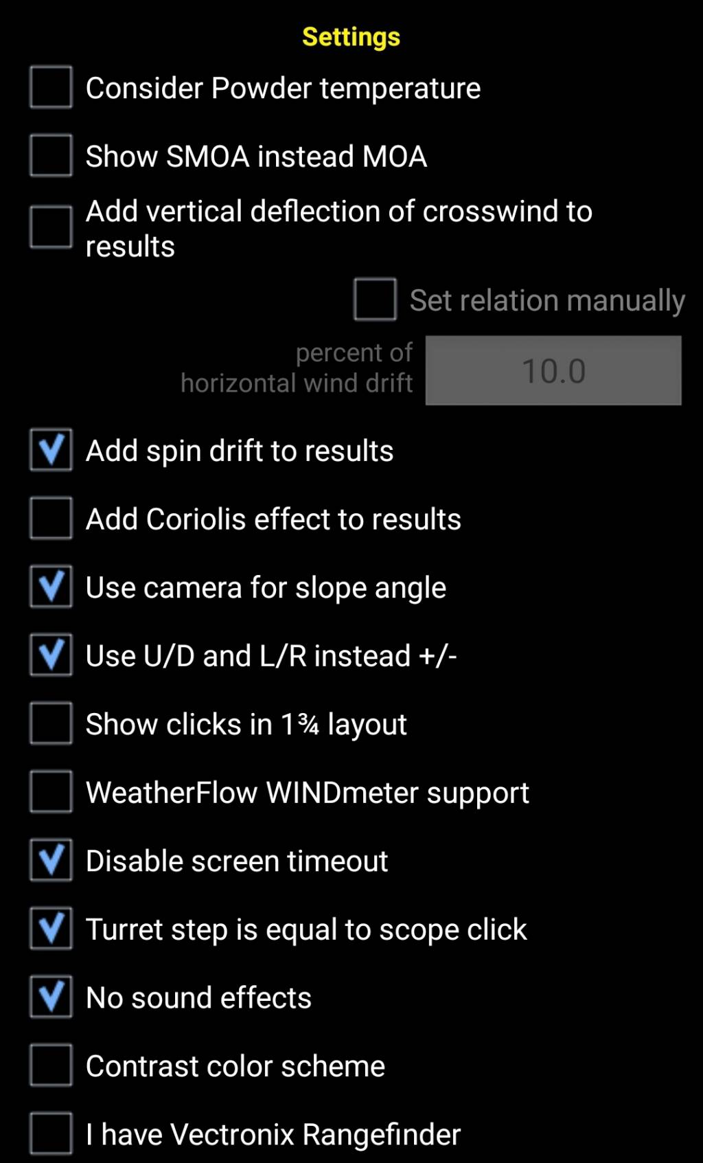

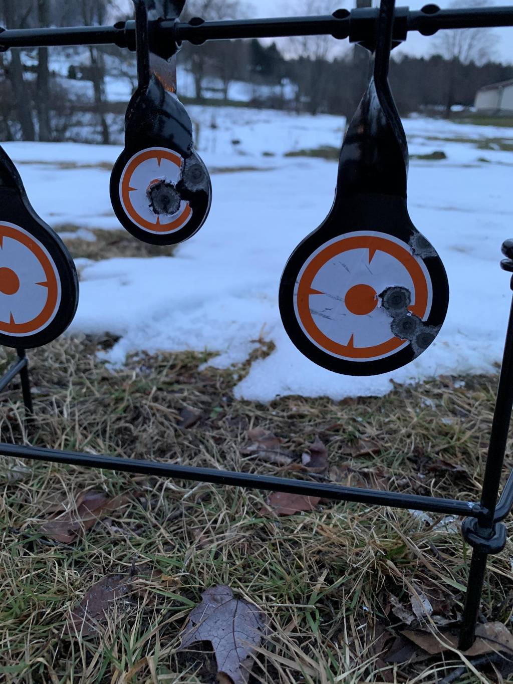

My Impact groups slightly right at 100yrds with slugs and I have a CF sleeve on my liner. I just tuned it last night after getting it all back together. As you can see by the first shot on the right spinner that my StrelokPro is off also. Once I adjusted for elevation it still favored the right. Then I shot at the little 1” spinner and it was still right. Once I held left almost a half mil, I smacked the little spinner twice dead center. I have other guns that favor the right at 100+ yards so that’s just how I hold. Accuracy is not an issue. I didn’t know that indexing my liner could possibly fix this. I always thought you just indexed a liner to see at what point it produces the best groups.

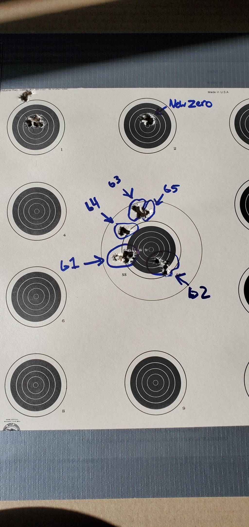

Heres a pic that shows what my indexing test did at 28 yards. Shooting at the center bull for all shots. Group one was the first 3 shot group. Then I rotated the barrel 90 degrees left to right and got group 2. I repeated the process and you can see the corresponding groups. I settled on the halfway position between 2 and 3 which is group 5. It was the most centered group and the poi was high. You can also see my new zero with the new index position.

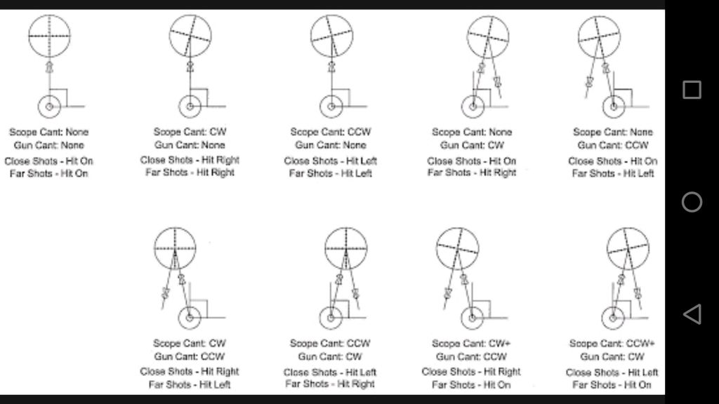

Are you holding over or dialing the turret to get to the 100 yard range? Either way, the issue may be scope cant, in as far as how it is mounted on the rail, and it's relationship to the end if the bore. Rotating it in the mounts slightly will move the reticle lines and therefore move the point if impact at long ranges when using the hold over reticle. The bubble level, if attached to the scope tube and aligned with the cross hairs, will not need to be messed with.

If the scope is not directly over the bore, and you are holding over to reach out to 100 yards it will be due to either a zero needing fine tuned or due to scope cant.
