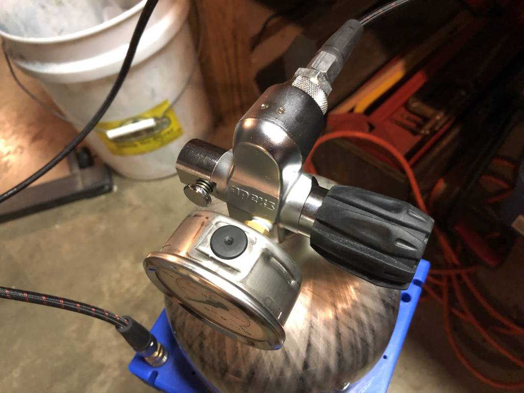

Do I get the wrong fill hose ?
My new Coltri MCH-6 arrived today and I can’t figure out how this fill hose attaches to my tank. Is it the wrong one and if so which one do I need to remove the fill hose on the tank and screw on the one from the compressor when I want to fill. When I placed the order I asked for the DIN300 hose.
The DIN200 valve and connector are shorter in the threads then DIN300.
DIN200 valve is 15.5mm~.61" deep.
The DIN300 valve is 22.5mm~.881"deep
That means you can connect a DIN300 breathing system to a DIN200 bottle and all is good (it can handle 50%more pressure).
But the DIN200 breathing system with the to short connector cant reach the bottom of a DIN300 valve and wont function and can't be damaged by over pressure.
So you're good with the DIN300 and can fill all types of DIN bottles.
