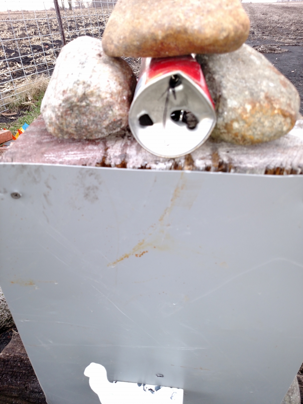

.30 Impact was "loosing it"
12" groups at 123 yards. Found the moderator loose and clipping pellets. Tightened and got 6" groups. Maybe I better clean the barrel. WOW. Black lead wipe patches came out dozens of times. I have been washing all the pellets and drying them and then back into the tin. Thinking now that I have removed the chips as well as the factory lube. Went to a fresh unwashed tin and all is great again
5 shots,123 yards. JSB44gr at 909 FPS,
