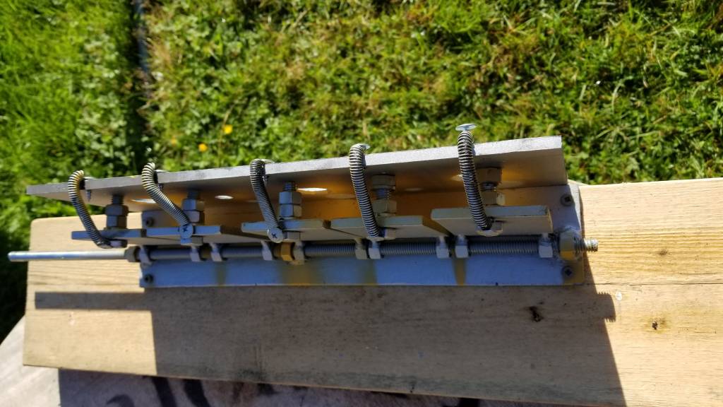

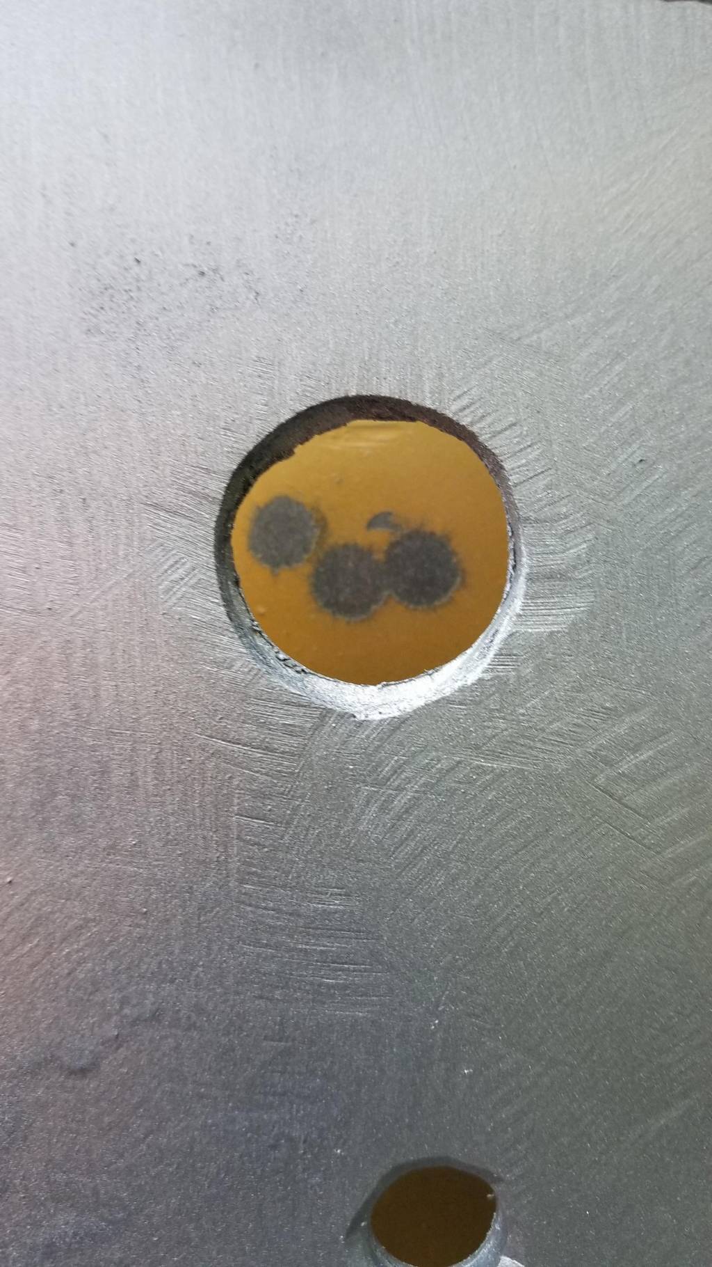

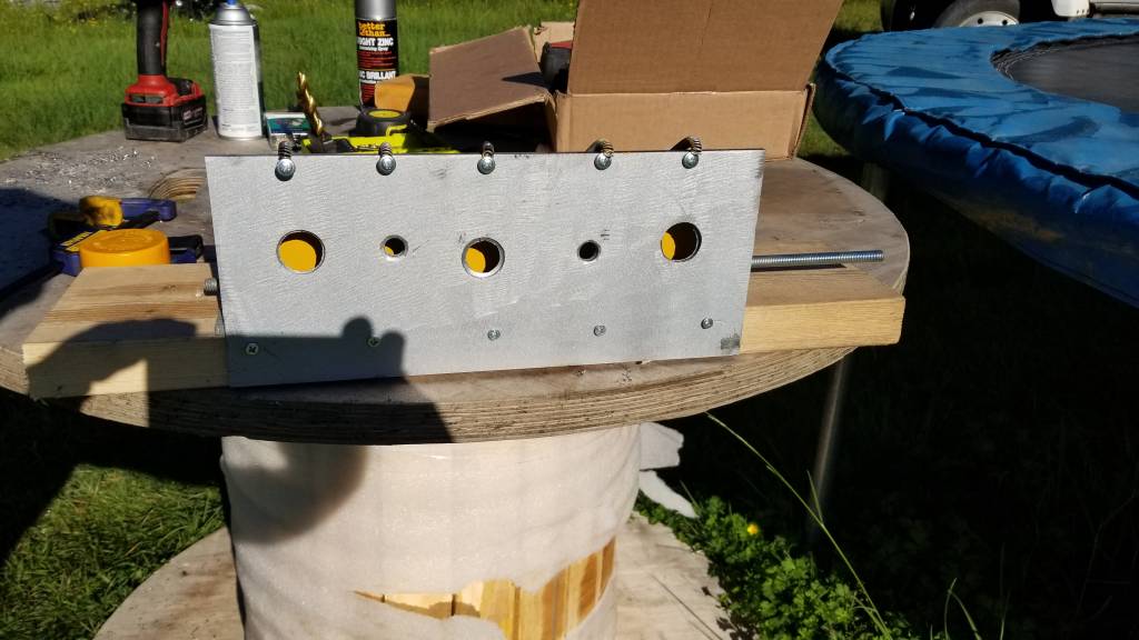

.250 steel plate with holes drilled in it, then nuts welded to a bottom plate. Weld nuts onto 5 paddles that are behind the front plate. Run threaded rod between all the nuts and use springs to bring the paddles back to upright.
Then mount it all to a piece of wood that you can attach to anything.
Can handle 100fpe easily.
