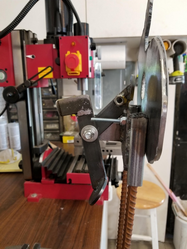

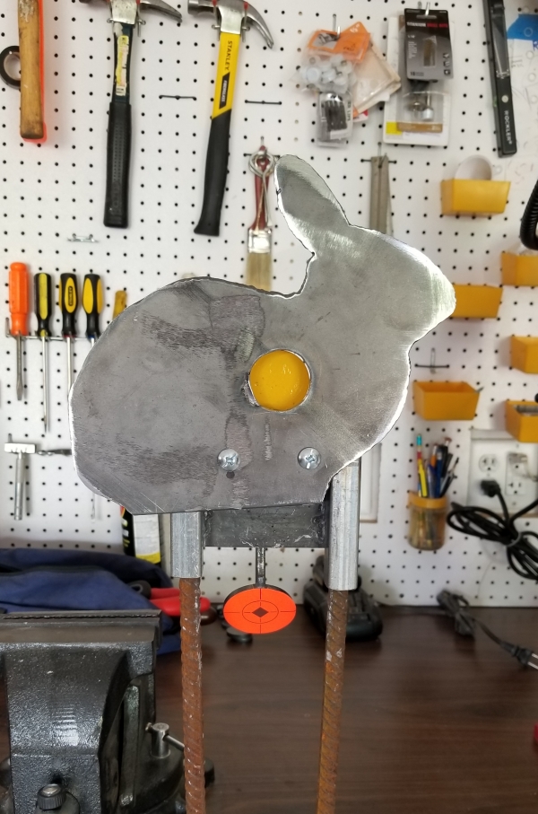

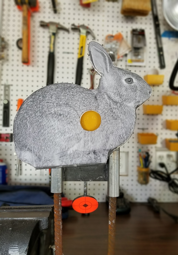

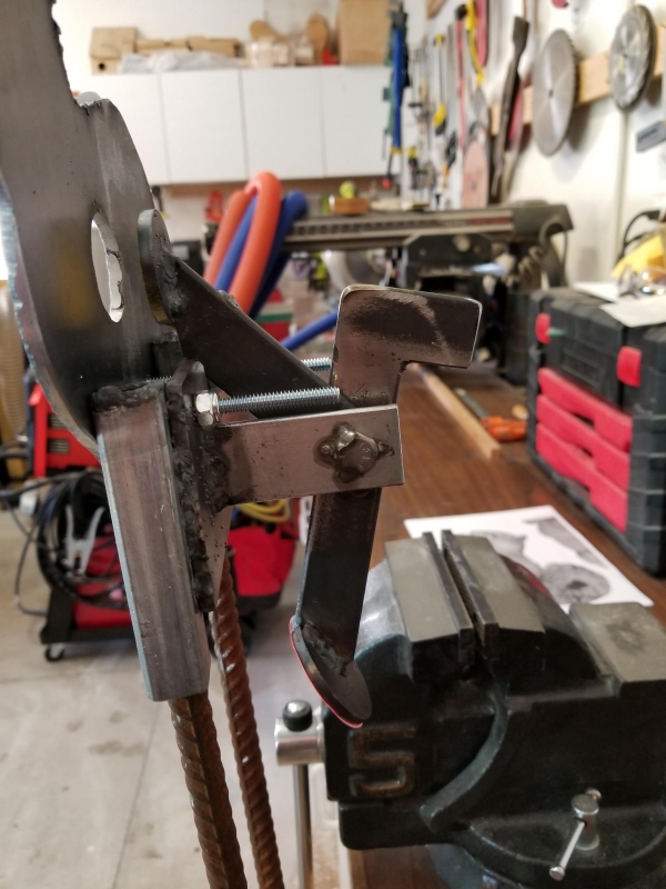

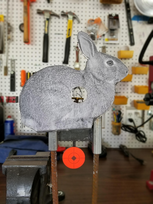

My first attempt at a resetting field target that will handle .30 cal down to.22. The mechanism took a little adjusting to get the right balance to handle the huge change in energy, but it finally panned out. all 3/16 steel. I sized and printed photos for the graphics and then cut the steel with my plasm cutter to match it. then I just use contact adhesive to stick new ones on. I have 4 more cut and ready for. assembly. Jack rabbit, prairie dog, squirel, bird.
