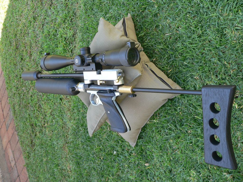

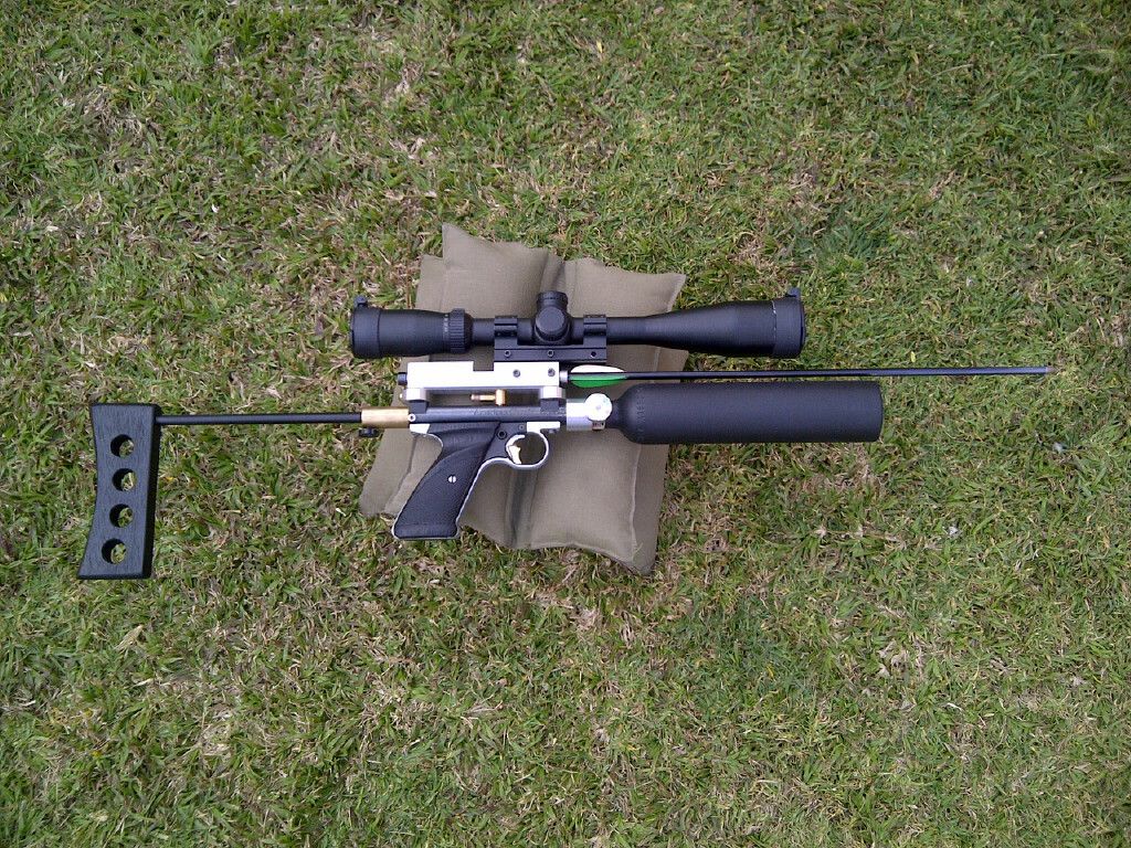

Diy "FX Verminator"
Thanks guys!
Specifications :

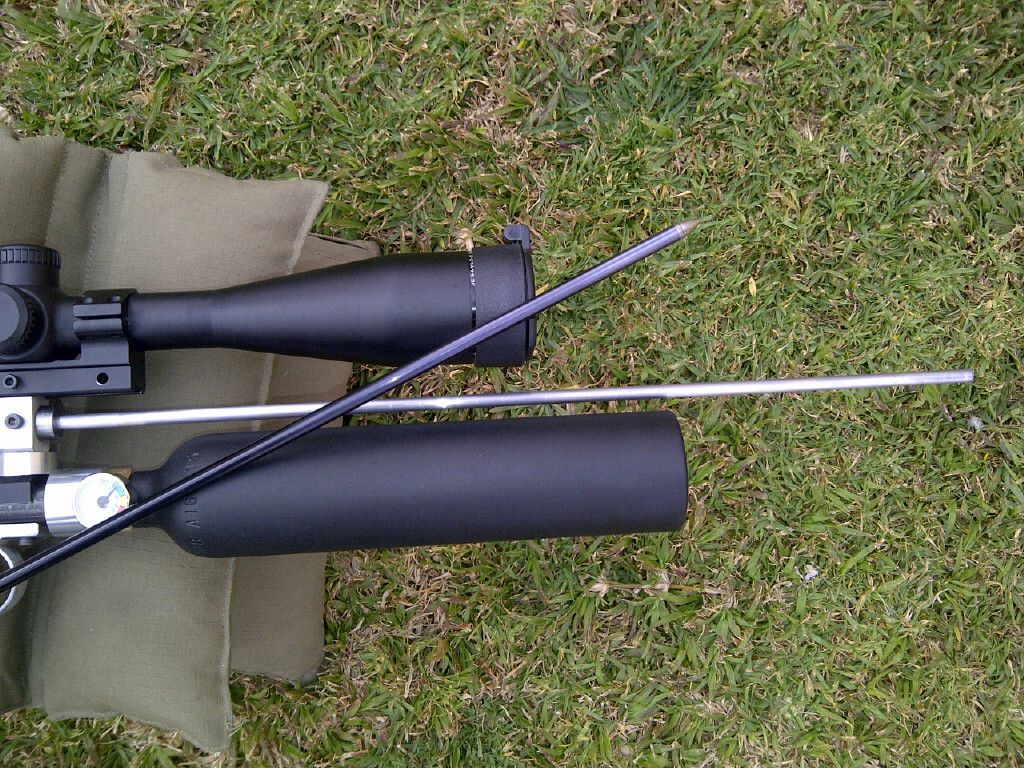

Indexed quick change barrel system... No need to remove the scope and only vertical adjustment on scope to zero for different barrels.
16 inch BSA barrel... Most accurate.
13 and 10 inch Chinese barrels all. 177.
Velocity fully adjustable between 600 fps -1000 fps with 10.34gr pellets using the 16 inch barrel.
At max power with 13.43 gr JSB monsters 910fps 24.7fpe for 15 shots.
It's a low pressure design, only 1800 psi fill pressure not regulated.
Shot count at 920 fps... 10.34gr pellets is 25 within 20fps.
At 800fps about 50 shots.
Trigger pull= 4 oz.
Length with 16inch barrel and ldc =90cm.
Weigh 1.6kg without scope.
2.5kg with Hawke 6-24x44.
