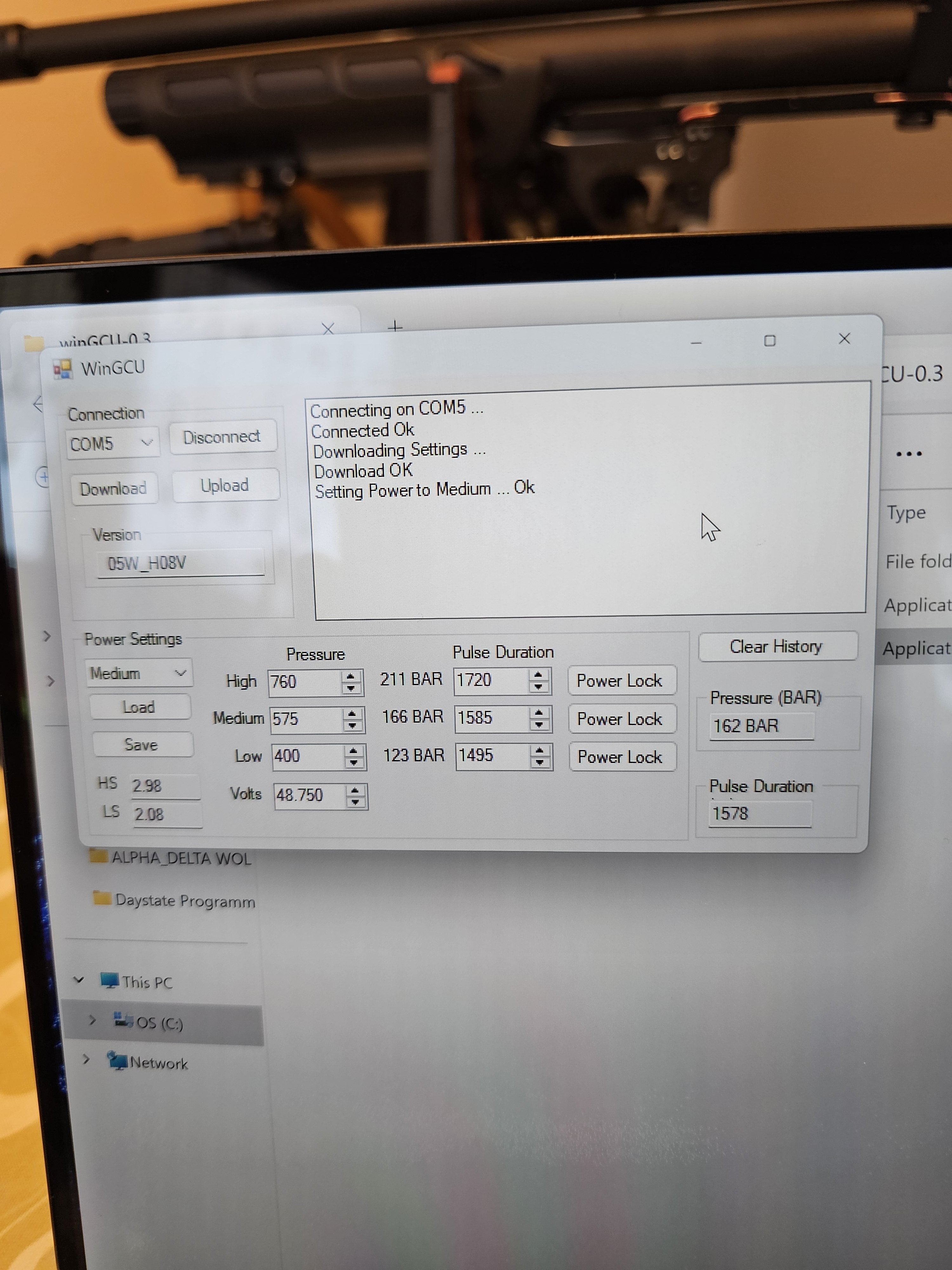

Here's what mine is showing in sub 12

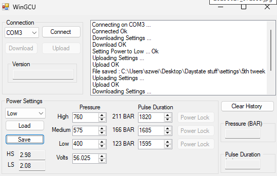

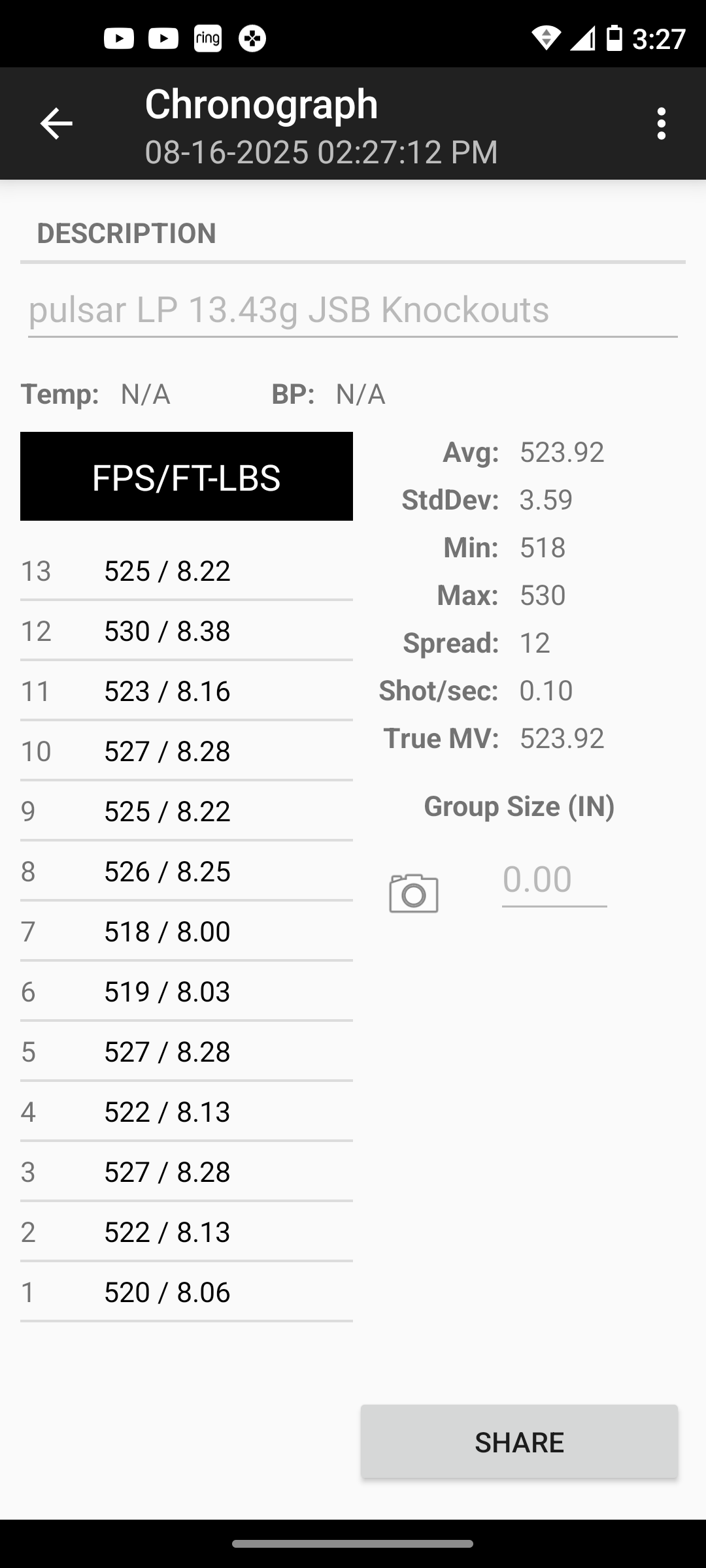

I put in your settings and it wouldn't even push the 13.43g JSB knockouts out of the barrel lol....I do want it low power for just plinking in the backyard, like 7fpe was the goal but here is the settings I ended up with, just over 8fpe. I wander why the huge discrepancy in settings. Do you have the redwolf or the pulsar and actually i thought cpu was the same.
Your volts were 48.75 and I had to increase that to 56.025, the pulse durations I added 100 to each of your settings

I have both. the pulsar is a redwolf in bullpup design the pulsar is 11.3 and the redwolf is 11.2
Didn't understand why I had to increase all the settings compared to you rifle just to get 13.43g to shoot 523fps...higher settings to get a lower velocity. Are your two rifles the same caliber and if so are the settings similar to get the same results? or close to the same results?
