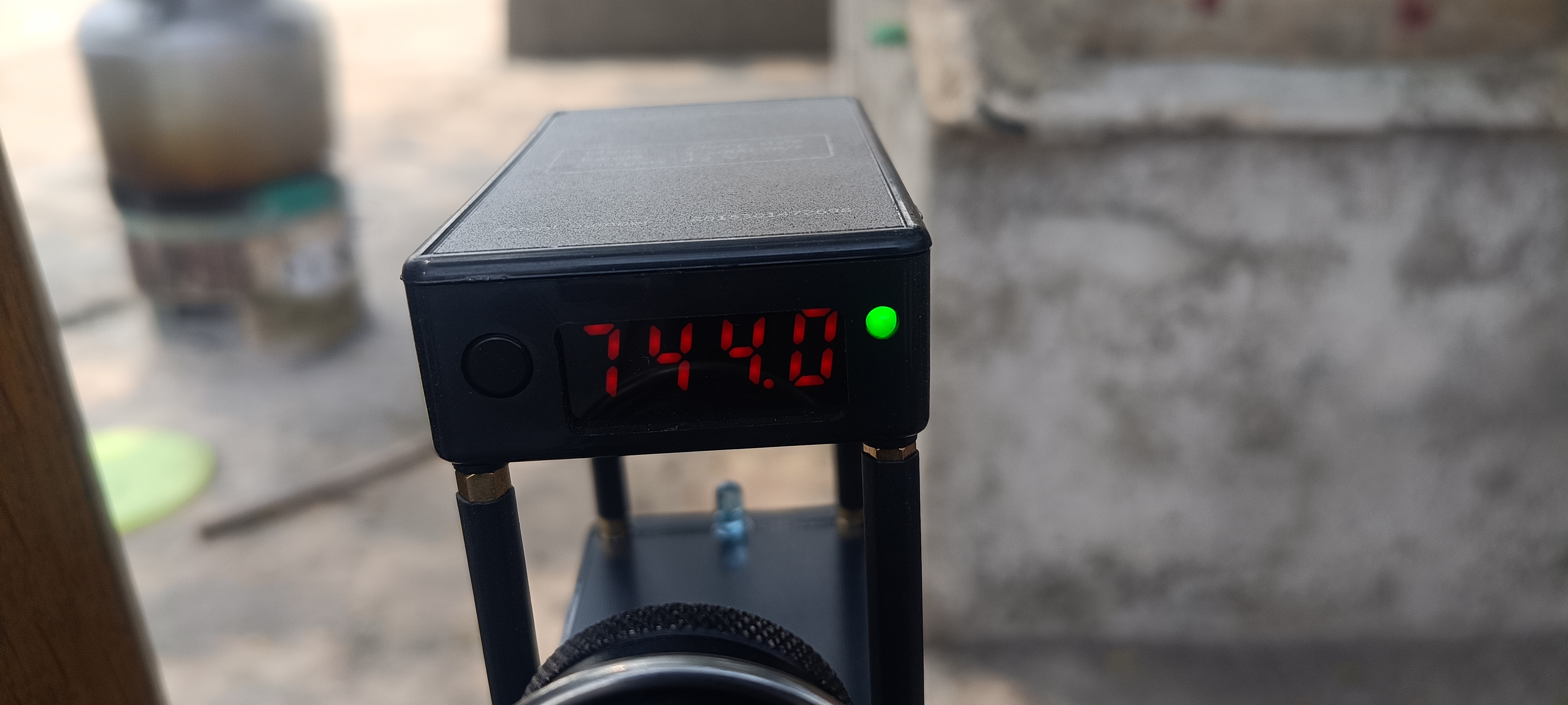

As a side note, I got velocities using cheap Chinese AliExpress Chrono which I find a bit not trust worthy. I also tried calculate (or estimate) the velocity using strelok app using POI drop which gave me nearly 1025-1040 fps.

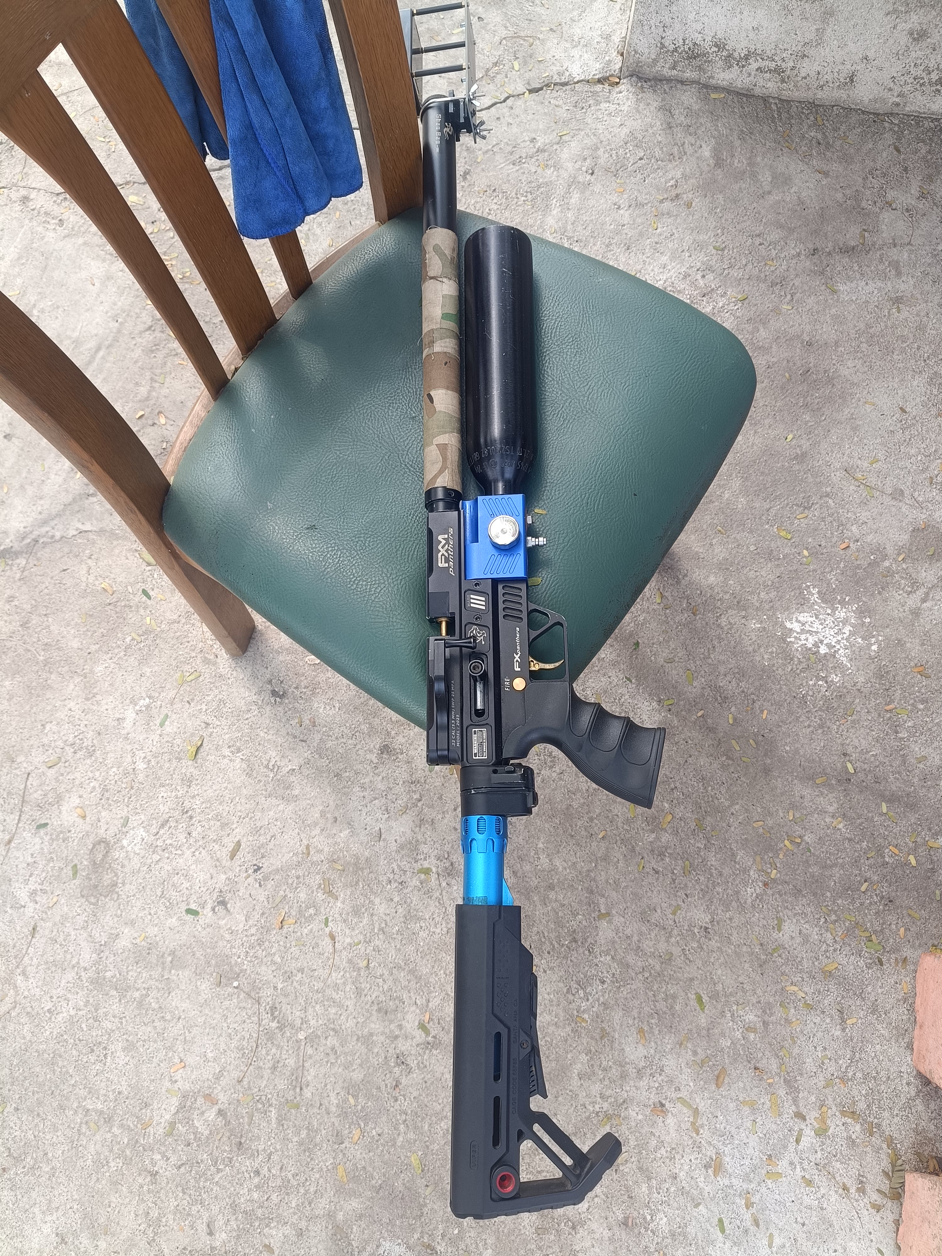

2. My shooter with a shroud and regulator on.

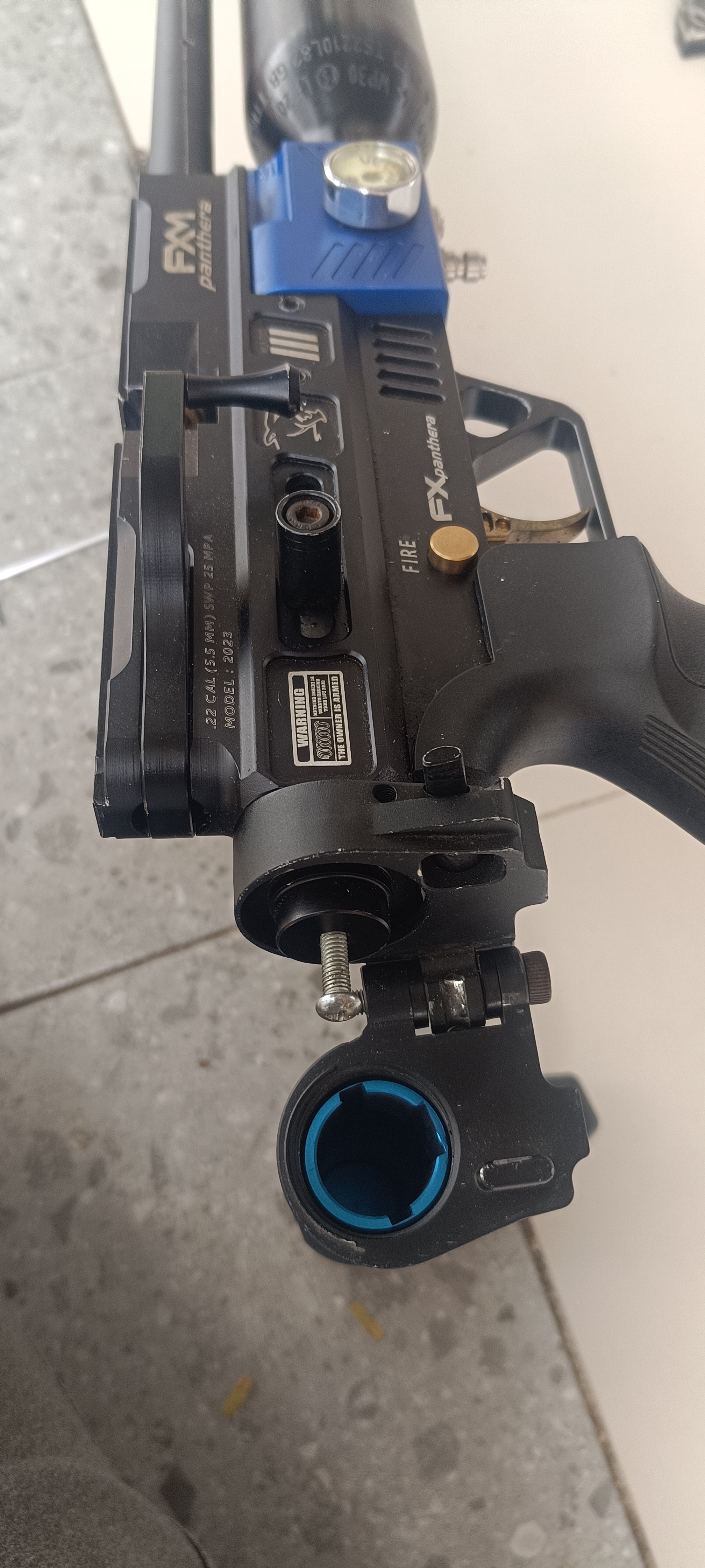

3. My DIY barrel bore

Can you share a picture of the assemble gun? Would be interesting to see how everything is laid out.
Dave
I'll take a picture tomorrow when I disassemble the gun to try out Long_Gun_Dallas's advices. You'll see a frankenstein of a gun for sure. LOL

I did my tests this morning and came out failed happily. Changed to bigger port, removed the spring behind valve stem, set set point around 130 bar and installed short stiff spring that would reach its uncompressed length before the hammer hitting the valve. There was no change or rather a little bit decrease in velocity. The velocity maxed out at 750 fps with hammer adjusting screw fully screwed in and at 2000 psi set point with the hammer having a free moving distance of around 5-8 mm between the spring and the valve which I assume would not be bouncing around. But the thing that made me happy is now my gun also have that snap sound that I love. A lot quieter than before. Now I tuned it according to the 95% rule like everyone did. The velocity is now at 710-715 fps at around 20 ft-lb of energy which is way higher than some countries legal limit on airgun power. But as a hobby hunter, I'm looking forward to getting able to shoot high grain slugs at a velocity of around 850-950 fps which I assume would bag me some barking deer or a medium sized hog with my gun. For dog looked like wild animal (Coyote??? But doesn't look like one) which is a problem around my area, I've got a few down with my set up before. So, I'm gonna just continue finding more ways to get more power (e.g custom power plenum with adjustable volume??) if it's needed for an 13 inches barrel😅😅. Anyhow, thanks for the advices @Long_Gun_Dallas.
I've attached some photos and videos of my gun for you, Dave.
And a group of five shots at 25 meters with the gun clamped in.

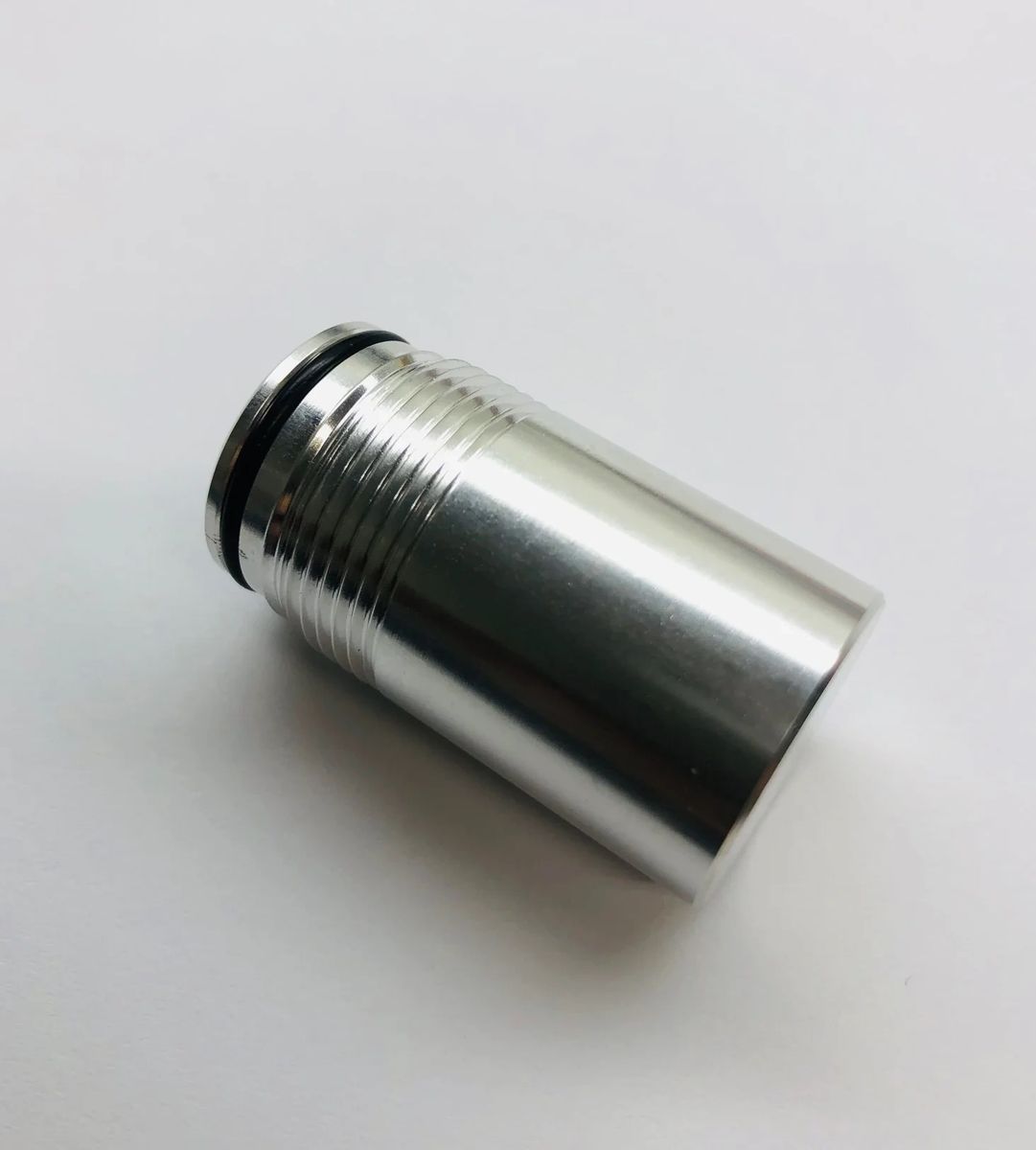

Yes. I think the plug can be replaced with some kind of small plenum there. The problem is getting the thread size and O-ring fitted nicely. And have to study more into the bore volume and plenum sizes because with the plenum volume only mainly acting as chamber for usable air before the pellet leaves the barrel, my 13 inches barrel would benefit from it or not. If not, I would be spending more air or money on a part that's not necessary.
A larger plenum like this 10cc will definitely help your new FX Panthera.
Thanks for the advice, heavy_impact. So, 10cc is as per most post I've read would be 10fpe increase theoretically. Just need to figure out a way to measure thread sizes or a visit to lathe shop. I tried CNC router threading with a CNC I assembled out of plywood but didn't worked out well. And it's not FX panthera. It's just made in Thailand FXN panthera. LOL. I don't want FX to come knocking on my door out of copyright stuffs. Gotta give it new name with a laser engraver I think.

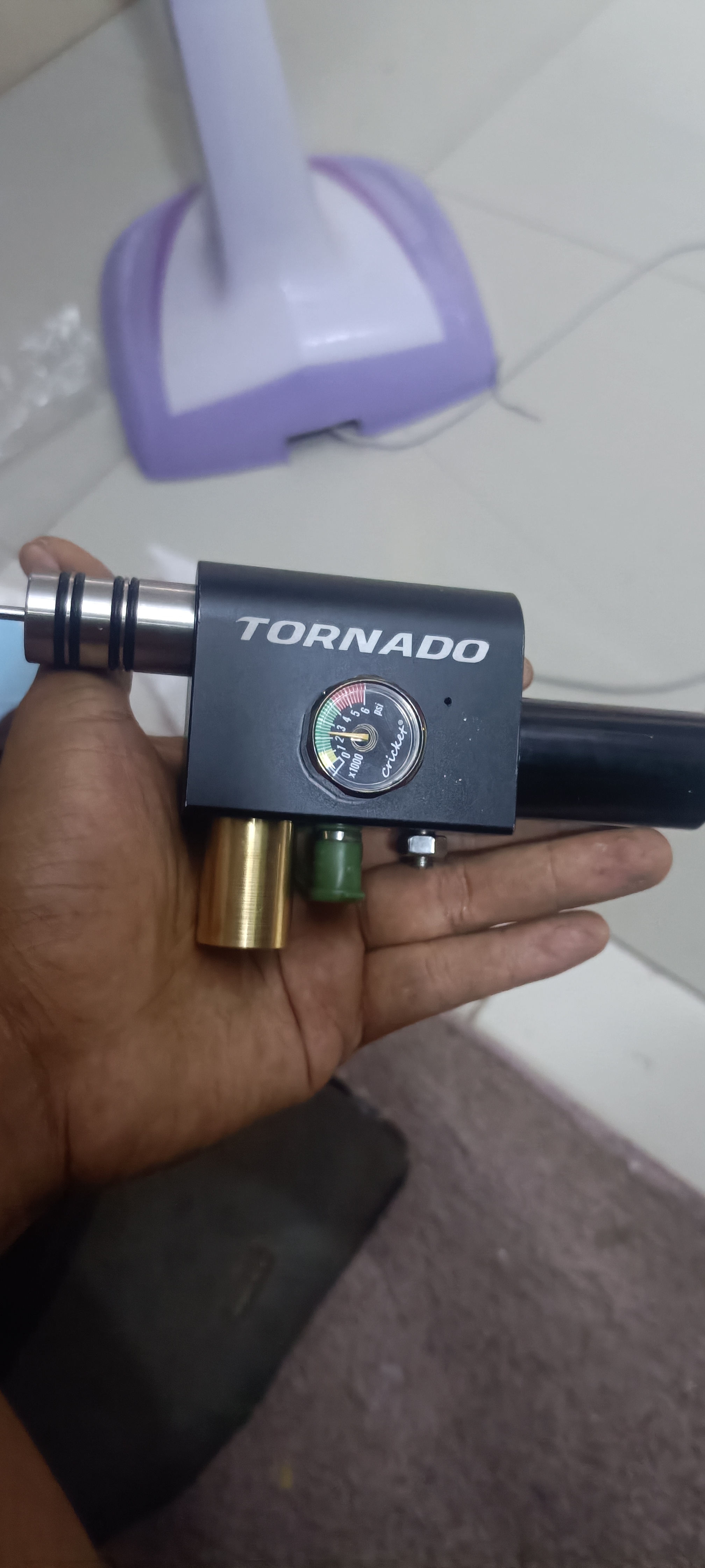

Today, I tried to make sort of like a plenum using a co2 coupler with G1/2-14 thread on one size and m18 thread on the other. Used a tiny end cap thingy that came with the valve I have on the m18 side and the G1/2-14 thread on the coupler fit into the valve nice and tight. I don't know how much cc I got from that make shift plenum. But the gun now shoots 840-850 fps max with 18 grain pellets. That's 6-7 fpe increased. So, my plenum should be around 6-7 cc theoretically. Had to stop more tweaking the gun because I ran out of pellets. Have to order them 4-5 x500 pellet cans along with 22-25 grain slugs too. My wallet hurts with current prices but gotta bare with it until I could forget all about airguns.

Got a new Z valve from Huben today. Ordered the one that came with a power plenum. Problem is that the fill probe is too close to the plenum and the coupler from my yong Heng cannot fit. But was able to find a temporary fix and now it's working great. The power didn't change significantly as I assume the plenum volume is close to my diy one. But the factory one looks nicer and smaller. The best thing about the valve is that it came with a lot of other hard to find O-rings that I'm looking for a long time.
