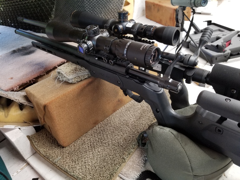

Here is my Discovery HD 4-24x50 (34mm tube) FFP on my .223. I find the HD glass very clear, it tracks very well and it is very bright. For precision shooting 100-250m, I prefer nothing less than the HD glass. You will notice when you go from HD glass to one that is lower quality. It will feel like someone smeared grease on your lens and will not want to use that scope especially at longer ranges. For the price, it is hard to beat Discovery scopes.
