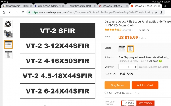

On another note, some are not sure what the big wheel fits on, here is a couple of pictures of what the big wheel fits on.

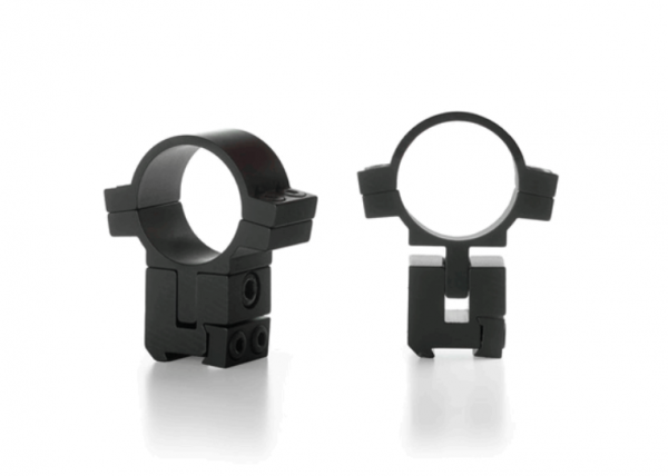

I have heard of this previously from other posts but to be honest they were about different scopes as well. Try reversing the order of the ring (Back to front) else shimming or something like FX No Limit Rings to solve the issue. I hear what you are saying about the Discovery appears to be low out of the box and I got that but if the scope is at the end of it adjustment that is not a good place to leave anyway.

Sorry for the delayed response. Typically the first thing I will suggest to a person that is describing a scenario where they are running out of adjustment is to swap the ring order (back to front) and try again. Normally the adjustment limit will still be realized but occasionally there will be a shift which indicates ring inconsistency. The goal is to keep our adjustment tube within the scope as close to center as possible but unless there are adjustable mounts installed, shimming is the next best solution. I agree 100% with your assessment, Discovery as a scope manufacturer, a manufacturer of hundreds of thousands of parts mind you, will make mistakes but it is guys like Charlie that help reallocate the inconvenience and bad experience back to Discovery so it can be corrected.
