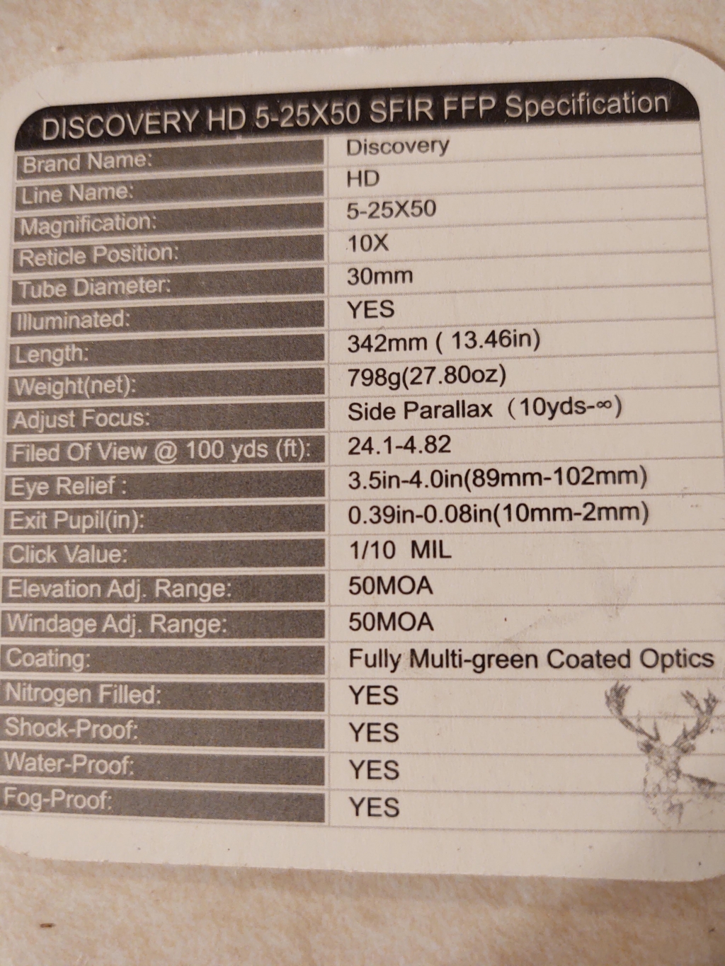

Thanks for that, Jim! 👍🏼
50 moa max. elevation adjustment for a 30mm tubed 5-25x scope is kind of average, on my scope lists most have 50 or 60 moa, with some 70 and 80's.
The 4-24x and 5-30x have a wider magnification range than 6-24/5-25x — so they should be worse — but in fact they are mostly better: 70's to 110 moa(!) (with a couple low 40 and 50 moa, on the lower price class).

❌ Ooooops...! 😟
Just looked at a couple different websites for Jim's HD 5-25x50.... — 'cause that's a close contender.
Look at this ridiculous inconsistency...!
▪"20MIL" = 70MOA, at Discovery's UK site, here:
https://discoveryoptics.co.uk/hd-second-focal-plane/hd-5-25x50-sfir-sfp/
▪"60MOA," at Discovery's direct sales webpage, here:
https://store.discovery-optics.com/products/discovery-hd-5-25x50-sfir-dltw-sfp-ir-mil-tactical-optics-riflescope-shooting-and-hunting-rifle-scope-with-illumination
▪"50MOA," on the specs card that shipped with the Discovery scope (thanks, Jim), here:
https://www.airgunnation.com/topic/discovery-hd-34-4-24x50-elevation-adjustment-what-40moa-58moa-85moa/#post-699075
Wow, I really would like to trust manufacturers when they state objective, verifiable data —
or at least, I'd like them to lie consistently to me, or something... 😖
