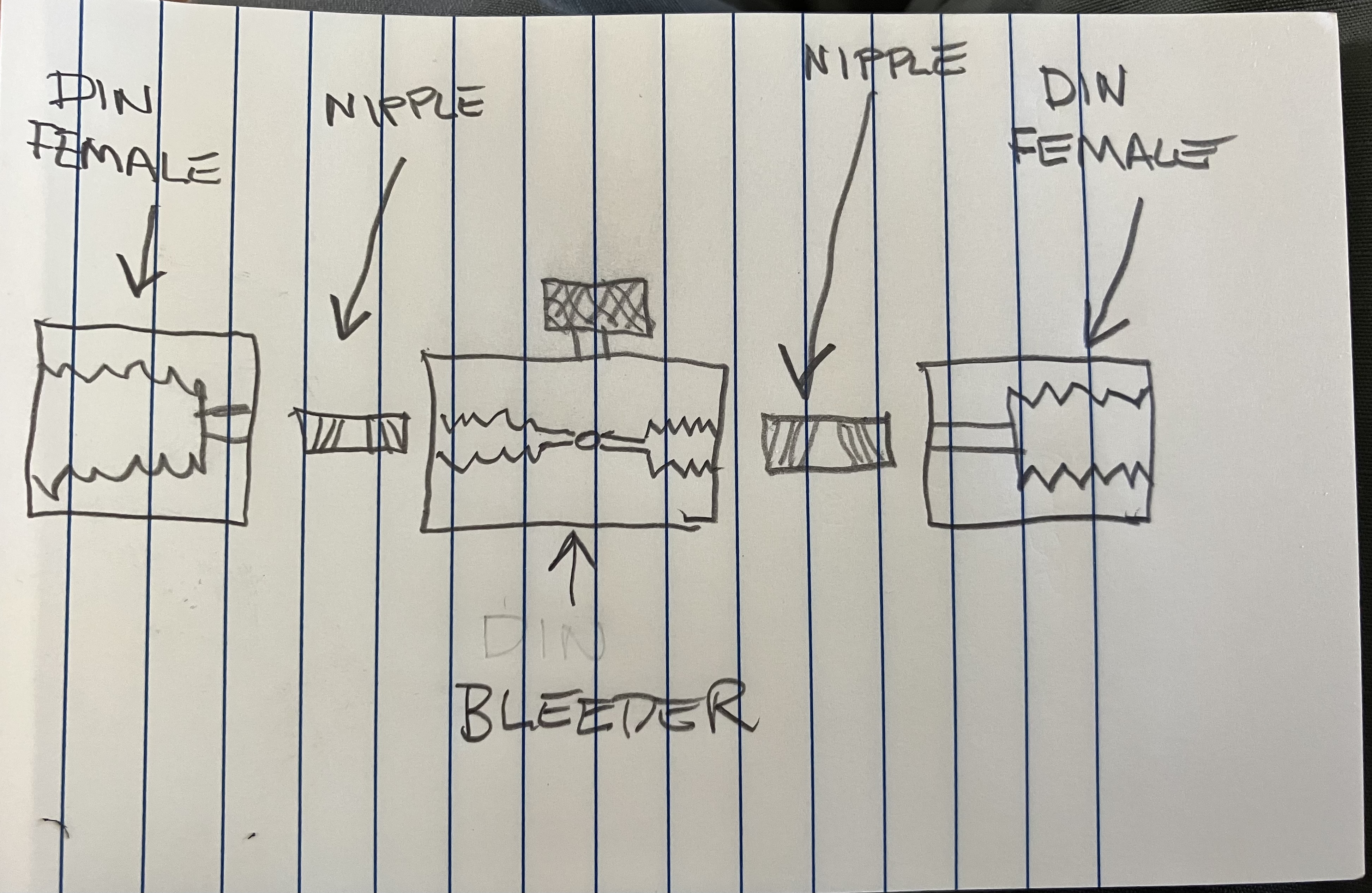

DIN Female to SCUBA DIN Female-Need a DIN NIPPLE
Here I sit, normally I would just install a short NPT Nipple and be done. But, I have no idea where to find the correct nipple to mate two Female DIN pieces. Of course, I would like to locate a bleeder valve to place in the 1/8 hose lines to allow slow depressurization.

Is this what you are trying to do ?
Reactions: HajjitheDoberman
YES, EXACTLY.

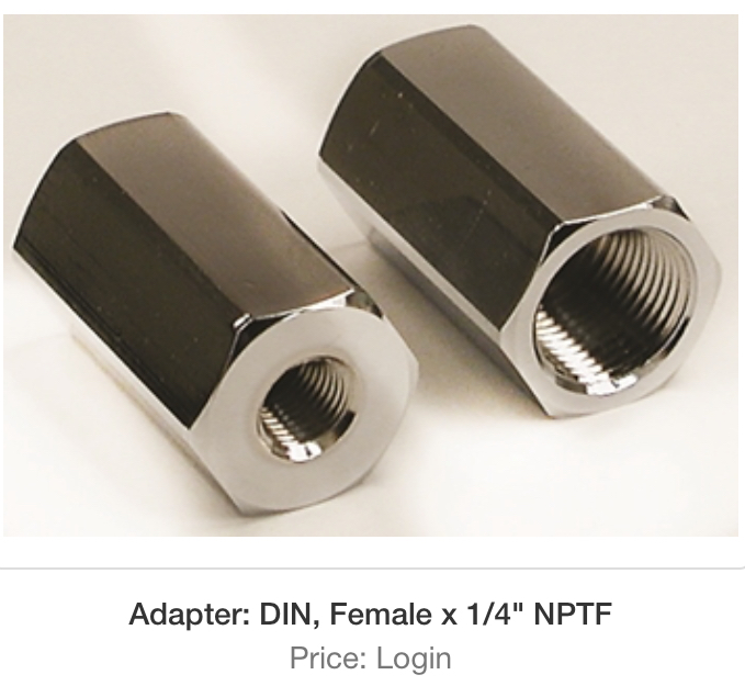

Here are actual pictures of manufactured fittings. I found them by cruising the web. Those are all fittings used in the scuba world. I would check Air Tanks For Sale. The DIN female to 1/4npt female that I located was a wholesale only for dive shops called Globsl Scuba. If you have a dive shop near you they may be able to order them for you as well. You’re probably looking at around a hundred dollars for those fittings, but if it does what you want, I guess it’s worth it. Good luck.

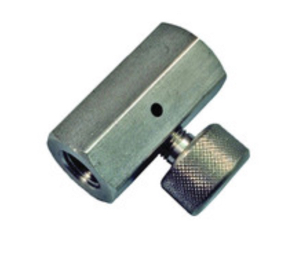

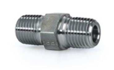

There is a HP air vendor in Reynoldsburg, Ohio called Breathing Air Systems that carries the bleeder and nipples and the DIN fitting. BUT, their fitting is $195 each. You can order direct from them but I would search around for the DIN piece elsewhere. Some scuba places have the DIN female available as oxygen clean, you don’t need it oxygen clean for air gun use.
