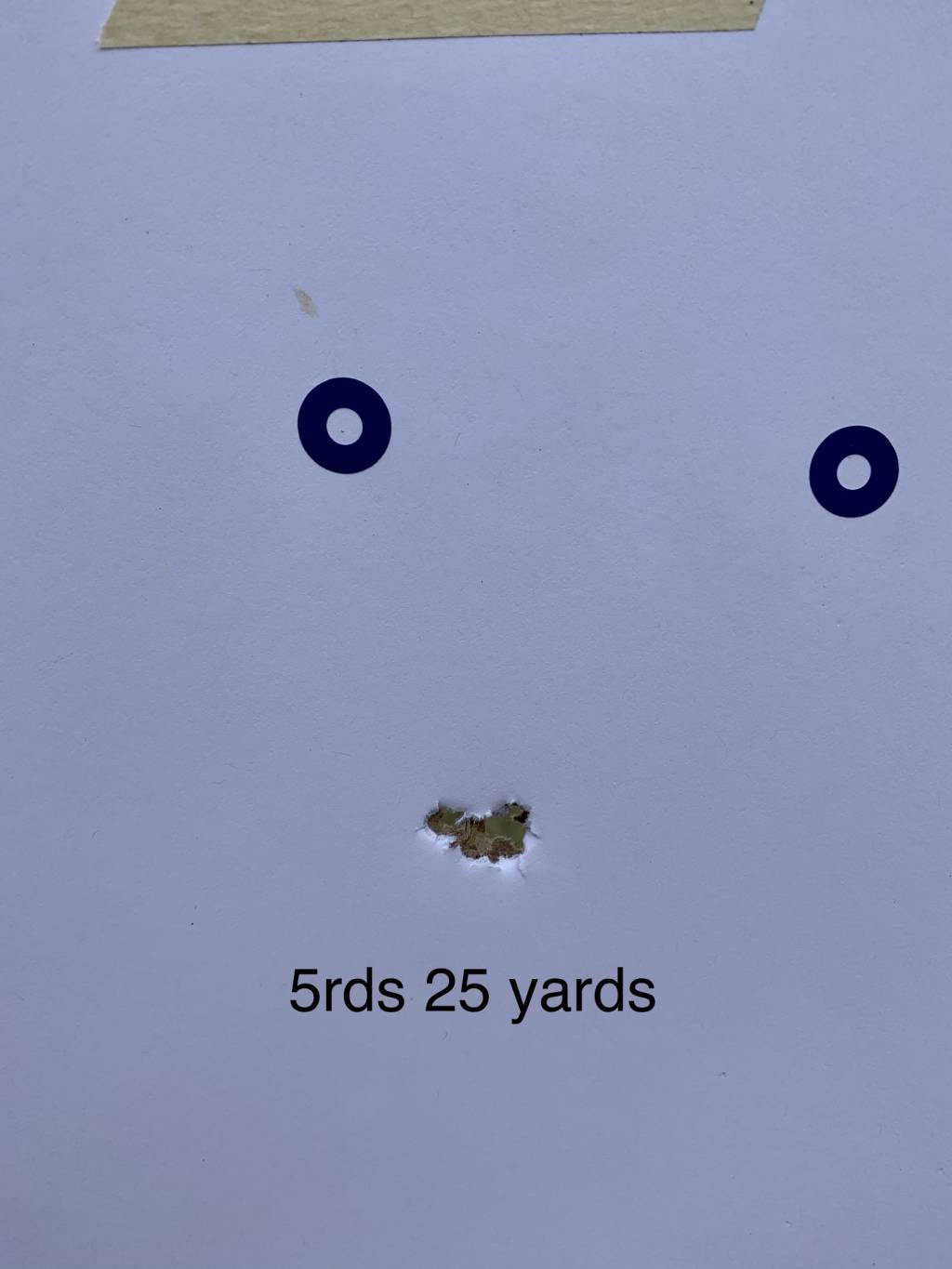

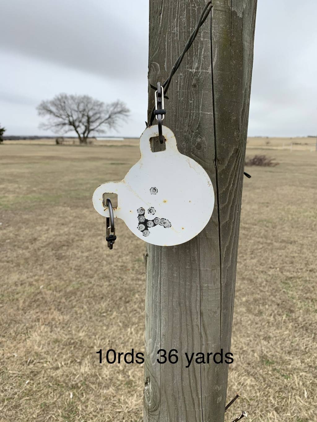

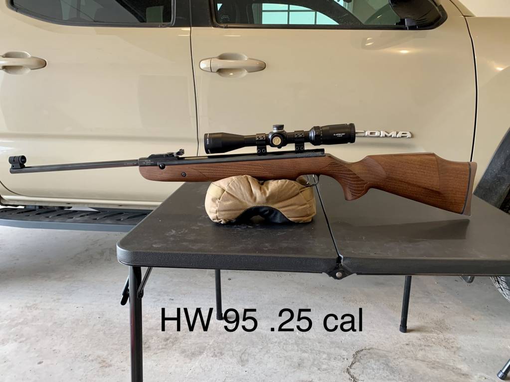

My HW 95 in .25 came in today. Had 7 different types of pellets to try but it only liked one out of these and it shoots them pretty good. Predator GTO 16.54gr are the ticket so far. Got some more coming in to try out but I’ll be happy shooting the Predators.
