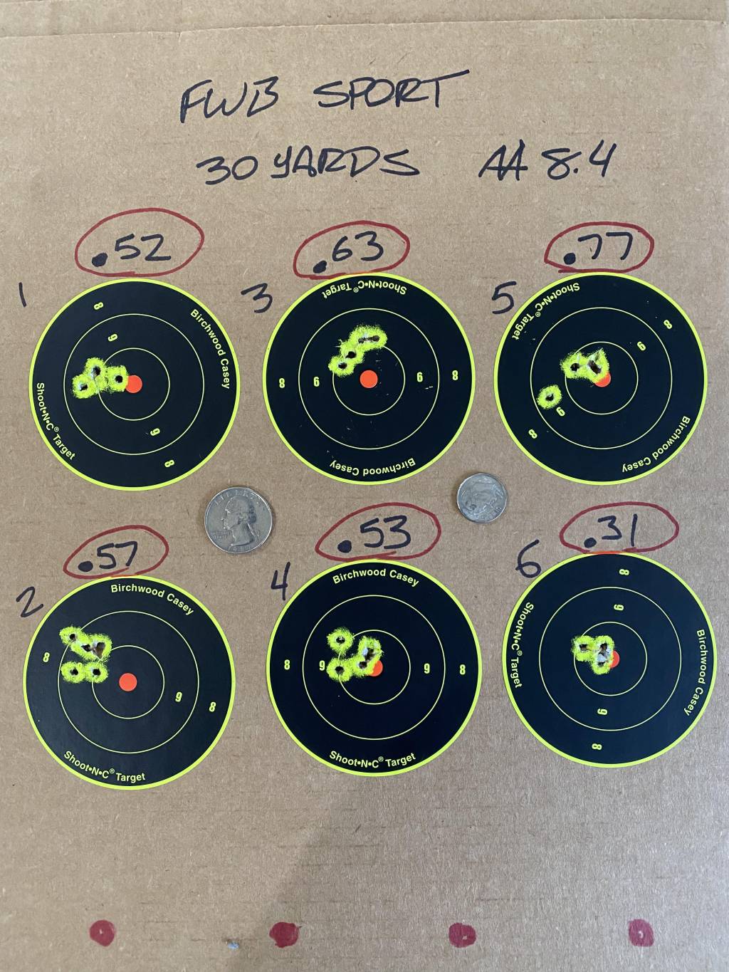

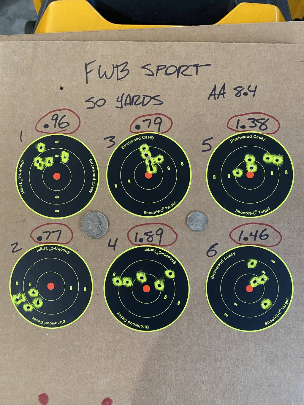

At 30 yards it was less noticeable, groups 1, 2, and 3 were a traditional artillery hold. Groups 4, 5, and 6 were tight. On group 5 I totally pulled shot number 4. The other 4 pellets measured .28”. Pushed out to 50 yards and things were more clear. Groups 1, 2, and 3 were held tight and all 3 under an inch. 4,5,6 was artillery and the groups opened up dramatically.

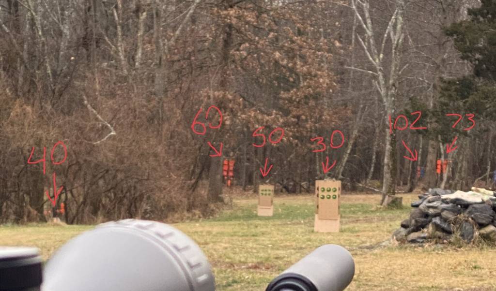

I can't comment on the gun other than to say I still want one to toy around with but your experience with it seems to be the general consensus. What I can comment on is that range of yours. That is fantastic! Is that a home setup?

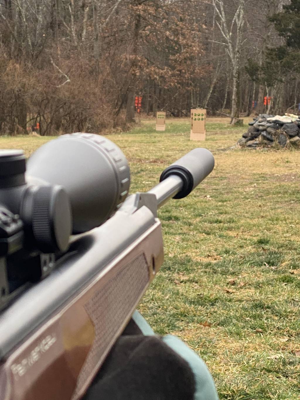

It’s my home range. A few targets out of the picture are at 25, 47, and 95 yards.
