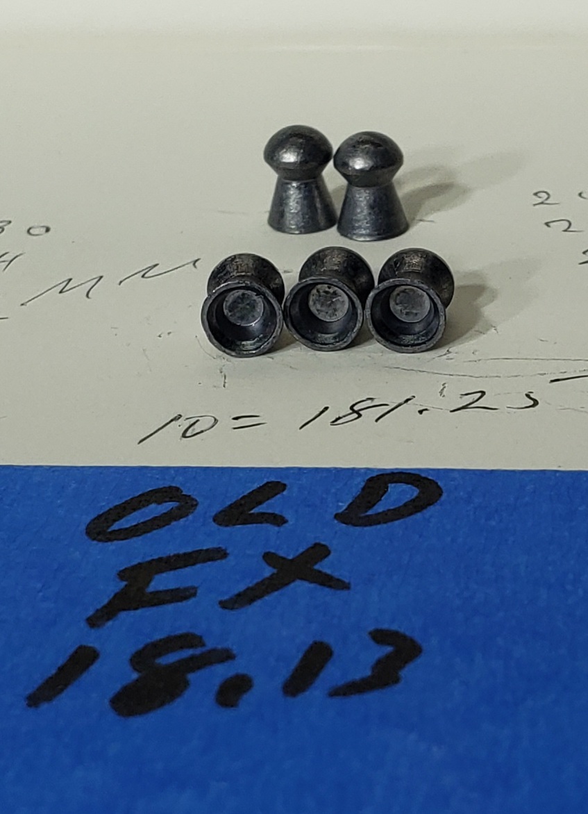

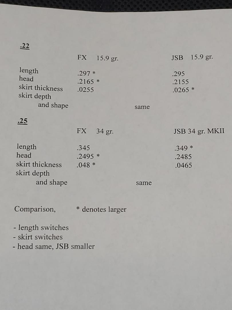

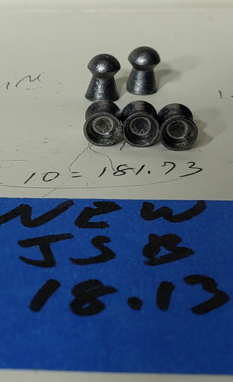

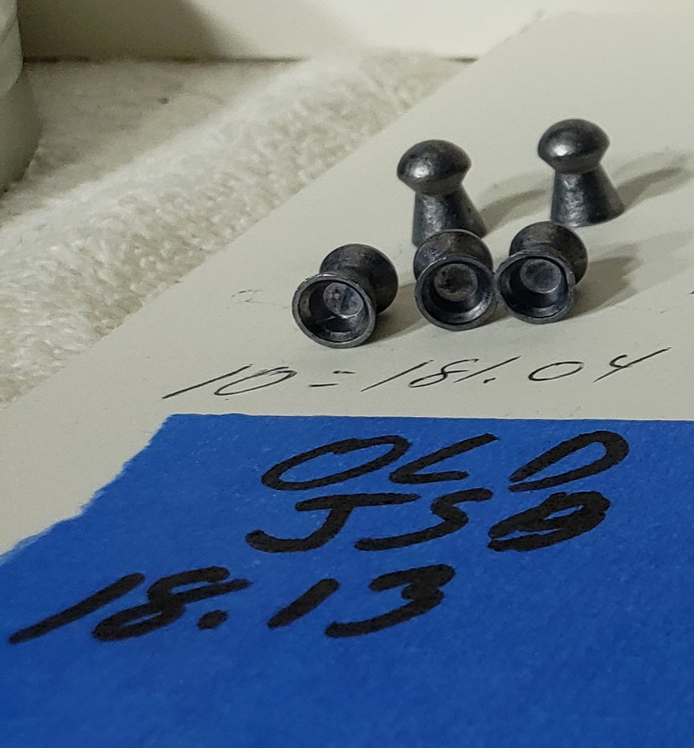

The difference in quality is noticeable not only in the amount of deformity of the pellet skirts but also the internal shape of the skirt.
Weather permitting, I'll post two groups, each shot from the same gun, same conditions , same magazine, same bar in vessel, of the two 18.1 gr. pellets.. The group sizes will be noticeable different. Both groups are reasonable, one is better. You decide, which group belongs to which pellet.

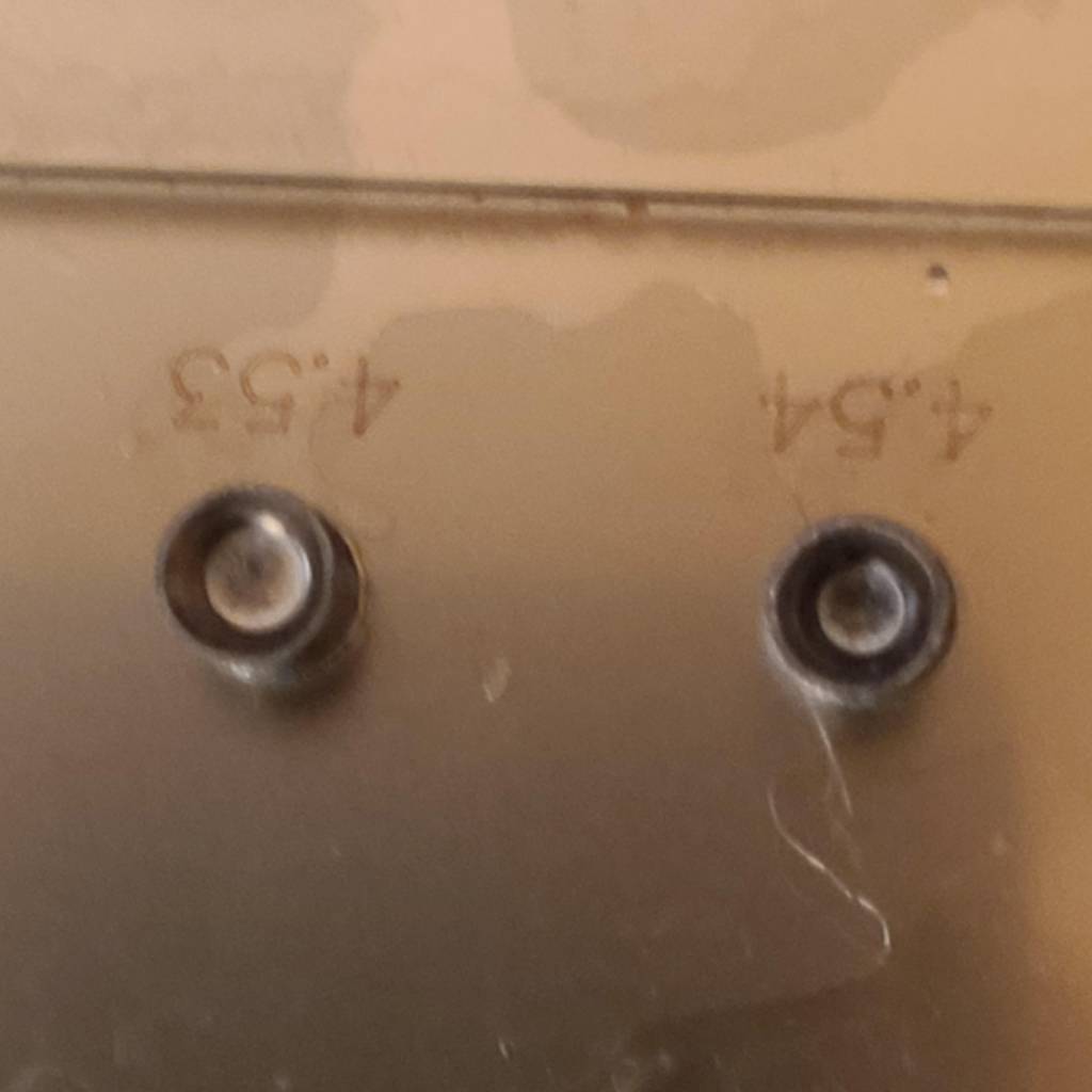

Sharing a recent experience, I weight sorted ten tins Air Arms Fields 16 gr'ers for my HW100 SK. They tended to lump up on a handful of weights for the most part, so got fatter tins of those weights. The sorts of Jumbos made previously tended to distribute more normally. Also, the number of non-modal head sizes, and their count, was faaaar fewer than the Jumbos, pelletgaged at "5.56mm".
