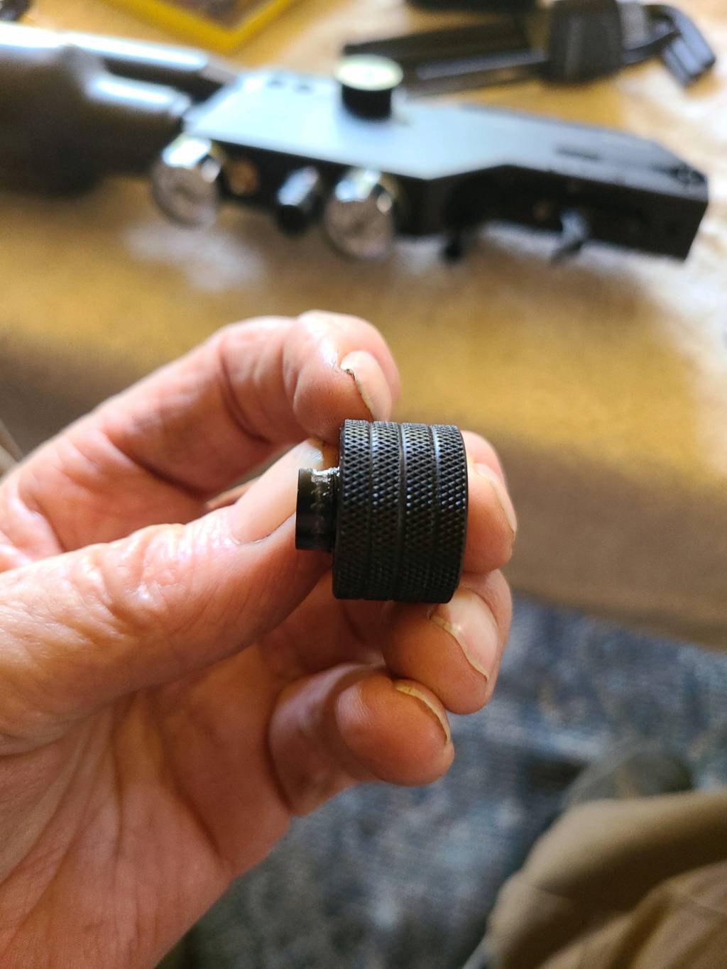

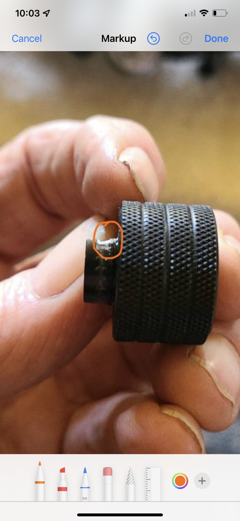

Recently, during several shooting sessions, I started noticing a change in my STD while shooting JSB 24.54 Kings, so l cleaned the barrel and started some shot string testing. Sure as the sun comes up, the shot strings showed a slight inconsistency in the normal STD. So I opener her up and found this, the edge of the power wheel at position 24 was chipped out. See picture below, you might have to enlarge it to see it better.
I believe it was cause due to the internal locking 1.5 mm allen screw that holds the pretension adjustment screw boss had came out and fell on the table. No fault to fx, I might have forgotten to snug it up after cleaning the hammer.

So I would get it replace under warranty, the soft aluminum gets chewed up by the hammer spring preload pin which is steel!
while you get a new one from FX you need to reach out to @Mrshosted via PM and get one of his HS power wheel with steel preload interface. It’s a must especially shooting with higher HS level. Yours is really chewed up!
https://www.airgunnation.com/topic/new-montster-crown-power-wheel-is-next-level/
Both of my Crowns and Impact have the steel HS wheel while I’m still waiting for him make one for my Dreamline. @Mrshosted, can you please hurry it up? I’m not getting any younger! LOL!

My maverick did something very similar, fx called it a wear item and wouldn’t warranty it. They did warranty the screw that chewed it up though, since they came out with an updated version to fix this. It only took 3 tries to get the correct cap head screw. They kept sending me the old style that chews up the power wheel that wasn’t covered under warranty. I thought it should have all been covered.
Honestly I would want the 1-24 power wheel and then get one of the tougher aftermarket ones
